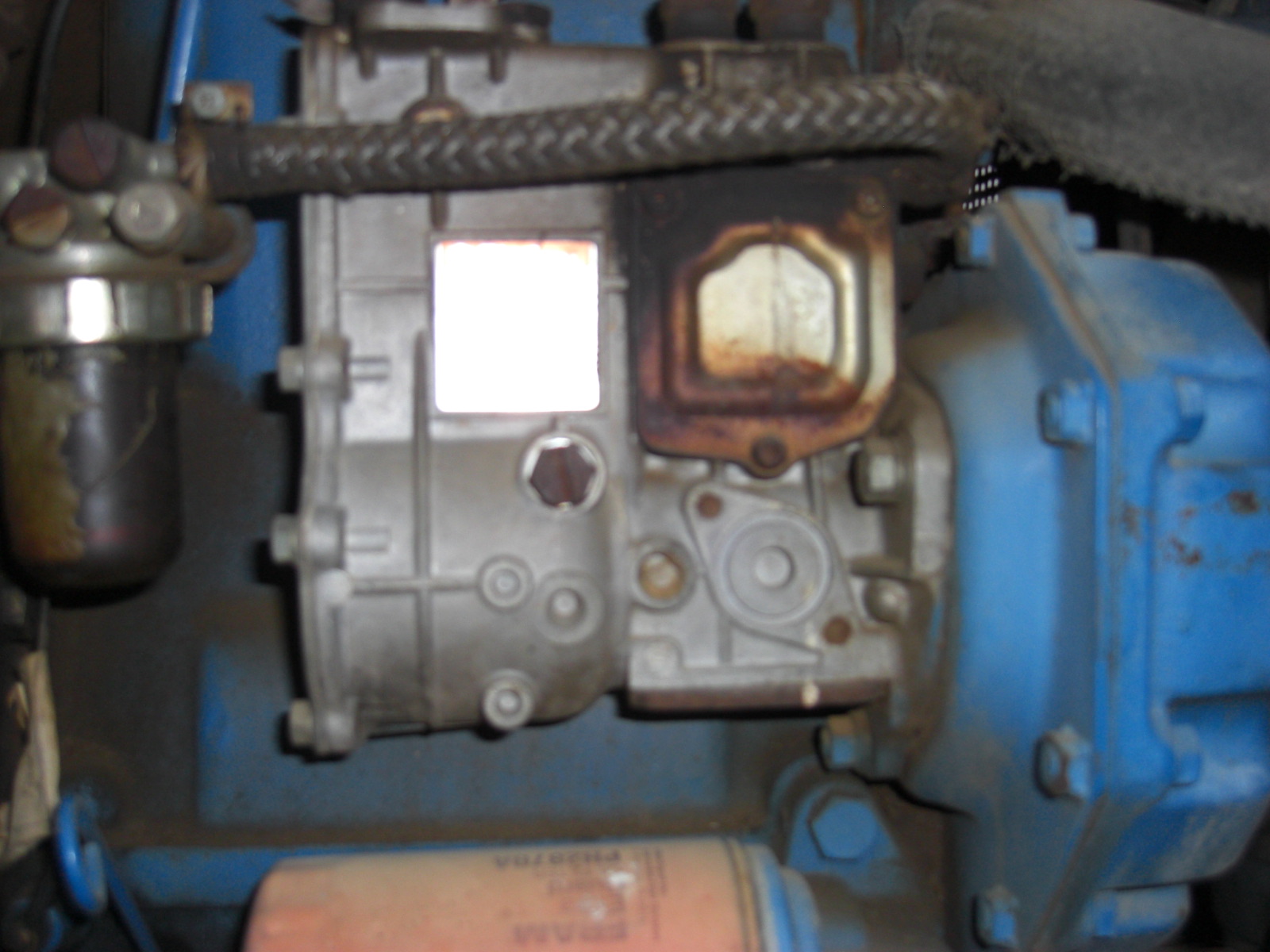

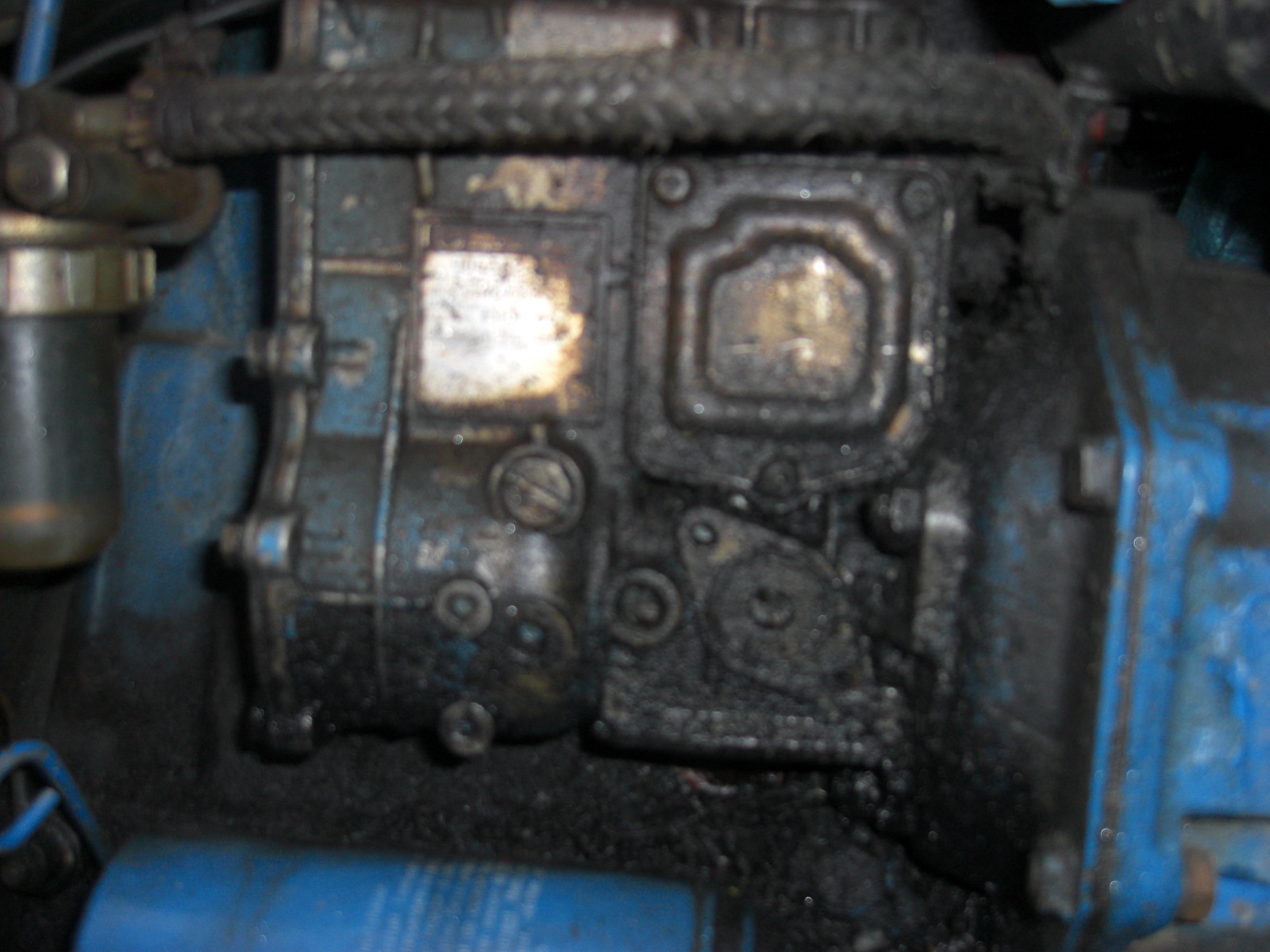

here are pictures of the ford 1500 (dirty on the left)and ford 1700 (clean one on the right) injector pumps.
   / Ford 1500/1700 injector pump #13
Hmmm, neither one have the fill and drain plugs like JC's and mine. Do you know what year model they happen to be? I would at least add the reccomended amount of oil through the vent at the top until you figure out why those plugs are not there.
   / Ford 1500/1700 injector pump #14
That's pretty strange but I'm sure there is a good reason behind it that we don't know. There is another slotted bolt above the level and drain point that I don't know what the function of it is. I see sign of screwdriver use on it and previous owner monkeyed with a bit but I could not locate it or it's function on pump diagram. I think it bleeds the air from fuel passage same as the air bleed hole you have on top just below two discharge pipe connection. All I can say may be there is an overflow pipe from the opposite side of the pump that is plumbed in to engine block taking overflow oil to crankcase. If that is the case by simply filling it from the top over flow will take the extra oil back to crankcase. in that case you can add new oil right over the old rather than replacing old oil.

i don't see anything that stands out as being an overflow hose. can someone post a picture to show me where to look.
   / Ford 1500/1700 injector pump #17
Its probably not there then. We cant tell by looking at your two pictures, do your pumps have a vent at the top like the pictures JC posted? Maybe take a few more pictures of yours showing the whole pump assembly, your pics are cut off at the top and are blurry. When the pump is mounted, there is not alot of room behind the pump, if there was a hose it would have to be either on the top of the pump or the front. Thanks, TB
