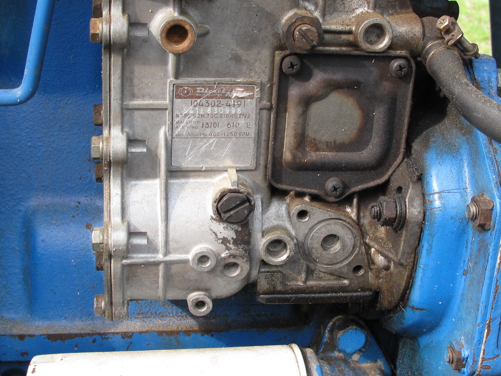

Hey all, I also have a Ford 1500 and there are no drain or level holes. The manual evens says they are suppose to be there but mine looks just like the original posters.....
Last time I changed my crankcase oil, I just fill the injector pump up to the top. I don't know how it was done before I got it as that was the first time I had filled it. This was last fall and I have had no problems in the last 50 hours of run time...
I have not been able to find any documents or advice on why this is.... My model is a 1981 4wd....
Anyway I am very interested if any information on this comes up!
Tim

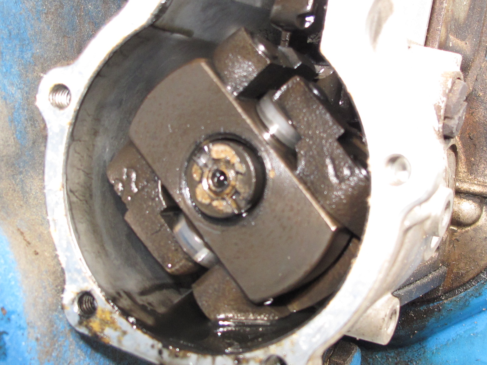

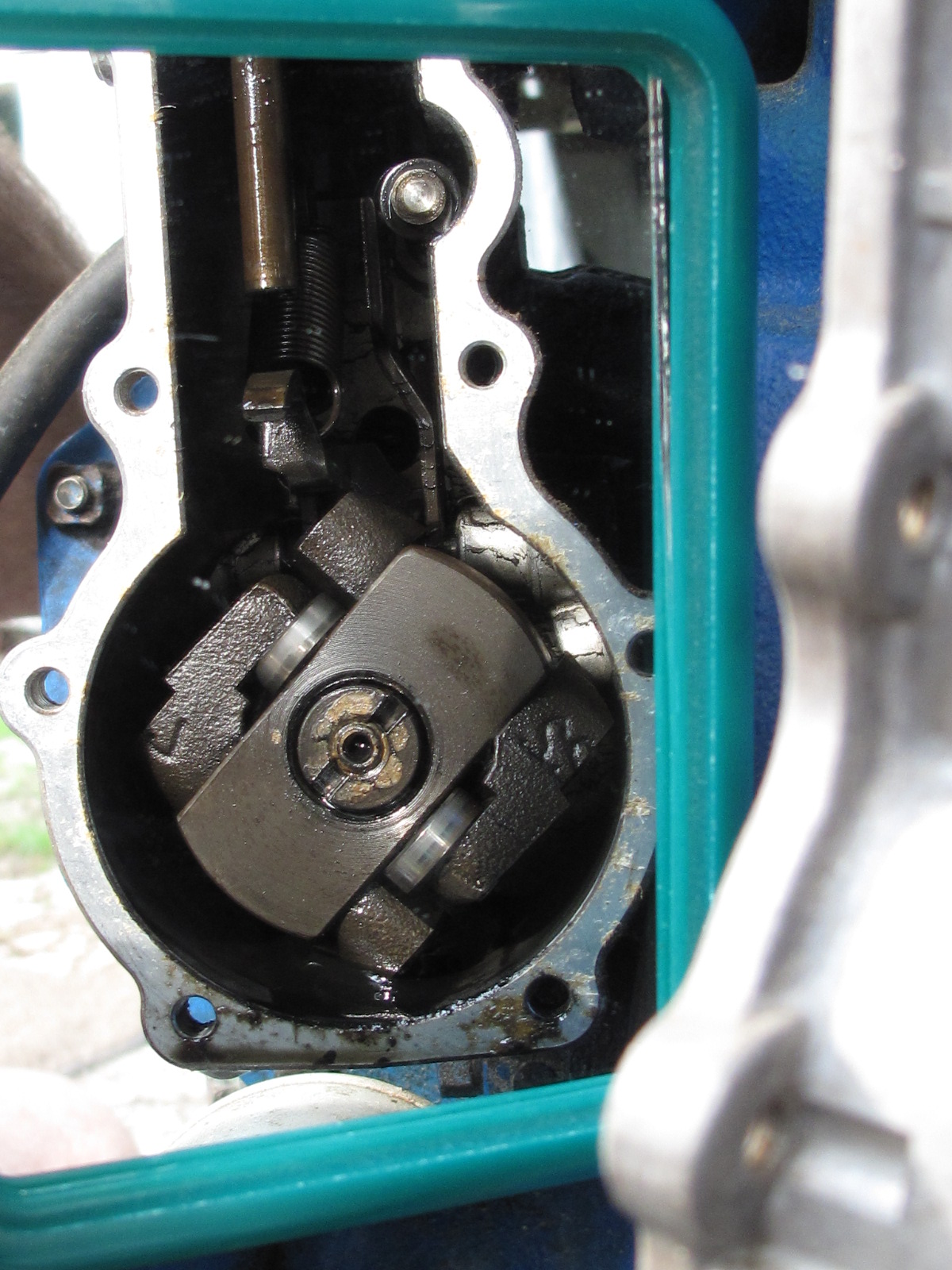

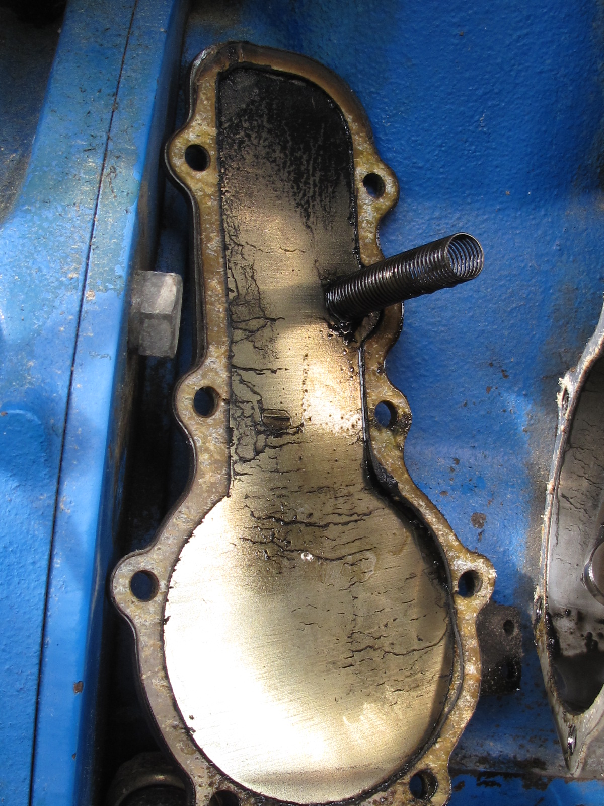

O.K. Here it is. The first shot is the pump without fill level and drain holes. The second is the back cover removed. There is a spring attached to the cover that keeps pressure on the throttle levers, didn't fall off. The third shot is looking into the back of the pump at the fly weights for the govenor. The last shot is into a mirror to try and get better angles. The oil that came out was not much, very thin and smelled of diesel.
From what I saw I would not hesitate to drill and tap the holes. I would park the tractor so it is pointed up hill, remove the back cover, rotate the engine for maximum clearance. Then drill and tap. I would then flush the cavity with diesel to wash out all the metal shavings. Another trick would be to coat the drill and tap with grease so all the shavings will stick to the drill/tap. After a thorough cleaning re-assemble and fill. The gasket came apart in removal so I will just buy the material from the auto parts house and make a new gasket.
Russell

Way to go Russell:). I knew you were thinking about it. I just can't figure why the heck they did not drill and tap some of them. I wondered if there were quality control issues, but what the heck...we're talking Japanese:rolleyes: Thanks for sharing the pictures. I bet you have not found any evidence of overflow back to the crankcase, have you?
Another question, the amount of oil in there is just a few oz. Do you see any issue if a guy just opens the back plate some to drain oil and then fill from the top a measured amount of oil. That sure beats drill and tap if you have to do an oil change every 300 hrs. I know on mine I did it for the first time at 900 hrs.
By the way how did your overhaul go after initial engine burn in?
JC,:)
ps. was the flyweight immersed in oil? did the oil come out as soon as you took the cover plate in the back off?

JC, the engine runs just fine. Still haven't put more than 10 hours on it.
As for the injector pump, the oil is contained and no connection at all to the engine. For my own self I will invest the time to drill and tap the holes. It is much easier that removing the back cover and replacing the gasket every time. From what I saw the oils purpose is to lubricate the governor linkage and flyweights. The flyweights touch the oil but just barely. Kinda like an oil slinger on a small lawn mower engine, as the weights turn they sling oil up on the walls.
Russell

Russell,
I suppose a guy could tap only a drain hole either on the pump body or a hole and a plug in the back plate. A bit of compressed air from the top and you eject all the oil out. You can fill up from top putting couple of OZ of oil. Were you able to see the cam that causes reciprocating action of the plunger/pump?
JC,

Let me "fire" this subject up again. My 1980 1500 pump DOES NOT have the drain/fill-level screws in the pump housing either. I only want to have to tackle this one time and be done with it. I do plan to remove the cover when I drill-n-tap and then clean it all out real good....BUT....my question is, what size bit and tap did anybody use?
A 1/4 x 20 looks about right as far as diameter goes, but I don't know how much of a boss I have for the course threaded bolt to grab and am thinking a fine thread should be used, or maybe even a 1/16th. pipe plug. I forget what the threads are on the plug that is a step below the 1/8 NPT plug, but I have a few of those that came out of Harley EFI lines I have accumulated over the years. The plug is used in a fuel pressure port for testing on the fuel injected models. A plumber friend of mine told me there was no such thing as a 1/16th. pipe plug when I went in to purchase a tap....but I have a few that I call a 1/16th. because they are a step below a 1/8th. and look like they will fit these bosses on the pump just fine.
In any event....what did somebody that has actually made this modification use?
