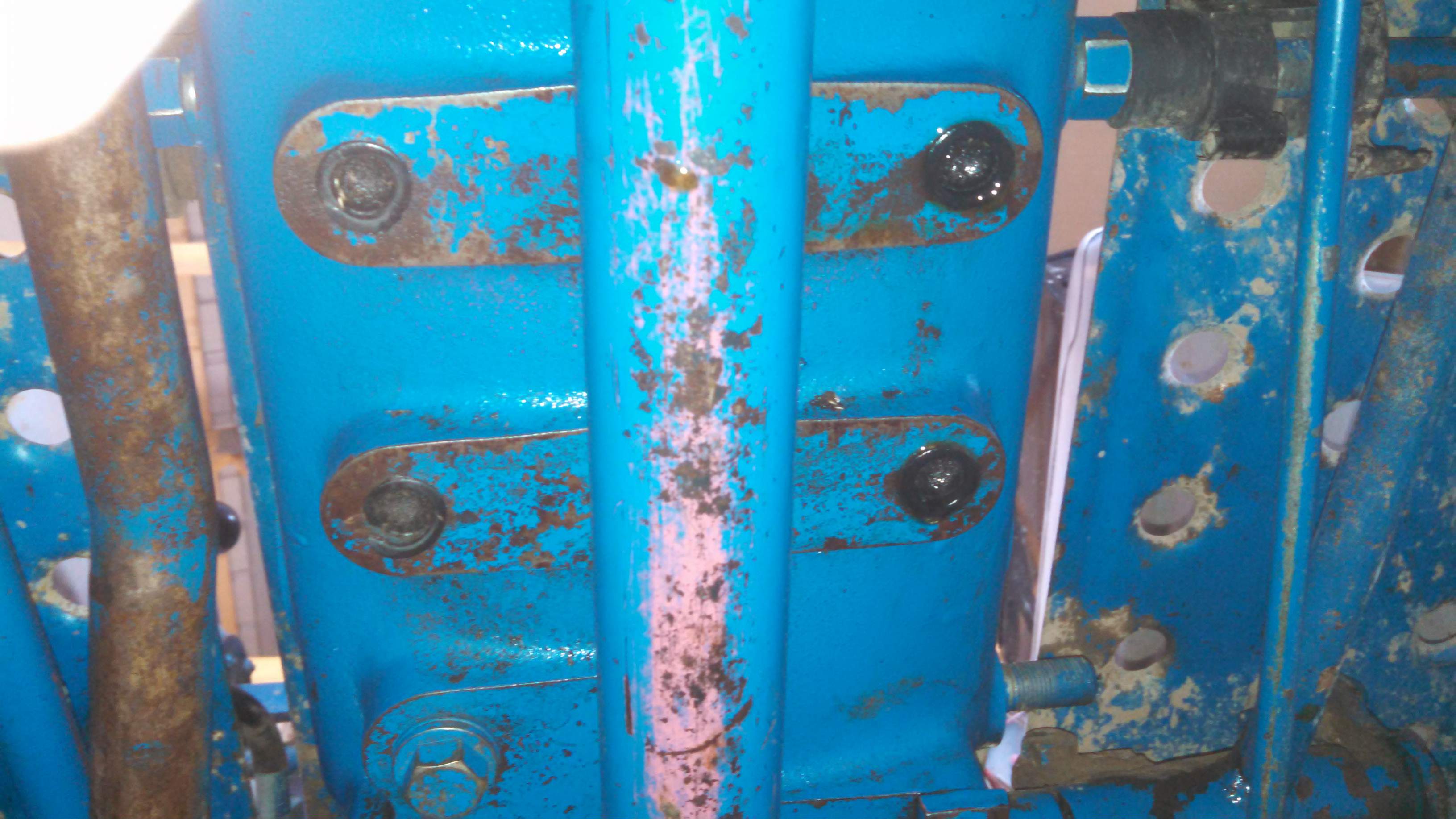

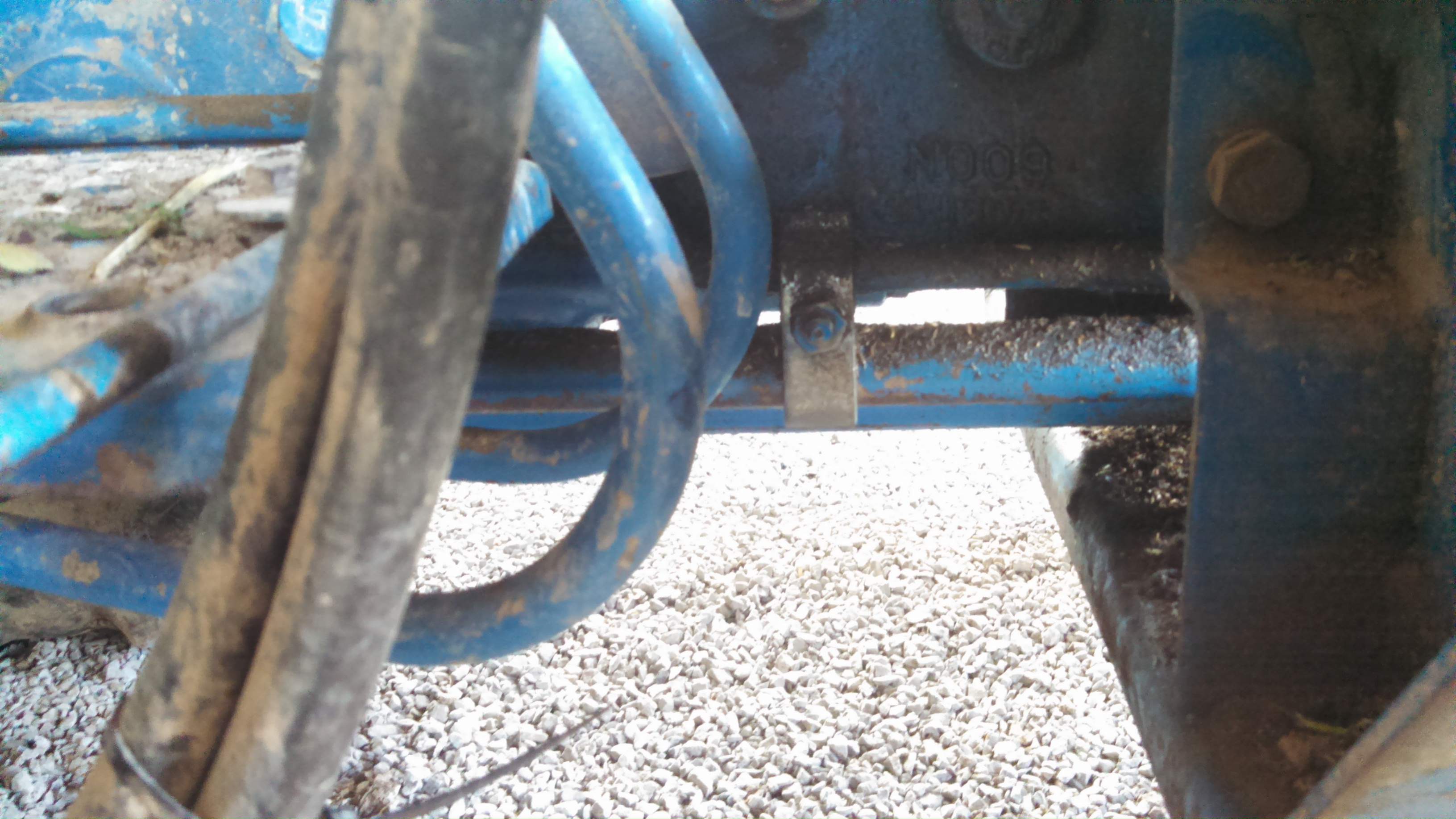

So i checked my Ford 1900 and i don't have any side mounting holes like you do, All i have is four bolt holes on the bottom of the tractor. (not sure what they are for.)

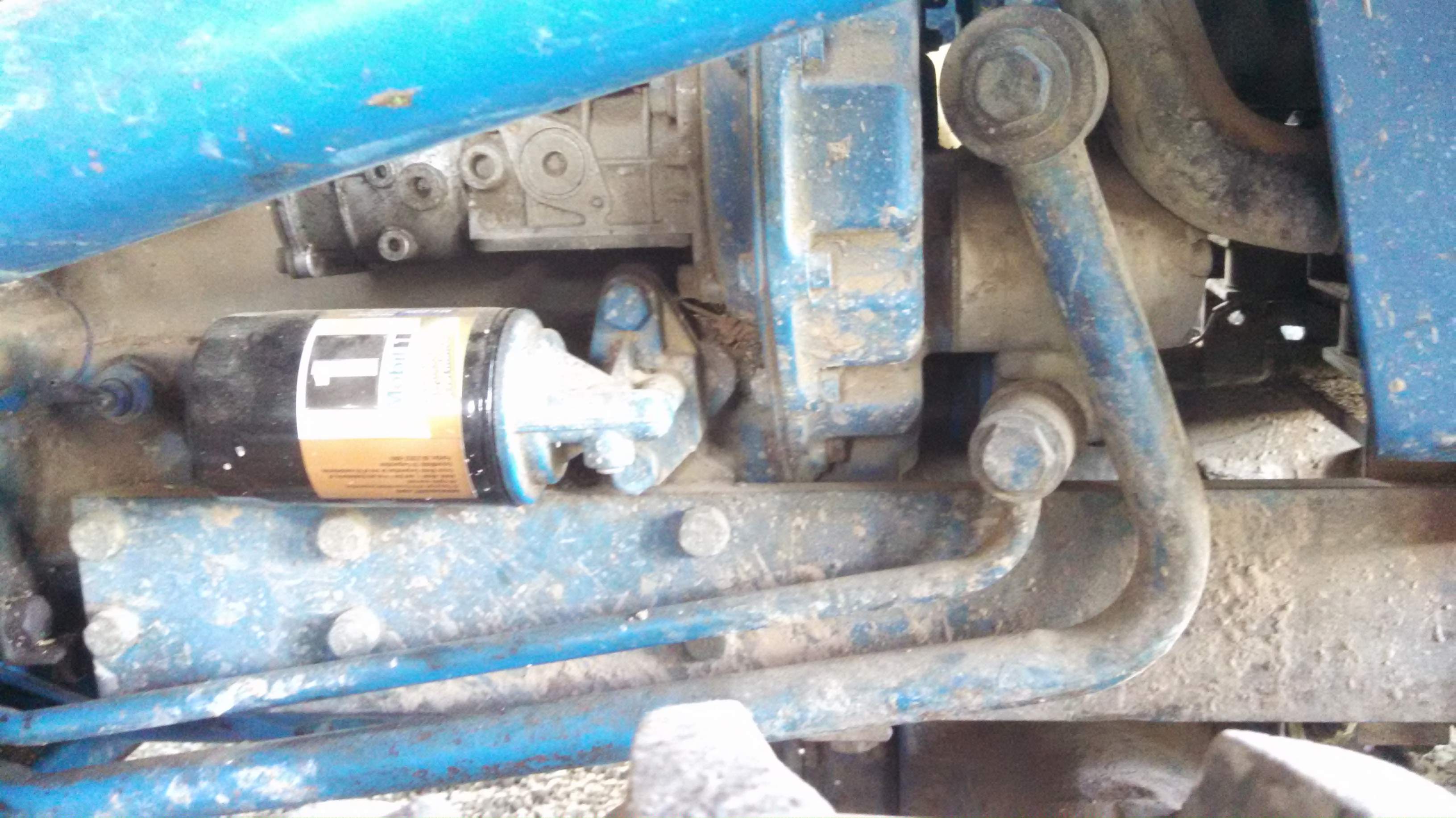

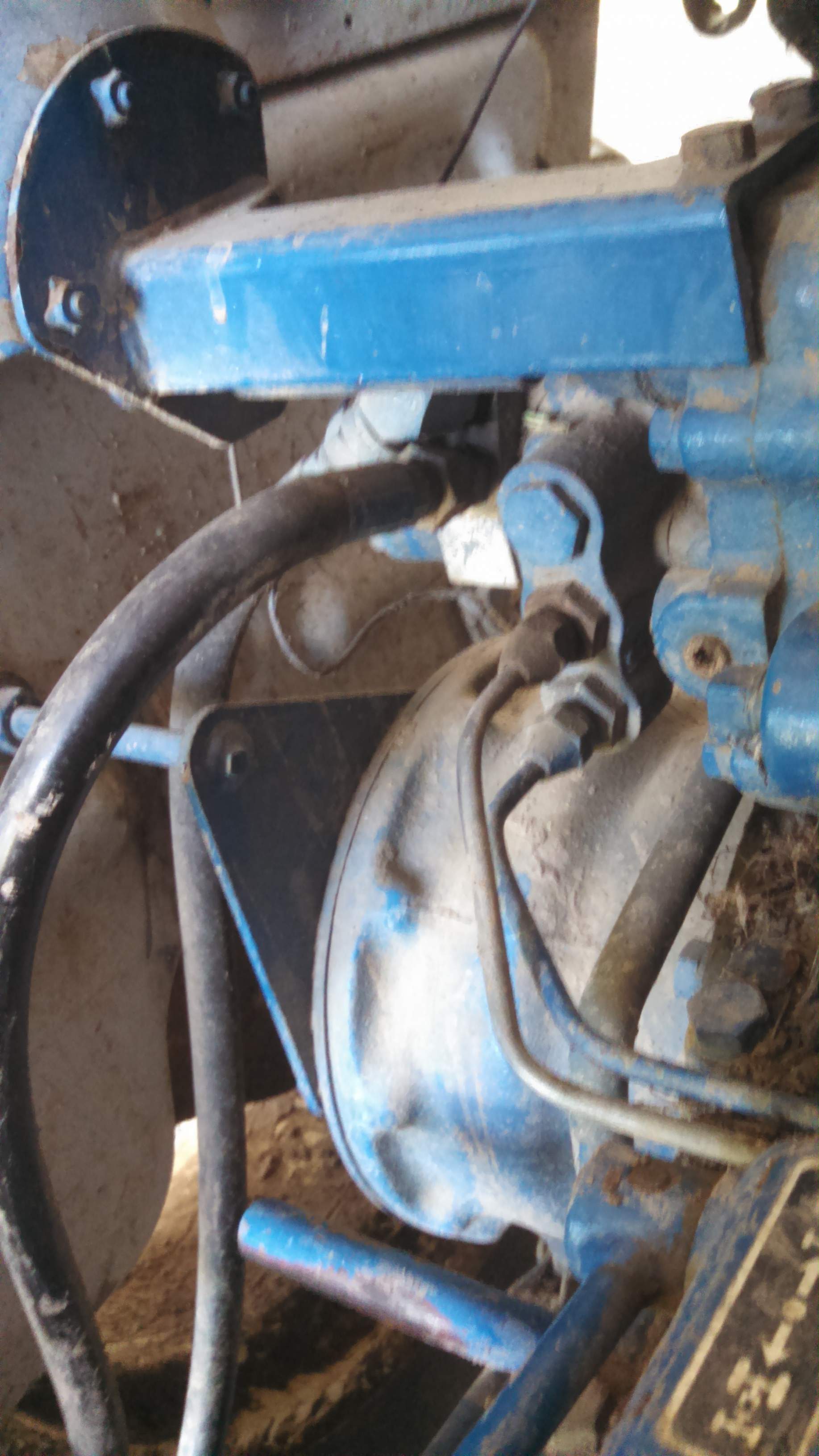

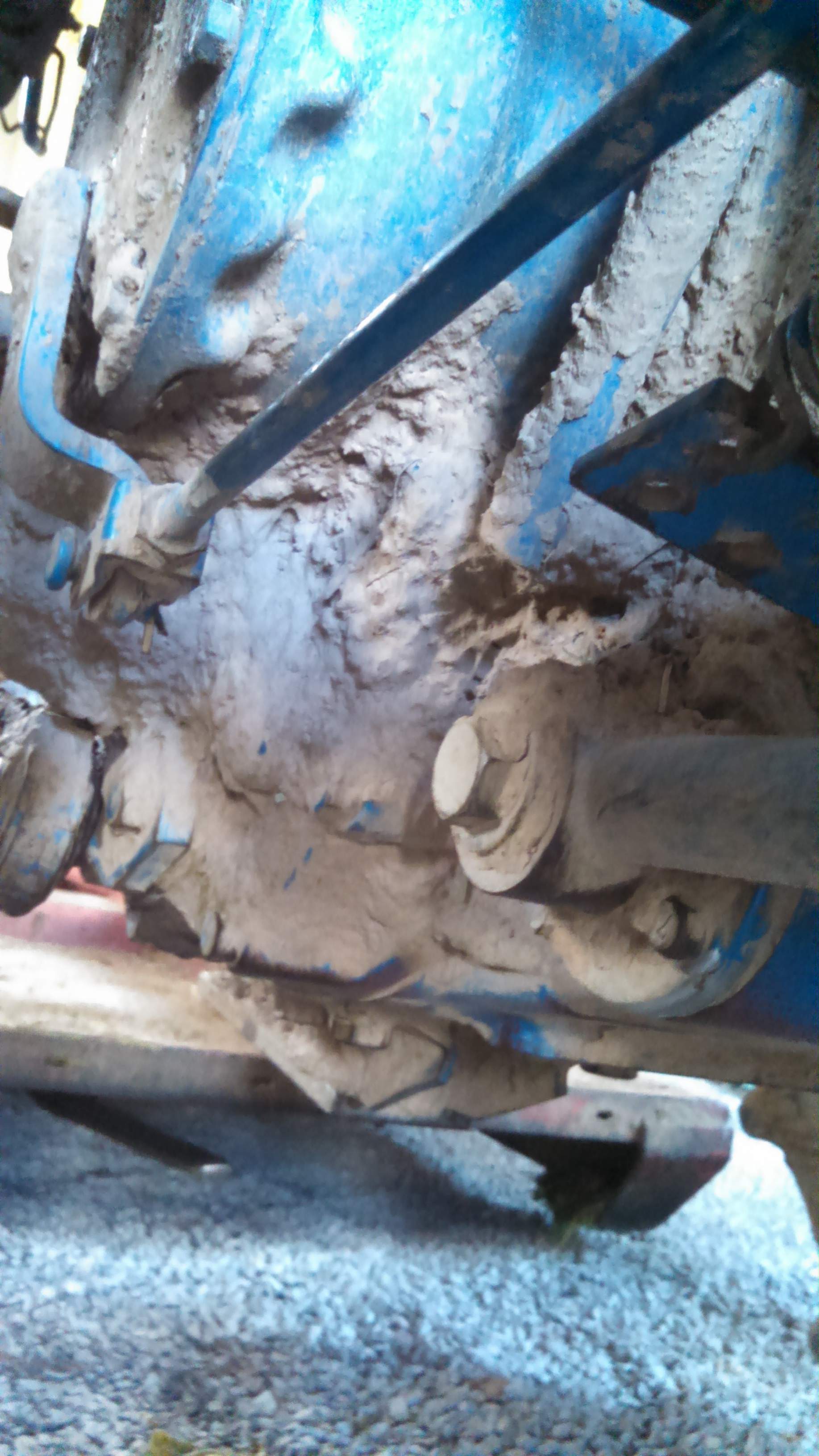

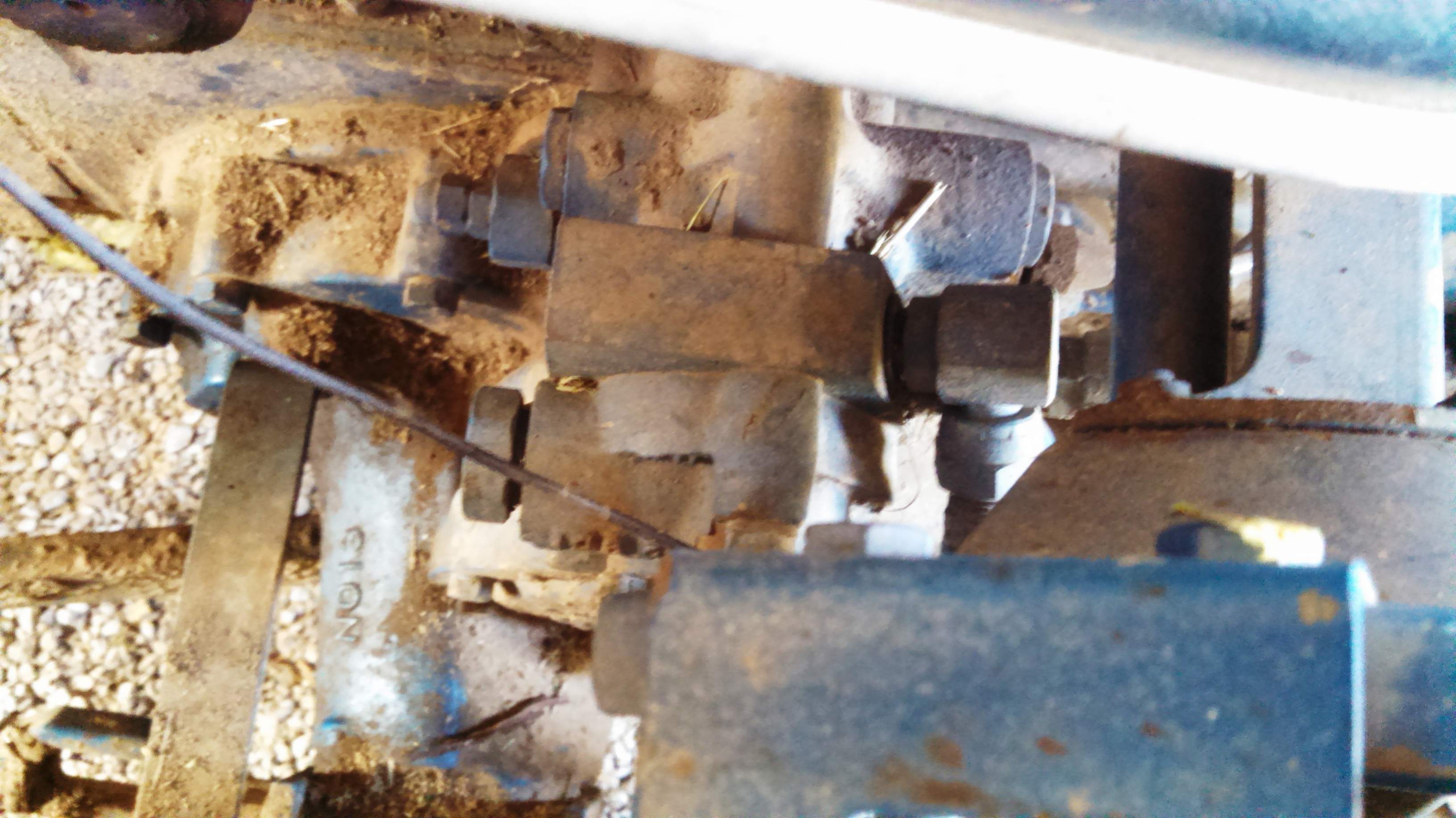

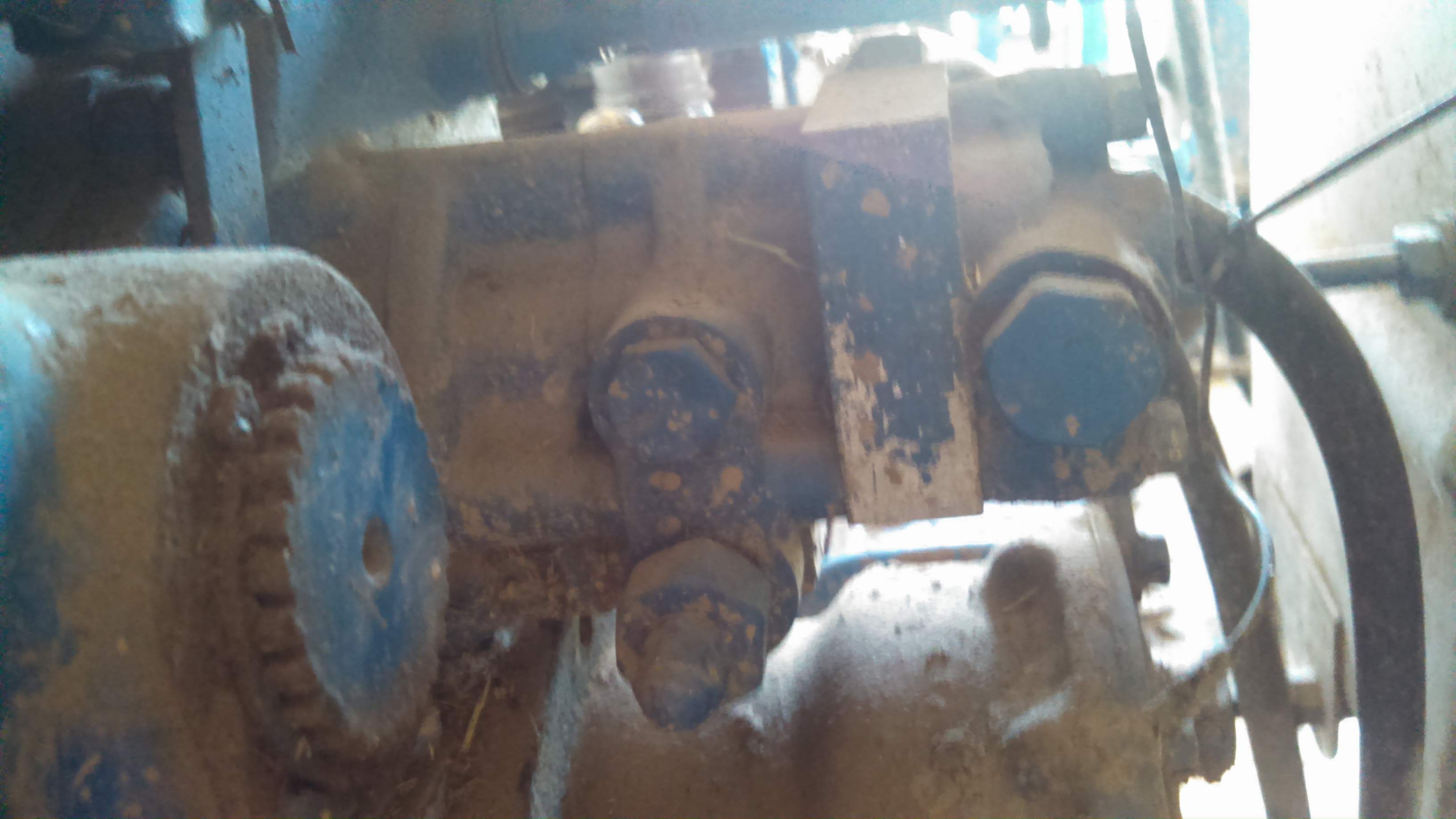

Also as for the hydraulics where would i connect the lines too? I don't have a mid hydraulics ports like you do you yours.
Hydro Block top.jpgHydro Line Front.jpgHydro Line Lower Rear.jpgPower Steering.jpgRear Hydro Ports.jpg
   / Ford 1520 4WD and Ford 758A Backhoe #35
Not sure right now a friend of mine has a 1900 I will look at his and get back to you. It's kind of hard to figure out with just pictures.

I just got the backhoe today, and i think i figured out a way to get it to attach by making two brackets and attaching it to the side of the loader mounting bolts using 3 bolts.

Just going over the hydraulics and not sure what to do exactly.
   / Ford 1520 4WD and Ford 758A Backhoe #40
You should be able to get pressure from the hydraulic block under the seat right hand side(I think). Not sure where to install a return yet. I'll keep looking. The best thing to do is install a gauge into a port that is currently plugged off and see what kind of pressure you have. One of those that is sticking out of the rear of the block should work. For the return you can always pipe into your fill port using a tee so you don't have to remove the line to add fluid. It wouldn't be my first choice but it's an option. There has to be some installation instructions out there somewhere...the 757/758 backhoes were an option for your 1900. If you can find a copy it would help a lot even though you have a different model hoe.
