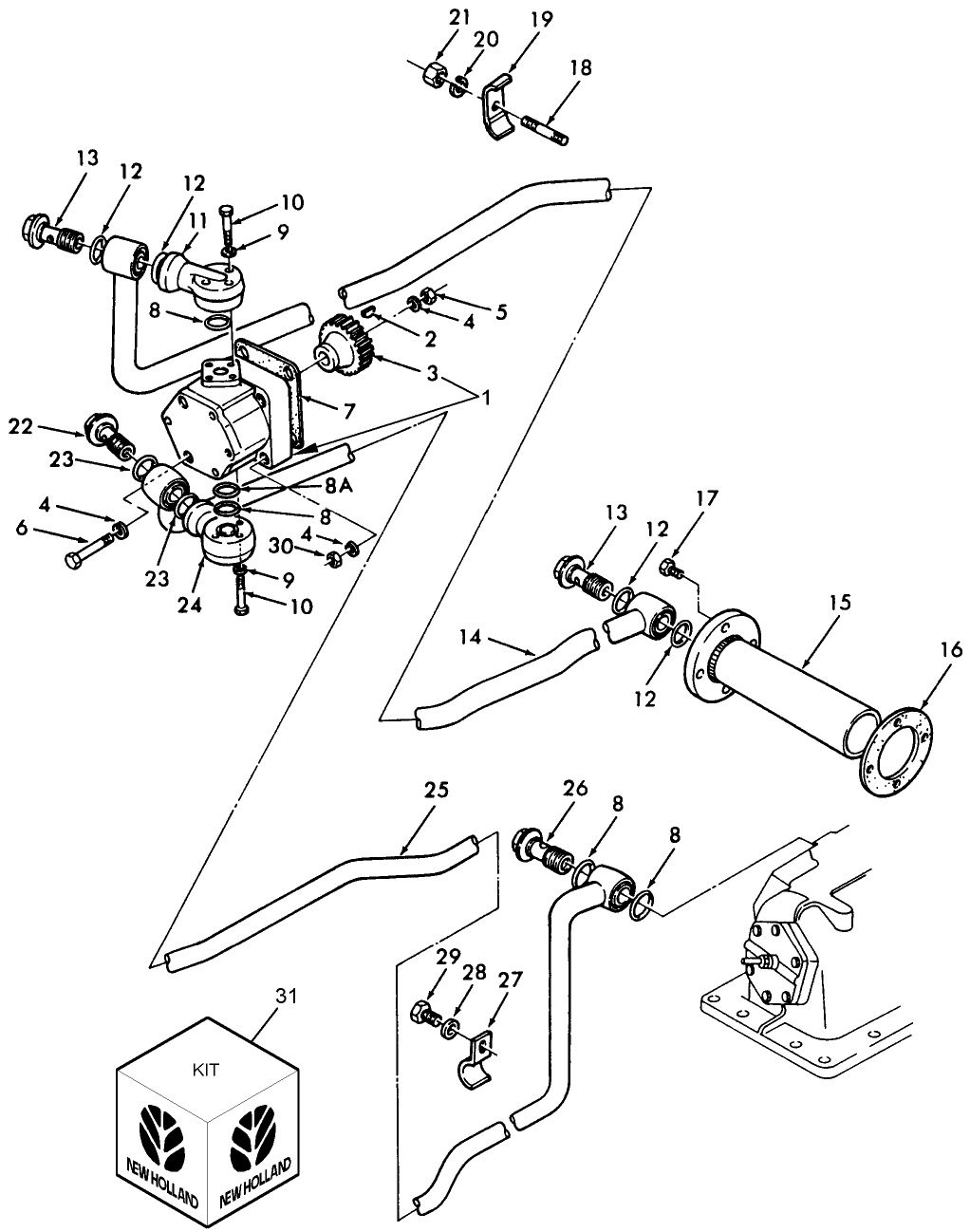

where is this filter located ? a friend just ask me today where it was located on his 1700 ford .
   / Ford 1700 Hydraulic Filter Clogging-photo #17
i don't have a manual for a 1700.. howevr you can hit the dealer site and pull up exploded diagrams from CNH / parts site.
If it's like many tractors.. it's a tube stye in the base of the center section..
   / Ford 1700 Hydraulic Filter Clogging-photo #18
here, I did your homework for you.
part #15.
easy to find. just follow the tube...
   / Ford 1700 Hydraulic Filter Clogging-photo #19
More visual aid.
