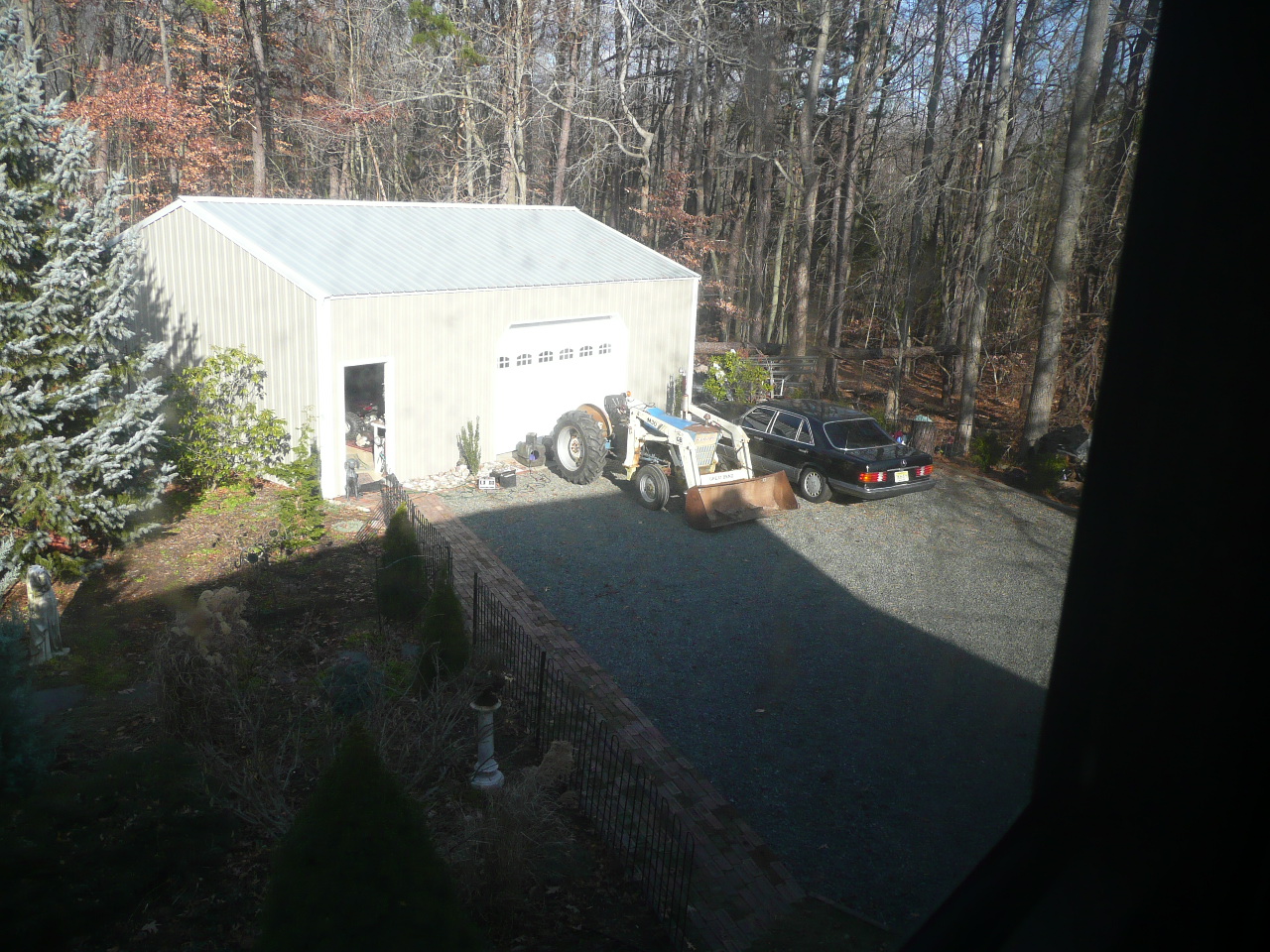

THANKYOU,MY NEW TRACTOR IS HOME AT MY BARN!!..I RECHECKED ALL MY CONNECTIONS,RESET POINT GAP..DID TSP OF OIL IN 2 EASY CYLINDERS..THEN I HAD THROTTLE ROD IN PROPER POSITION,ALL THE WAY UP,HARD..JUMPED MY TRUCK TO FRESH BAT ON TRACTOR..INSTEAD OF BLOWING ETHER IN CARB BOTTOM I REALLY JUST KEPT SQUIRTING IN AIR INTAKE ALOT,,IT SLOWLY STARTED TO STRNG SOME POPS TOGETHER!!!.THEN IT RAN!!..RAN IT FOR 15,,NO SMOKE OUT OF STACK AT ALL,ALL SEEMED WELL,,TSTAT DIDNT OPEN YET BUT I WANTED TO GET IT HOME,,OIL IS BLACK AND IN A PERFECT WORLD I WOULD HAVE CHANGED IT BEFORE THE 3.5 MILE RIDE HOME,,,WORKED GREAT UP AND DOWN HILLS ETC,,LOT OF SMOKE OUT OF CRANKCASE VENT...DIRTY OIL?..AFTER PARKED IT DRIPPED SOME WHITISH GOO OUT OF THERE TOO,MAYBE A TLBS...THANKS SOUNDGUY,,JIM
