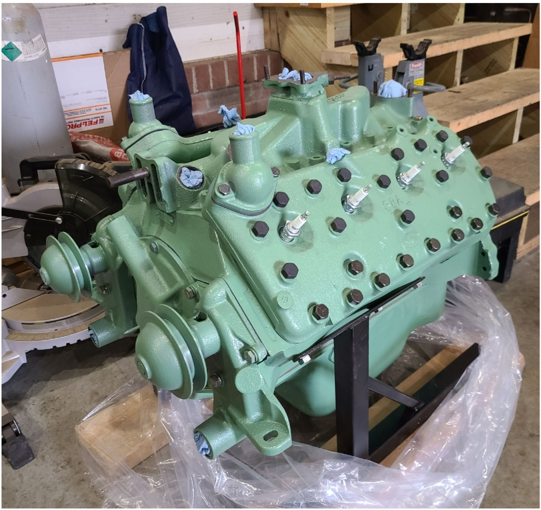

Definitely not the way I wanted to fix it, but I really want to finish restoring my '52 Ford F1. Just finished rebuilding the original flathead for her. Off to get that back in and everything else situated. Hoping to be ready for the road by summer.
I was open with the guy and told him everything that was going on, so wasn't hiding anything. He claims he's a collector, but for all I know he's going to fix it and sell it for much more, and if so, no worries on my end - his tractor, his choice, but I do hope he keeps her and gets good use out of it like I did.
This is my flattie I just finished for the 52. I know it's an odd green but the 52 F1 was the only year F1 that used this same color engine too, 48/51 were tangerine red - doing a factory resto on her.
