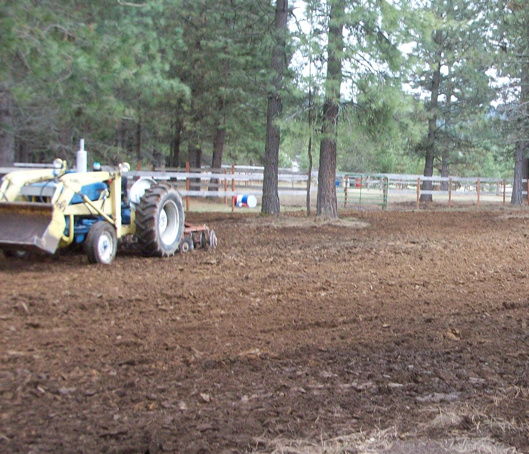

Well the 3000 is capable of those jobs with loaded rear tires and a 1000+ lb implement or weight box attached.

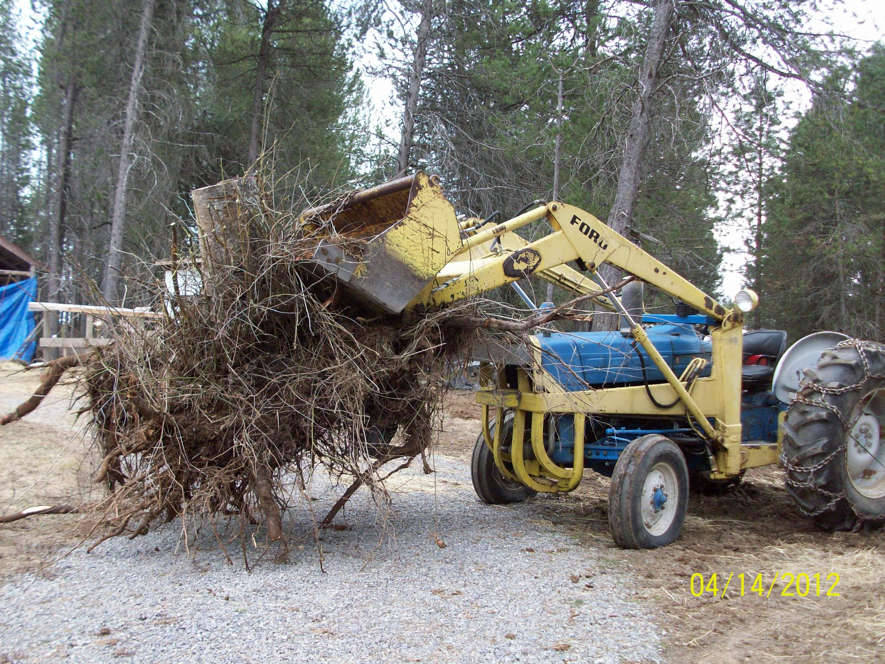

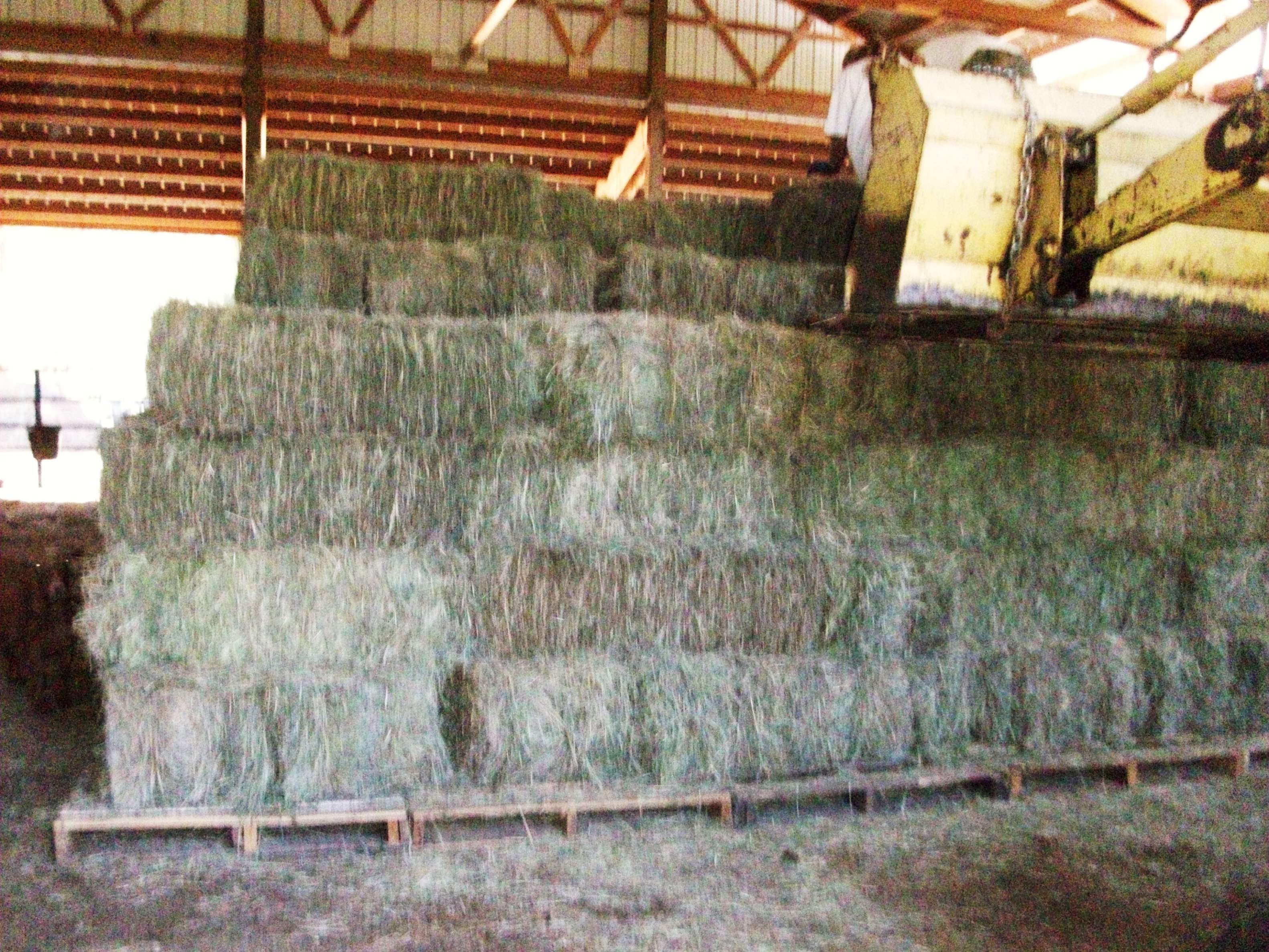

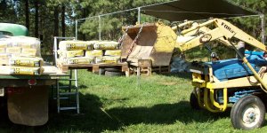

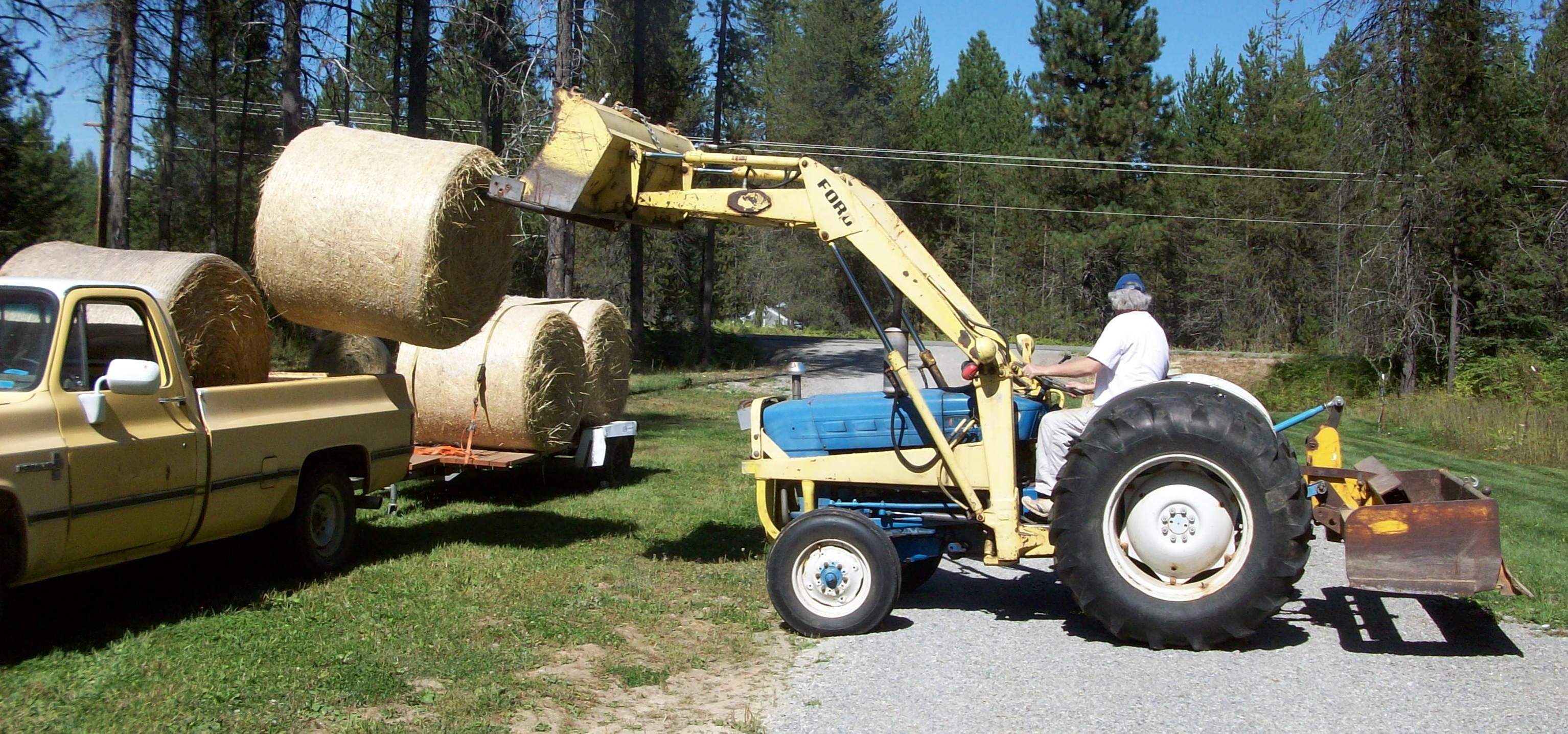

Some old shots of my 3000 working
Plowed snow with it to and it did remove the stump in the last pic in addition to transporting it.
The 3000 Ford can do a lot of work - but it needs weight in the rear- either weights on the rear wheels or loaded tires and something heavy on the 3 point to work effectively with the FEL .
This also does wonders for backing up inclines with a fully loaded bucket.
