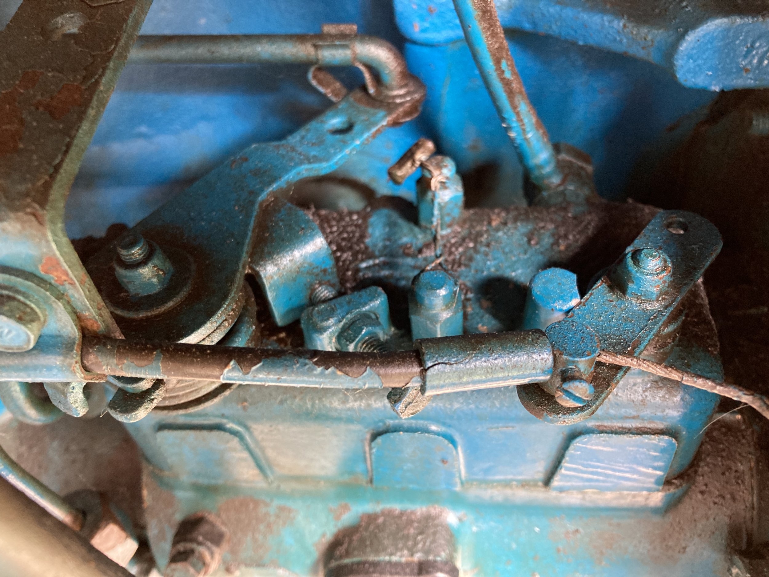

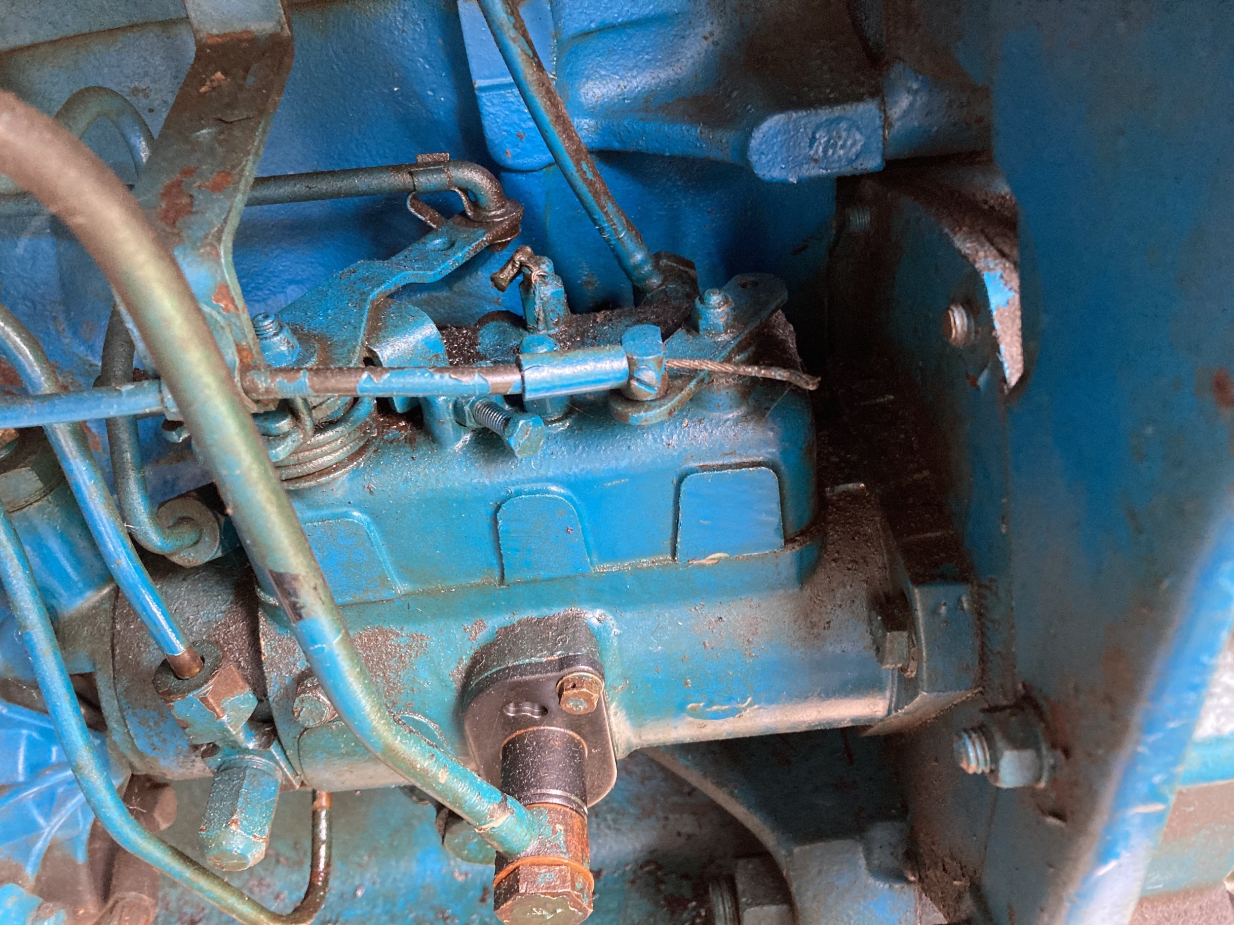

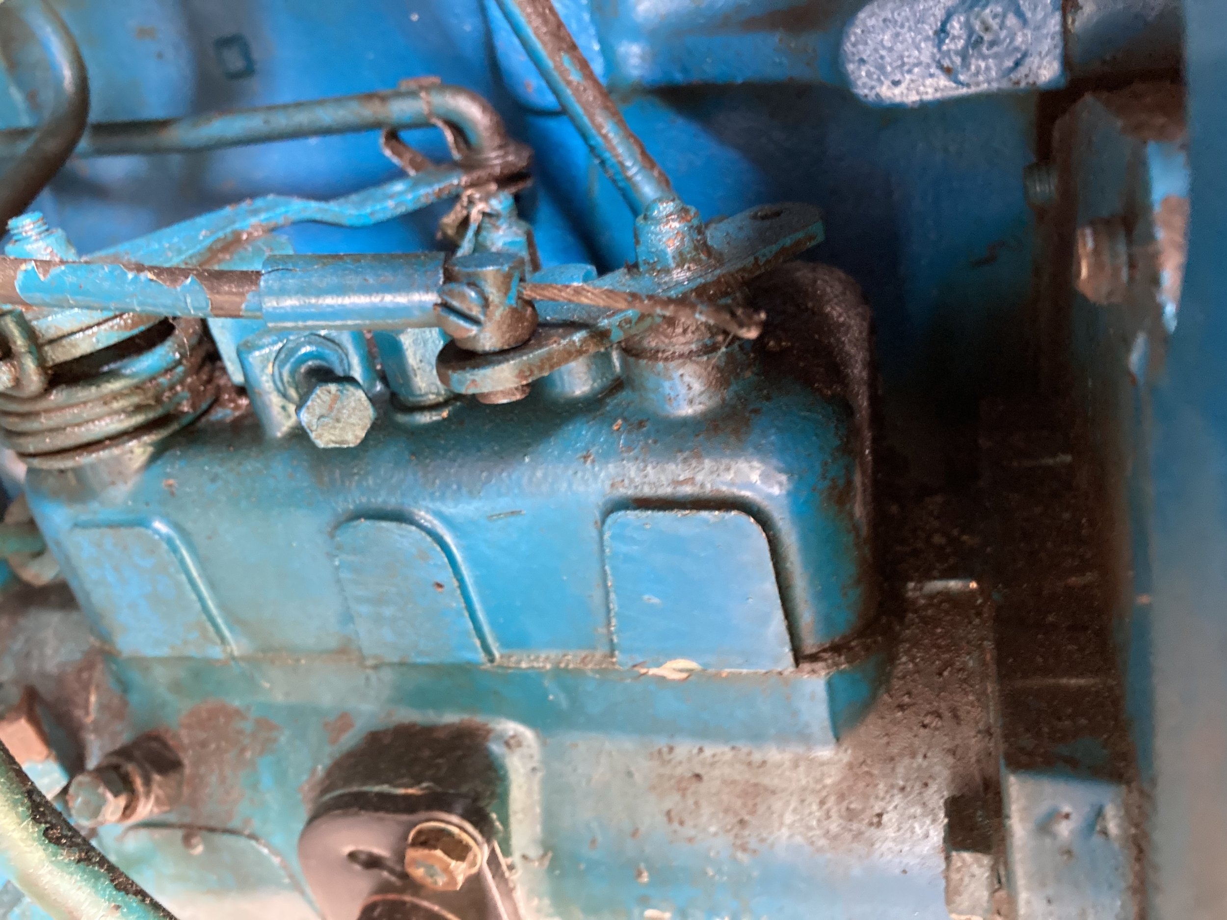

I know this is an old post but i have the exact same problem. Can someone tell me where the slot is? Is it on the top of the injector pump or is it on the throttle shaft??

Under the cover, RH side of the pump looking forward on the tractor is a flat plate with a hook toward the front. The dowel/nub of the shutoff shaft has to fit into the slot or hook.

I don’t follow what you are talking about. The spring goes in the middle hole on the button on the throttle plate. The other end goes through the middle hole on the throttle shaft tab that pivots. Make sure the tab is able to swing around to lineup with the spring.
The throttle arm on top of the pump is keyed to match the throttle shaft. If the shaft is not pulled all the way up, the arm will not engage into the shaft.
