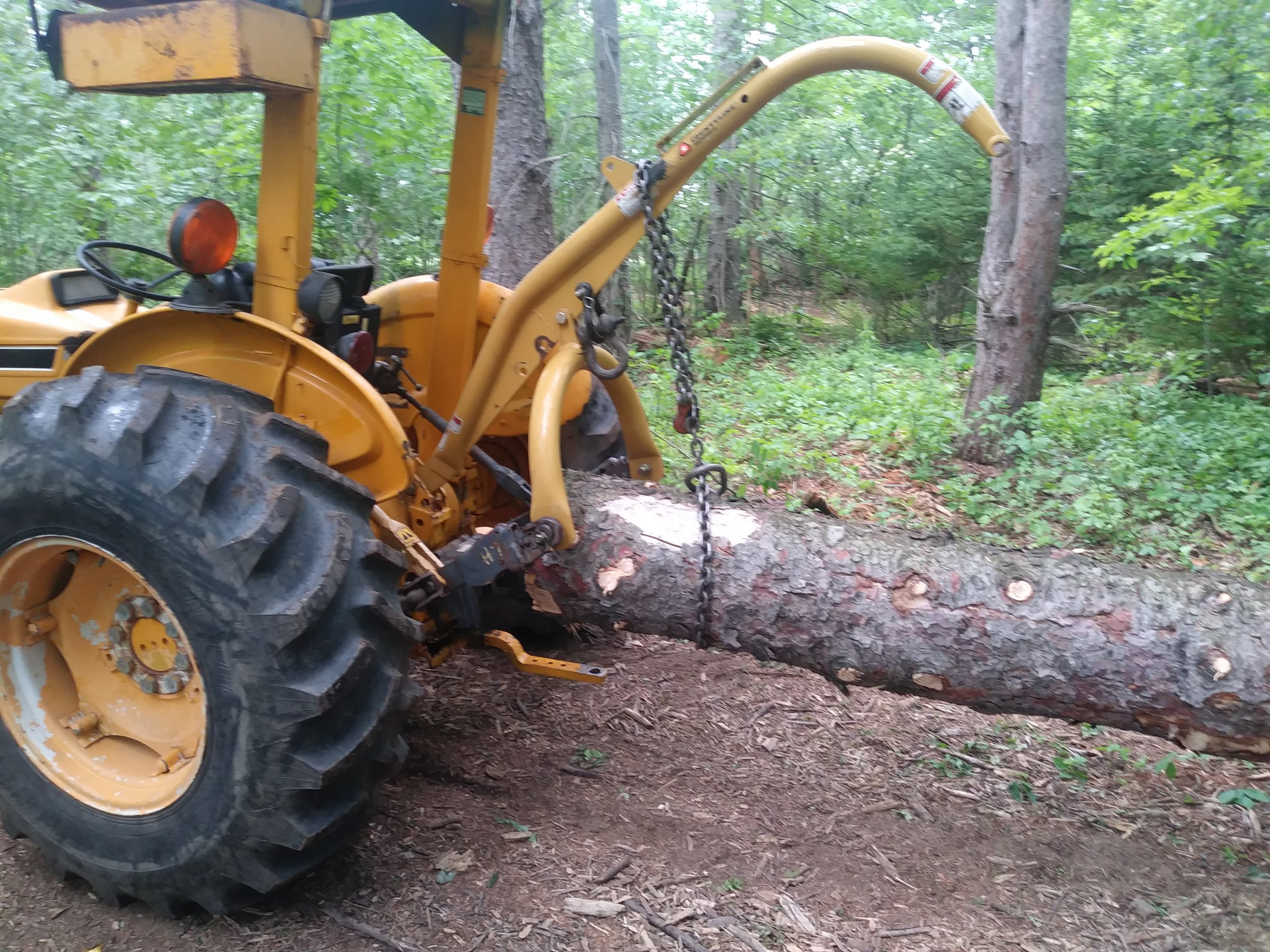

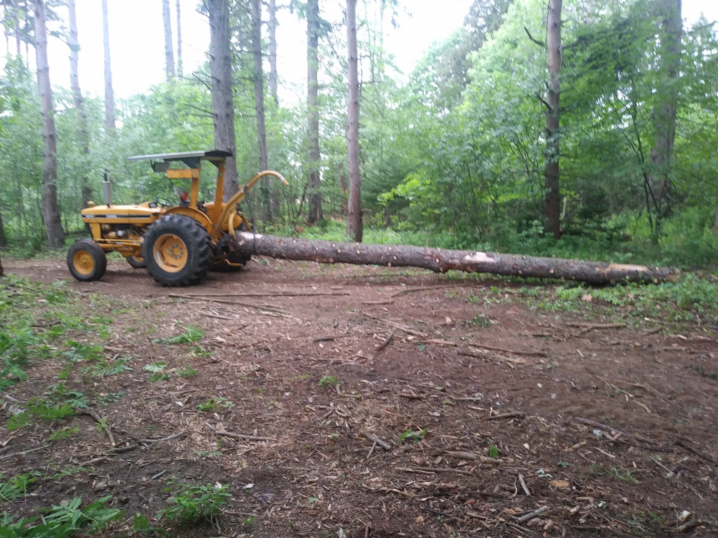

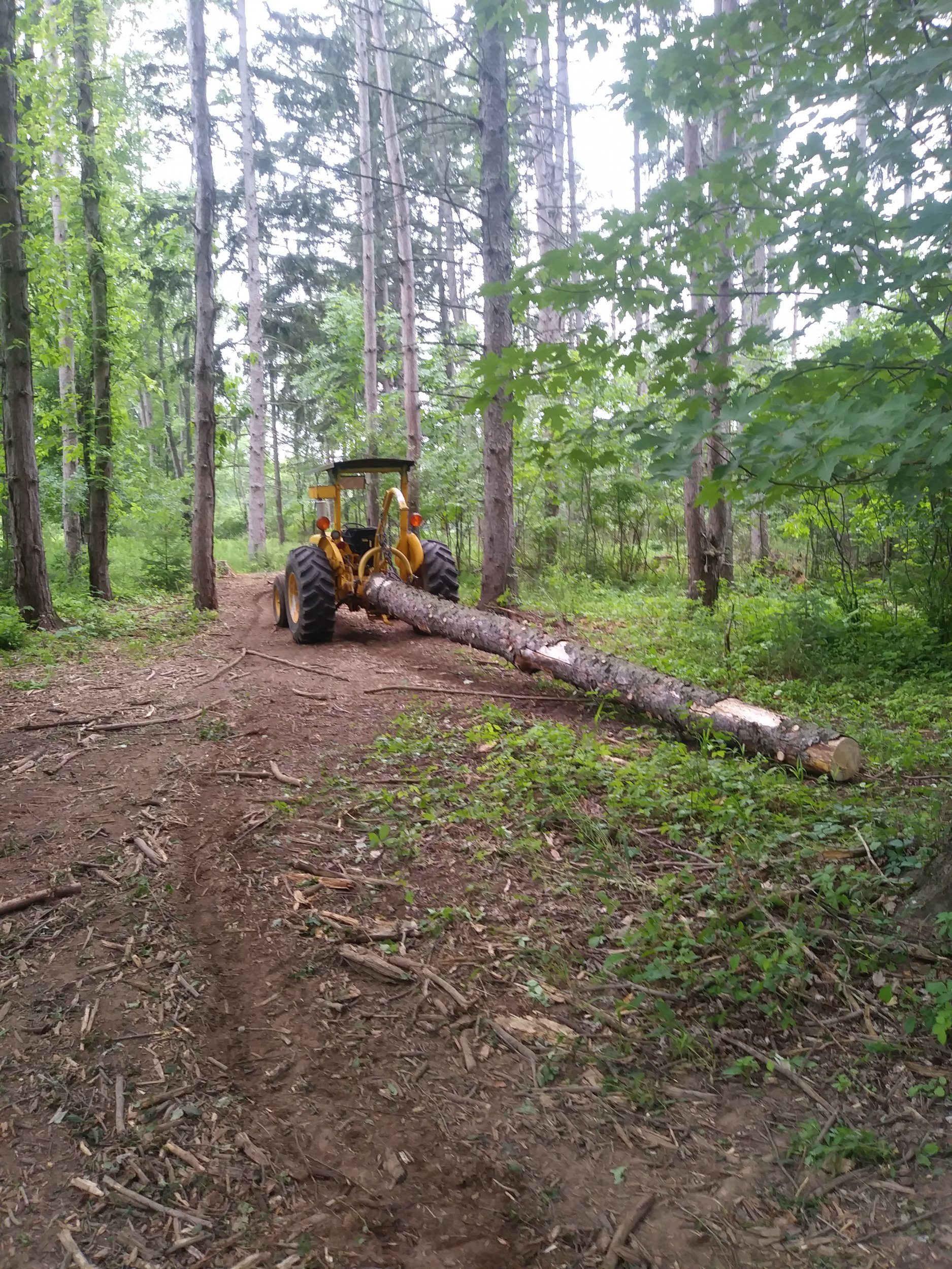

Like in the picture posted, I have used the arch portion of the post hole digger to skid timber.. Using the arch with the top link and not the arm portion of the PHD...
Using a hook on a heavy quick chain link pinned to the point where the top link attaches to the arch.. This to lift the log, then using the fixed draw bar to pull the load has worked well for me..
Keep safe...
I did just that today as a test, it works pretty well. Just need to come up with a winch solution now.
