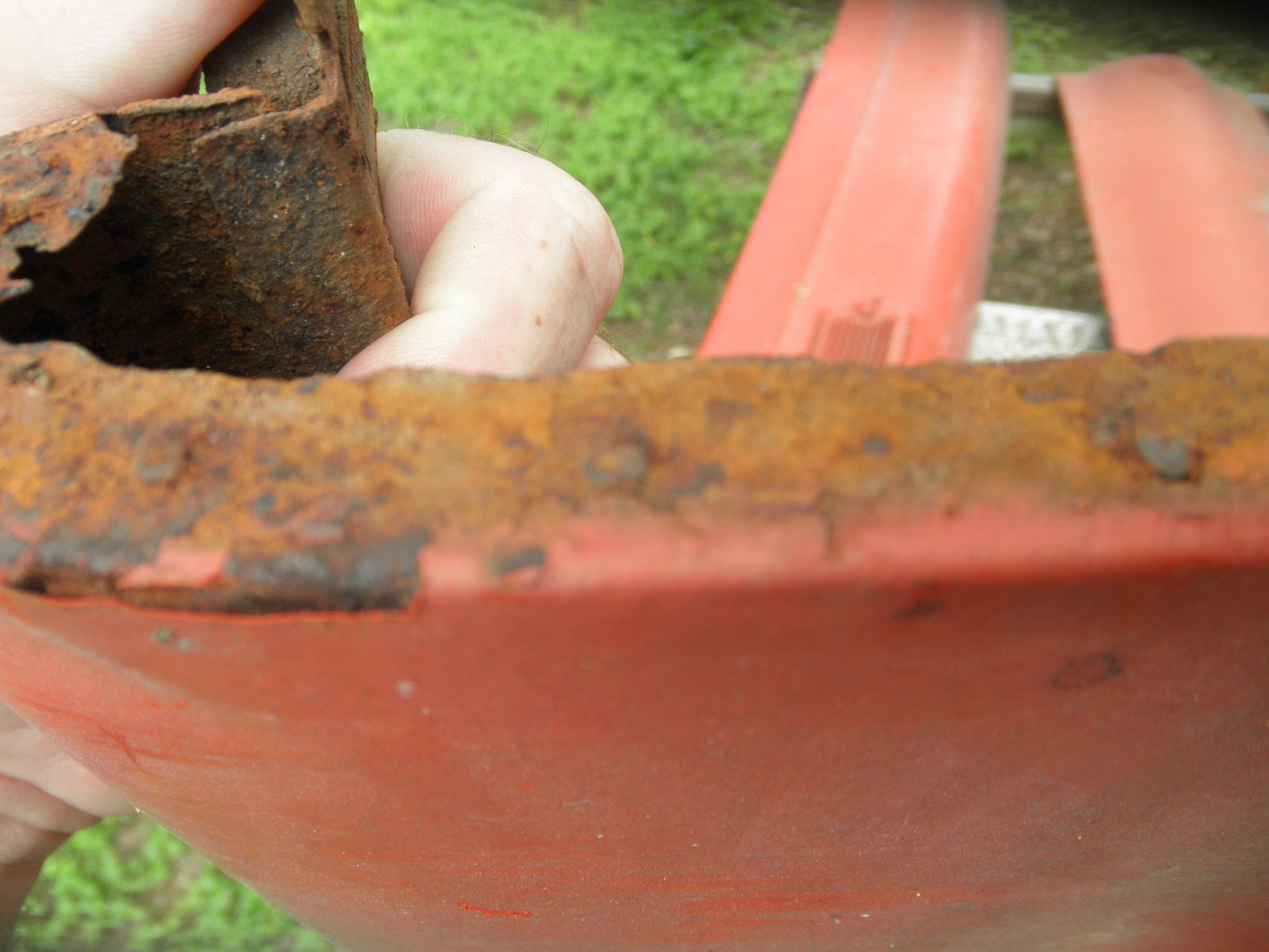

I bought a 641 last week that was kinda running. Kinda. The sheet metal was off and it actually ran a little. A little.

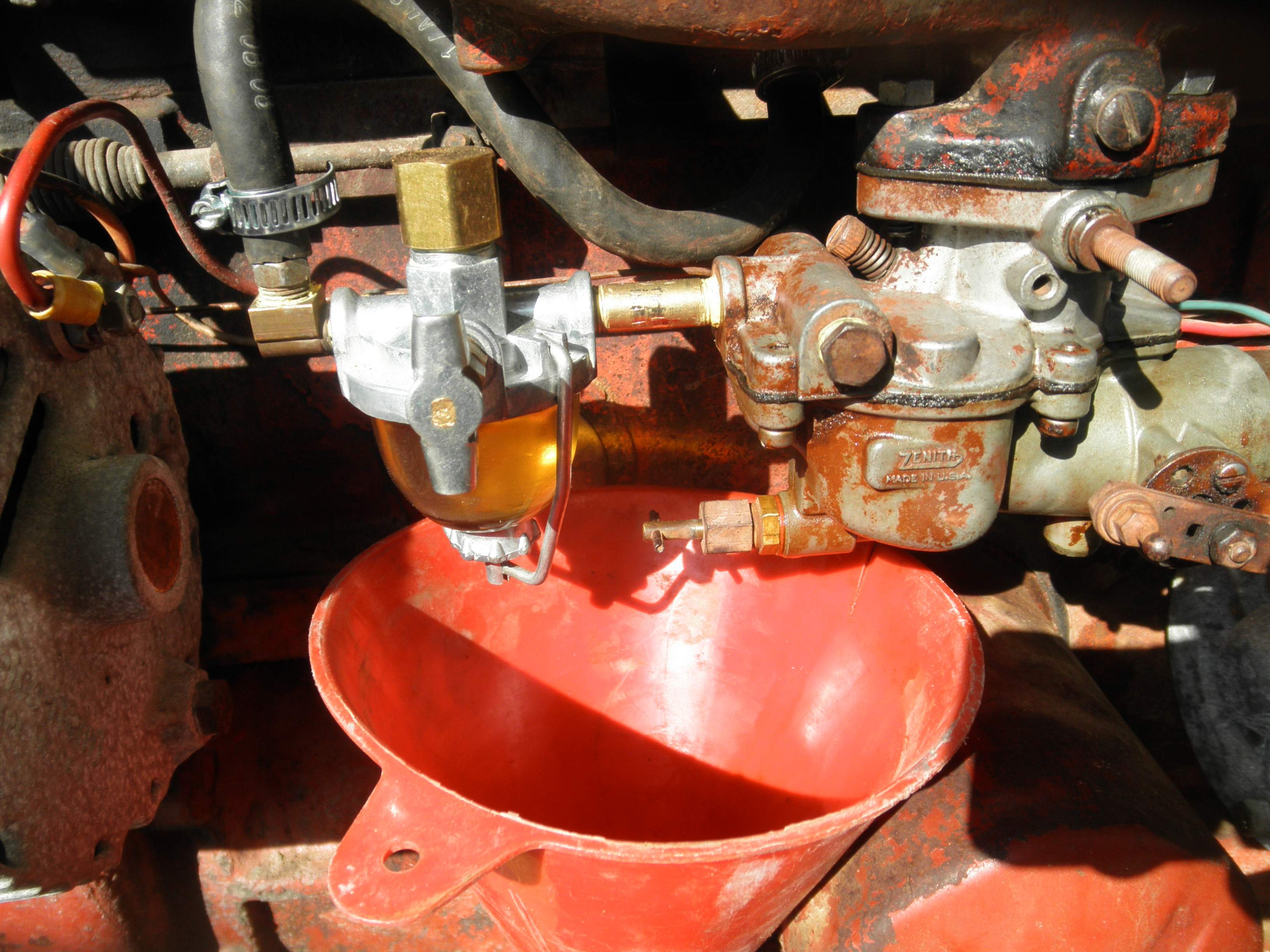

It had a Zenith carb on it that was full of sediment from the rusty tank and the float was stuck open on it.
So far I've cleaned out the tank as best as I can, rebuilt the carb, and put a sediment bowl inline.

1. What are the proper adjustments for the Zenith?

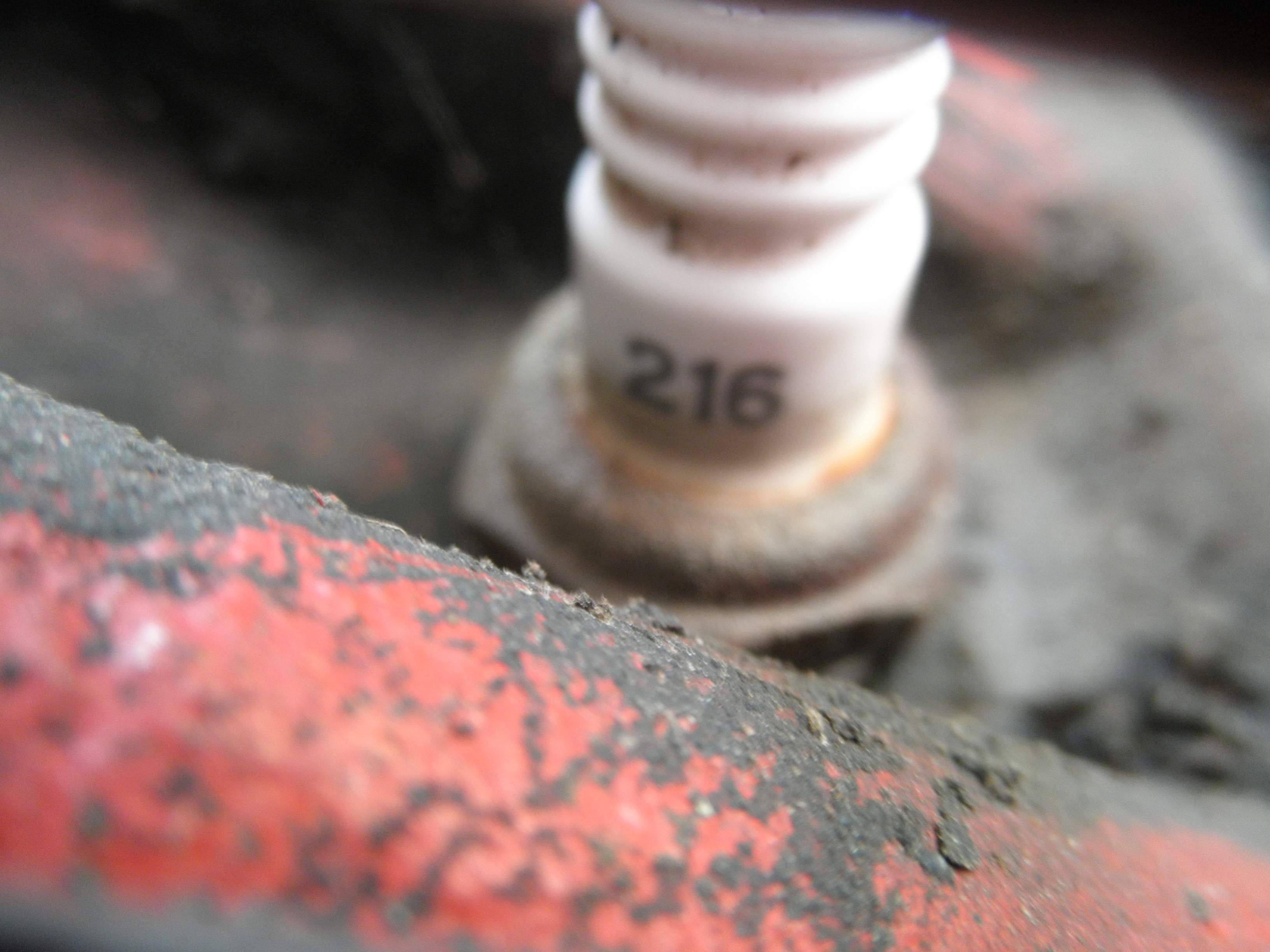

2. It has 216 plugs in it. Are those the appropriate plugs for it? Will it run the 437's like the 8n any better?

4. The sheet metal pieces look like they were spot welded originally. I'm thinking I might do that but also run bolts like my 8N's. Were they spot welded or some type of rivet?

Today I drained the water out of the carb(shouldn't have to do that too many more times) and sediment bowl and cleaned and regapped the plugs.
The plugs were all over 25 with one of them around 40.
As soon as I hit the starter the 641 fired right up. I was very happy to see that.

437 plugs work fine.
