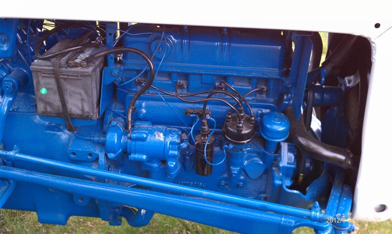

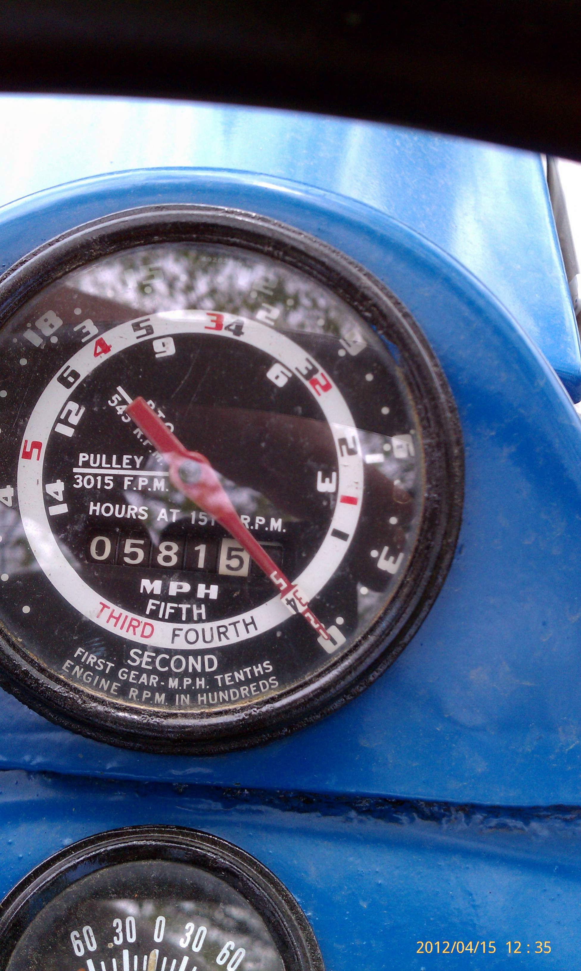

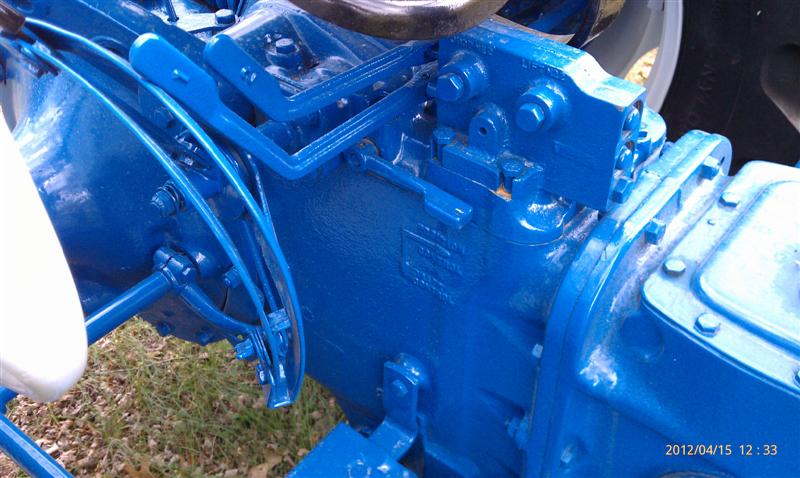

OK, in my travels this morning I spied a '63 Ford 4000.
Asking price is $4500 which I think is high.
There's a little wobble in the water pump bearing so that needs replacing and the front tires are shot. It's been cleaned up and repainted. Since it it only shows 580 hours on the meter (if you can believe that) for a 50 YO tractor as thats only averages out to ~11 hr/year. So most likely the meter is wrong or was replaced some time ago.
s/n reads
41202
<>21844<>
If my secret decoder ring is working then this is a 63 Utility type with 172cid gas engine and 5sp trans with live PTO.
The block casting number is CONN 6015 J which appears to be correct for the tractor model year.
this was all decrypted using the information at:
http://www.oldfordtractors.com/idhistory.htm
The tractor I saw today is every bit as clean looking
as the one that appears on the web page above.
I'm thinking that $3000 to $3500 is a more reasonable price range, and keep in mind that prices run a bit higher in the NE than elsewhere from what I have seen on most everything, even used 50 YO tractors. :)
