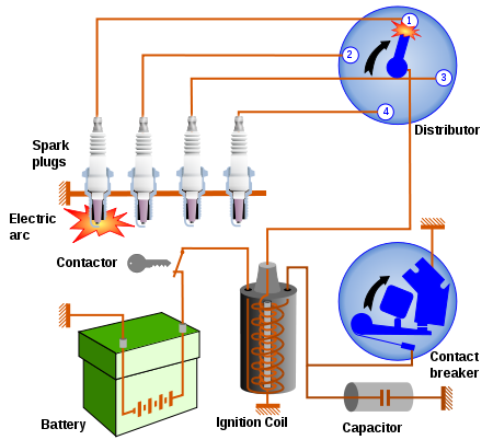

Hi all im new to tractorbynet form.I have a ford 8n front mount dist. i put new coil points and condenser and rotor button and cap on three times still no fire. I know i cant have 3 bad coils and points from different places could any of you help me and tell me what im doing wrong

Here is the diagram of a common ign circuit.
If you connect things correctly, and do the test we have stated, you should have diagnosed and fixed the problem.
To eliminate the switch, jump directly from the Batt, and have the points opened, and then put the screw driver touching the two points and remove them. A spark should occur if parts are good, and connected correctly.
A shorted capacitor will keep the current flowing and not allow spark. You can remove it for testing. It is only used to keep the points from arcing/sparking and pitting.
I believe the ign switch only provides voltage to the coil, and the start button only starts the tractor.
Diagram.

Thanks all for your help but i think i have found the problem. I tested the breaker plate withe the points open and it was grounded out at the brass screw and the cooper strip the insulation seems to have rotten.But after this fix i will keep you informed if this works.

put in new breaker plate and it did not help.I unhooked the resistor for a few minutes and got fire. i have three resistors that are the same. Can you tell me what value resistor i need. I know i need the resistor inline or it will smoke the coil but is everyone for sure they are not makeing the coil with one inside of it now. I bought the coil from TSC.
