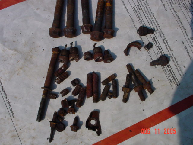

Autozone was just about the same price. They did not have any in stock. Here's the remnants of my spark plug/cylinder head job. What you see are broken intake bolts, remnants of the spark plugs, cutoff exhaust bolts, rotted head bolts and numerous other rotted parts including a piece of my old valve cover. The surgery was a success and she runs like a dream once again. It did however take me quite a lot of time to figure out what the heck an "Inline Spout" was. You need to unplug this in order to set the timing. Thanks to Google, I found out what the heck it was.

Thats a shame it took so much, wonder if a WD40 coating would help or just burn off...The spout in place allows the computer to adjust the timing, fighting your adjustments. With it removed, you can set the timing accuratly.. But I guess you figured that out already. Glad to hear its up and runnig again, hope you have better luck.

Just a question but did the prior owner spray the engine in salt water once a week or something? Maybe a acid bath? Perhaps he stored it in a state salt pile.
I have run 3 Ford pickups since 88, 2 years/44000 on the first then got hit by a tractor trailer, 8 years/198000 on the second (got tired of the color), and 7 years/50K and counting on this one (changed jobs /forums/images/graemlins/grin.gif. ) None were 100% garage kept. The second lived inn a garage for a year. The third has had a inside home for about 1.5 years.
I have run GM, Dodge, Triumph, International, and White stuff before and currently. I have not seen anything like that corrosion on a motor that has been taken care of.
I guess if he never washed it off after the winter calcium season it could get like that. I'm thinking that is a lot more human error more than metalurgy.
Glad to hear its up and running.

Here are my thoughts on all the rust on the motor. It is definitely from road salt. I doubt the motor was ever washed off. I believe the motor has been changed due to the lack of wear in the cylinders with the mileage the truck has. New long block motors from the factory do not come painted. Only the rebuilts have paint on them. The motor in my truck is paint free except for the oil pan and valve covers. Unpainted surfaces tend to rust pretty quickly when you add salt and water to the metal. The frame on the other hand is in real good condition. The underside of the bed is in excellent condition.
   / Ford Pickup = "Found On Road Dead" #59
Re: Ford Pickup = \"Found On Road Dead\"
Check the engine block number. If it were original it usually has a stamping that corresponds to the VIN. If a replacement, then it has a different type of number.

I'd be lucky to find any number under the rust. Where do they hide it on a Ford? I could barely find the timing marks on the damper. I had to sand it down from underneath with the motor running to clean it up, it was that bad.
