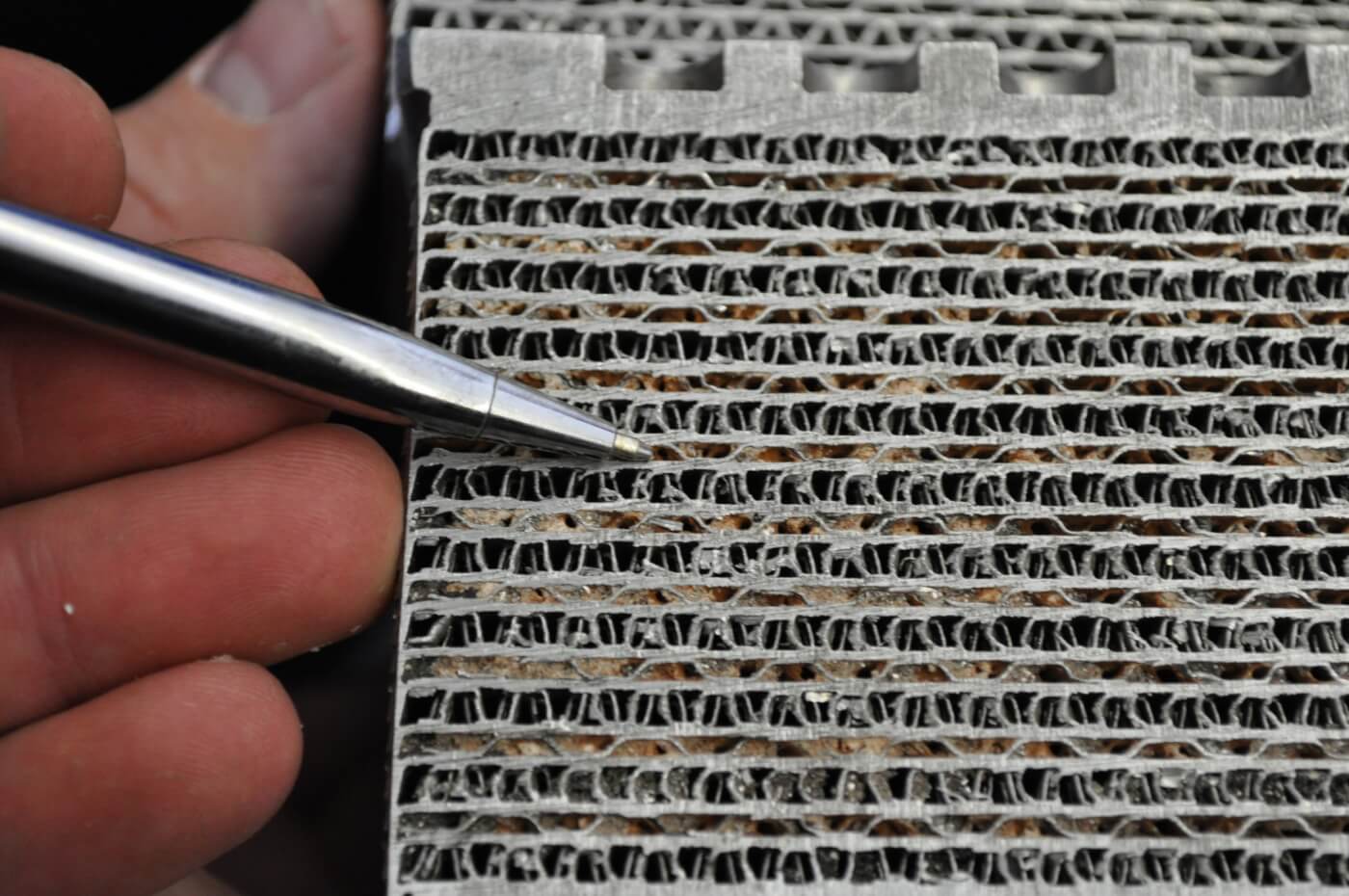

This is a plugged oil cooler because of not maintaing the coolant. The biger layer of passages are for oil flow and the smaller passages are for the coolant. Notice there all plugged up, that is the silicates that fell out of suspension. A coolant filter helps and I run one on my truck.
Ford had a 100,000 mile change interval on it's coolant which has since been revised. Even though it's better to change out to ELC full charge coolant because it's less to maintain, I still run the Ford Gold and just change it every other year. It really is good coolant, but it just needs to be maintained.
