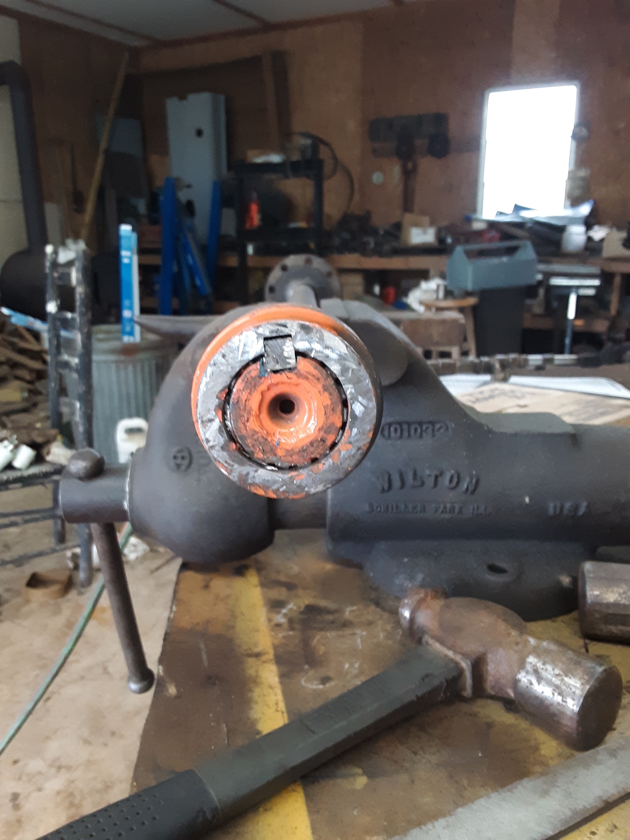

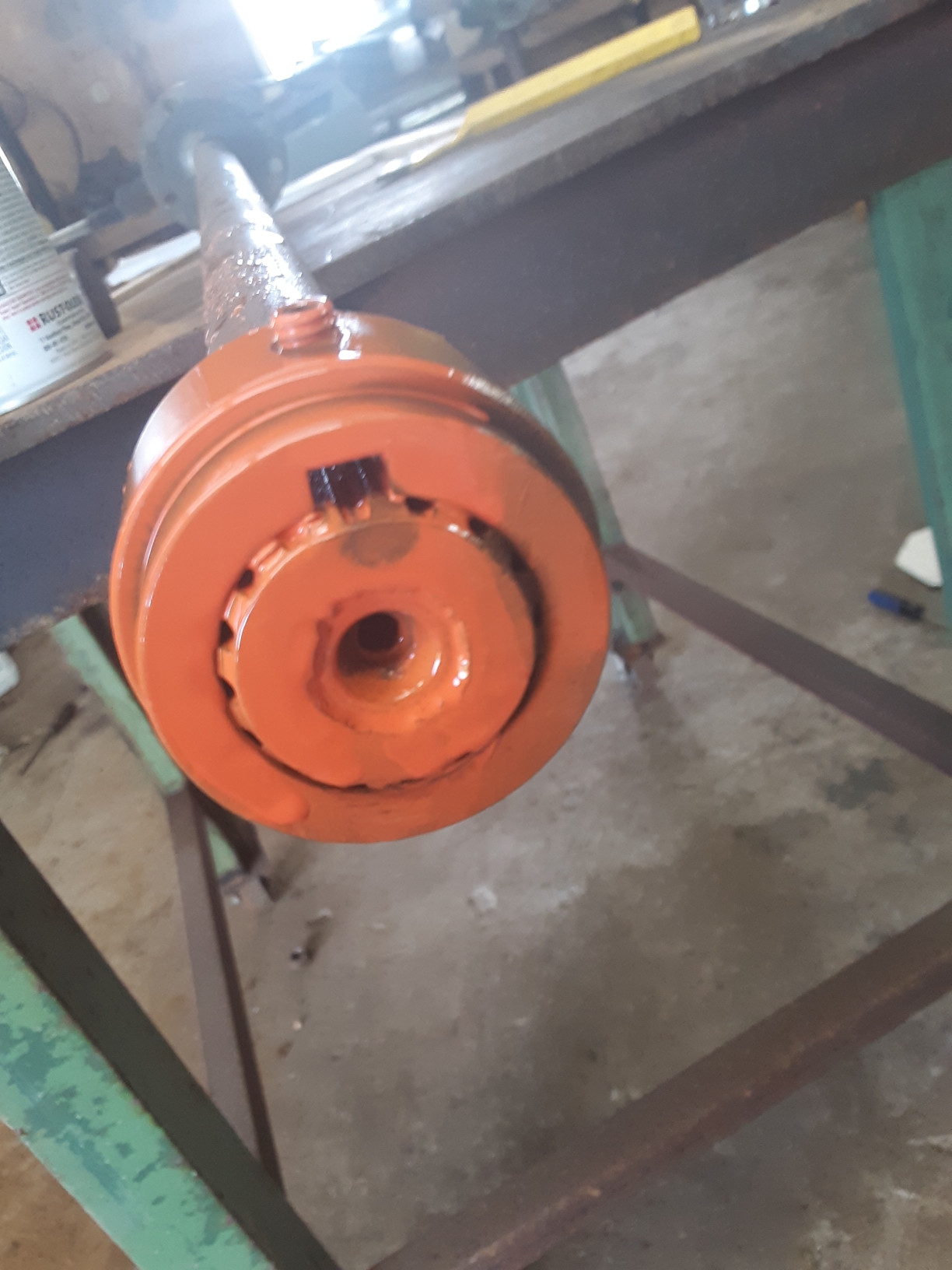

Got me a 1 3/8 bore hub for the end of the axle. The axle is actually a press fit into the hub. I heated the hub with torch and knocked it on with my BFH. Just for future reference, the axle did actully cut some splines in the hub. The splines are tapered on the end of the axle so its not a clean broach cut, but the hub is splined. I plan on grinding the end of the axle splines square so they will cut more as they pass thru the hub. The splines wont be full depth in the hub, but should be enough with the ground out keyway to hold. I sprayed the end of the shaft with paint to mark where the keyway had to be cut. I tried to center between two splines when I knocked the hub on. If I have a steady hand, I should end up with about half a spline on each side of the keyway slot.

I think your plan is going to work well, especially with every spline digging into the hub a little bit.
If you have a mill, in a few minutes you could modify your key stock into a step key- where the key width protruding into the spline's OD is narrower than the key width in the hub. Less grinding on your spline and stronger adjacent spline teeth afterward.

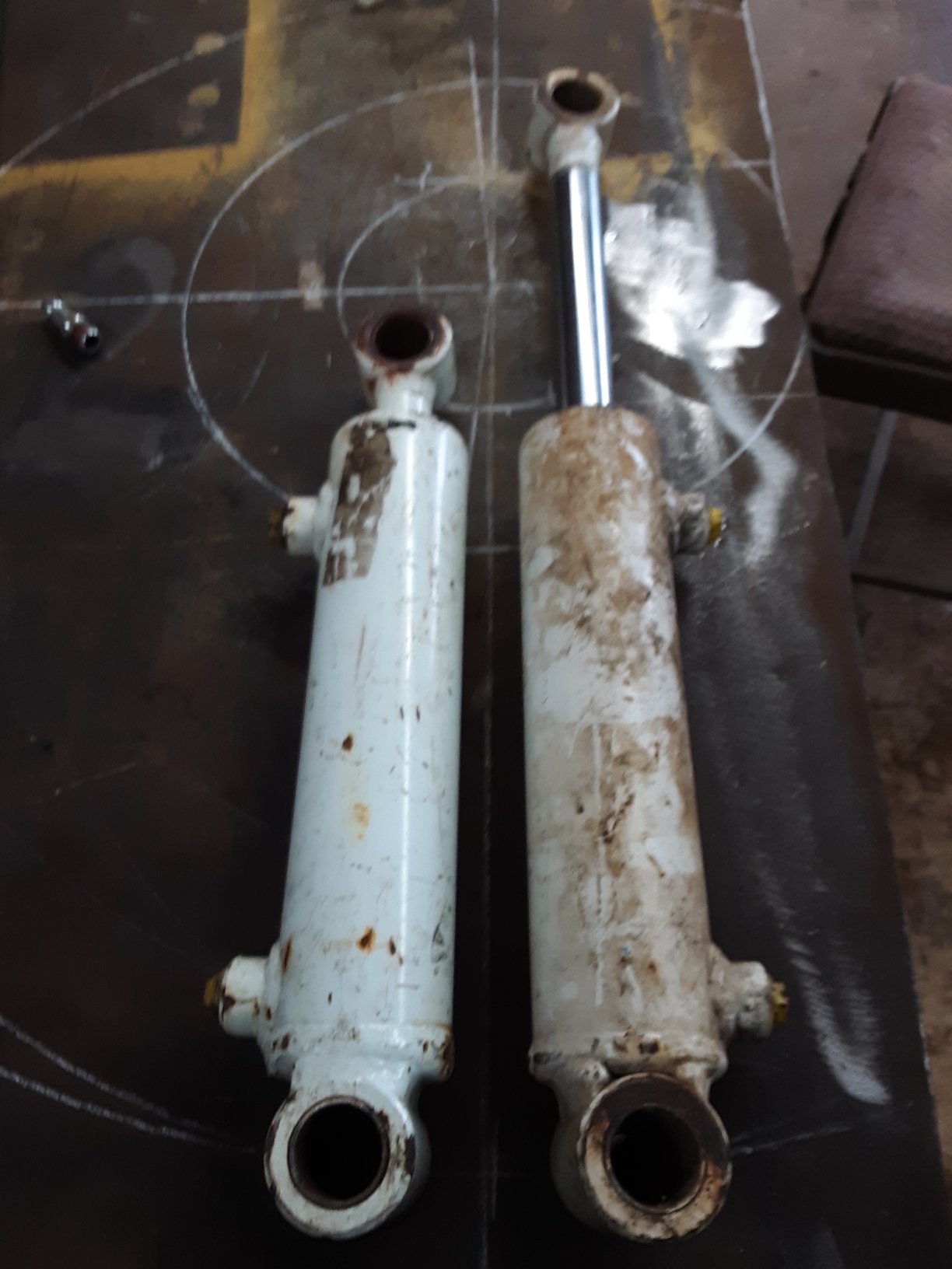

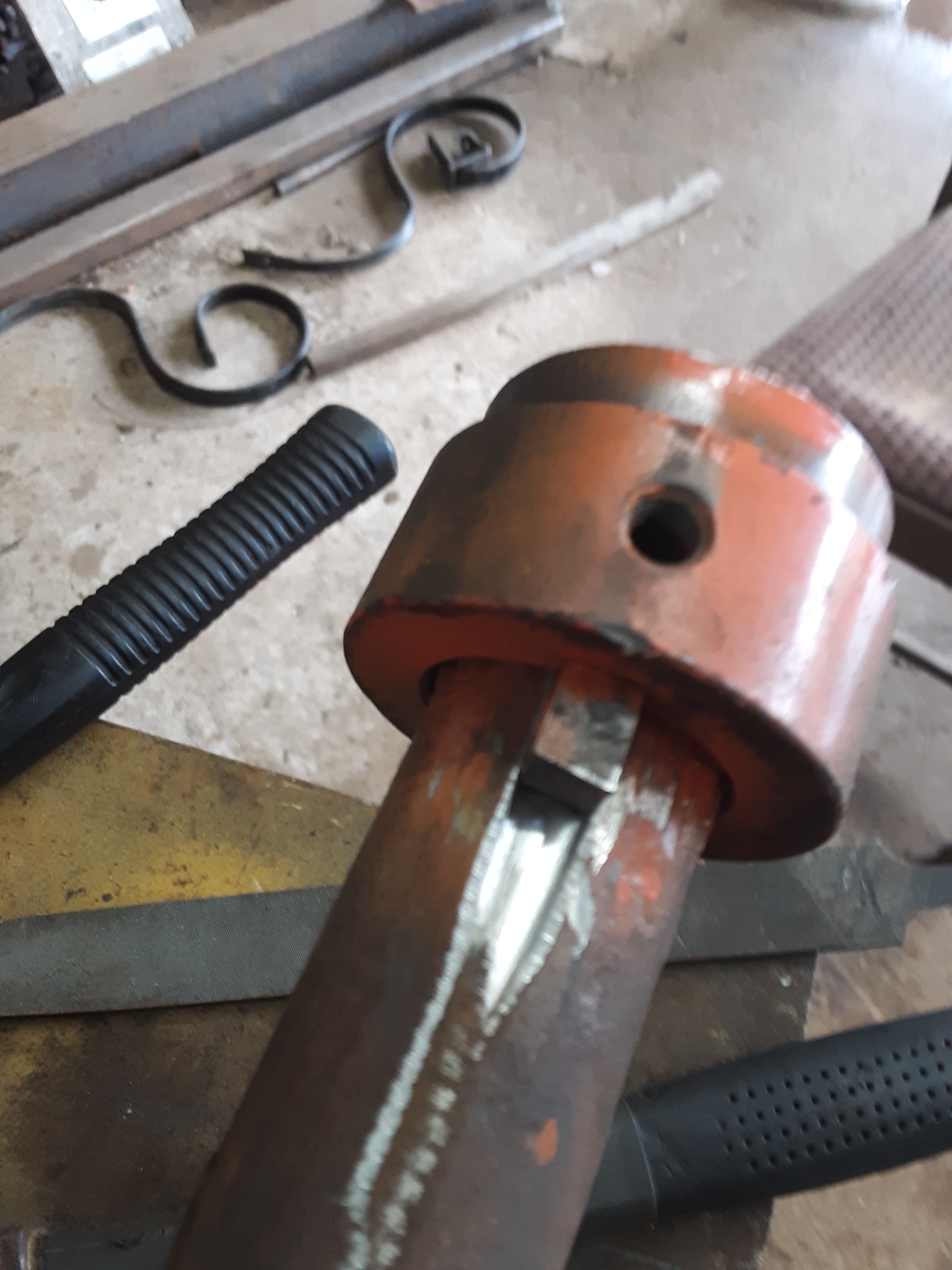

Got the key way cut in the axle. Have to press the hub on the axle, which is a good thing. Then laid out the cyl and drew out a pattern to drill my steering arm. The pic show the cyl on the table laid out over the proposed pin holes. One cyl will push and one will pull.
