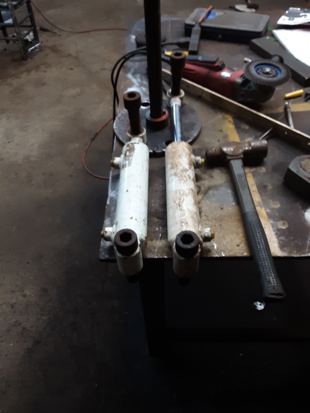

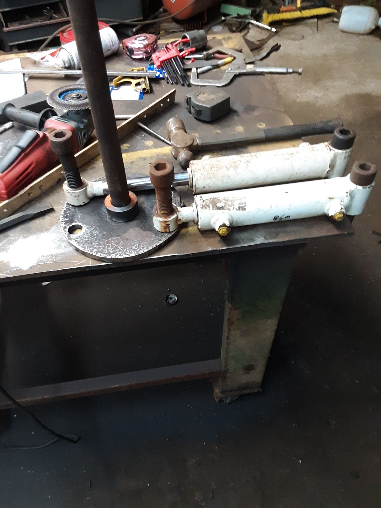

The cyls are laid out the same way they will be mounted, one push and one pull, there shouldnt be any binding. I did change my mounting design. The way I first drawed it uo, both cyl where going to be on the same pin on the steering arm. I was afraid trying to get 180* turning radius I might end up with the boom flipping over the pivot point and trying to go the wrong way. Mounting both cyl on the same end and different sides of center, on a slightly larger circle, the cyl rod will never reach a straight line pull or push. My biggest concern now is whether the 1/2" plate I want to use for the steering arm will hold up.

Got a couple more pic. I finally got around to making the steering arm. Pics show the arm on the axle with cyl in approx position as to how they will be mounted once the boom is assembled. I also got some good news on the control valves to make this mess work. I had found a 4spool solenoid control valve. This provided enough spools to work the dump hoist, the boom hoist and the steering cyl with a spare. since I a mounting this on the tounge of the trailer, I really wanted some out riggers to steady things up when winching and lifting. I called the guy with the solenoid valve and turns out he has a second set of 4 spool solenoid valves. I can take one section from one and end up with a 5 spool valve and a 3 spool valve I will find a use for on another project. I think I have another matched pair of cyl I can use for outriggers, if not my newest best buddy has some I can choose from. This does change my tower design for my boom, but I havent built it yet so, time to scrounge some more tube.
