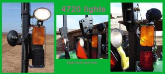

Maybe I got these small enough /forums/images/graemlins/smile.gif
close ups of dual front and dual read add on lights
Dealer put these on for me

Thanks for posting these pictures - I see how the brush protector is used for mounting the forward lights. I was surprised to see that your rear-facing lights are round as mine are rectangular - also, it looks like your dealer ran the cable down the outside of the ROPs where I thought it would go inside. Was that due to the amount of cable involved?
Thanks for sharing the picture - I ordered my lights on Friday and should see them sometime next week. I'll let you know what I find out.
