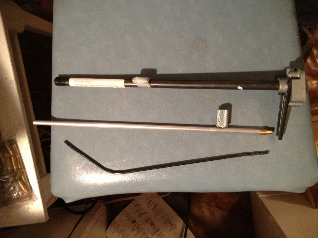

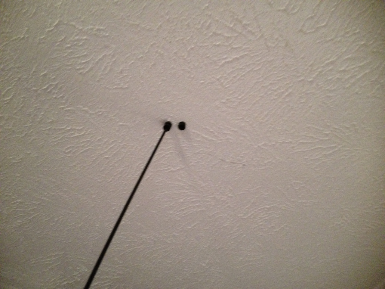

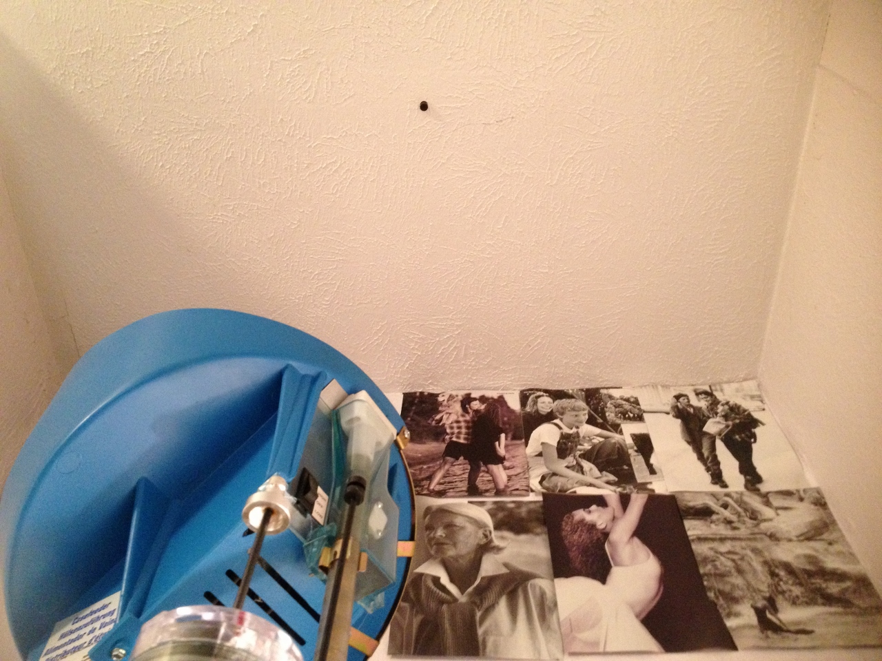

Here is what I did setting a primer in a pocket that was too small. After looking at the case that I taped to the side for posterity I see it was a military 9mm with a swagged primer pocket that was caused by me accidentally mixing range brass with my stock bad me. I knew better I have done it before and detonated the one I was setting but never had a chain reaction like this Dillon called it a chain fire fwtw. Right where the knurled piece is the tube is swelled up and shows roughly how many went off 20 or so.
Anyway regardless how it happens having a primer go off 12-18" from your face is one thing on a progressive it could be up to a hundred yikes but getting a small primer 45 case could do the same exact thing to the next guy maybe even me be careful! Oh and my reloading room used to be my daughters if you wonder about the pics on the wall haha when she went off to college I moved my stuff in left some things like I found them. I even commandeered her desk to mount that loader.
