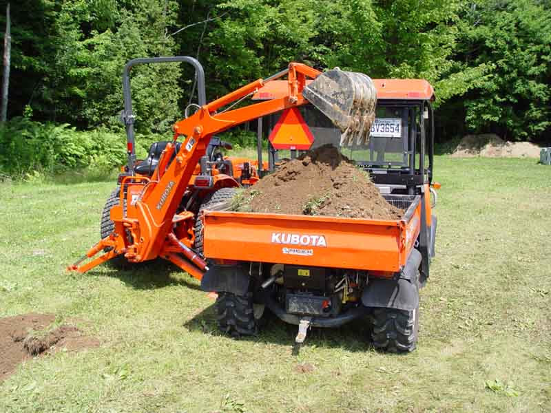

I like the idea of the Toolcat... but how could you load the cargo bed of the Toolcat with heavy stuff if you don't have another tractor around?
As shown on the picture... you can load with the loader too. I moved around 105 000 lbs of dirt and 70 000 lbs of stone dust that way. There are things that you just can't do with only one tool.
