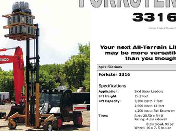

I'm certainly not the expert here and perhaps someone more knowledgeable could comment, but I thought is was common practice for the manufacturers to rate the FEL lift capacity at full height. I thought that the rating is also a factor of stability. It seems that I've read in several forum discussions that the FEL's could often exceed the rated lift capacity at lower heights, and perhaps Bobcat has quantified that. I've attached one example being used by a Toolcat. The lift capacity is rated at 3,300 lbs. at 7 feet, but only 1,200 lbs. at full extension.
