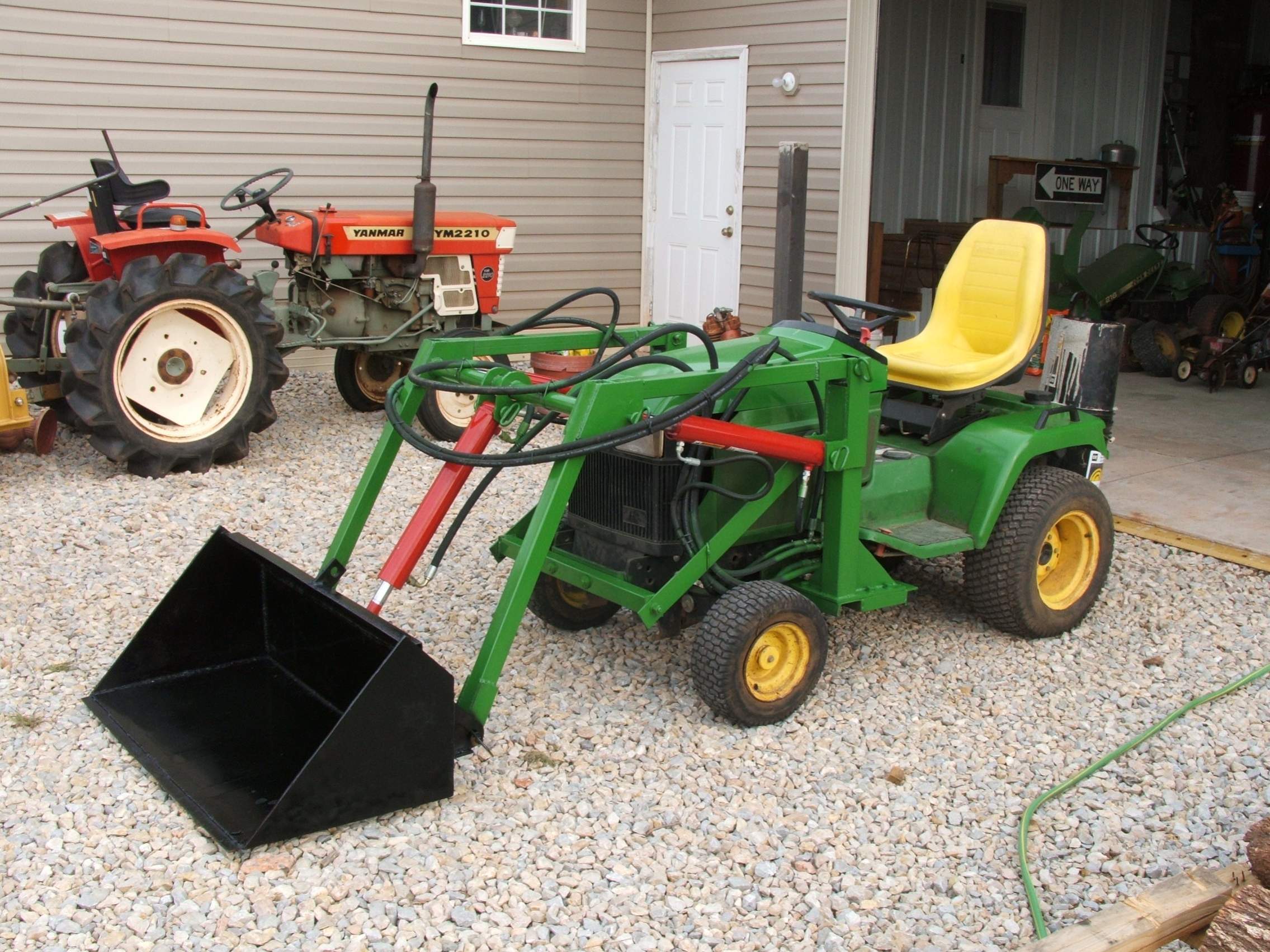

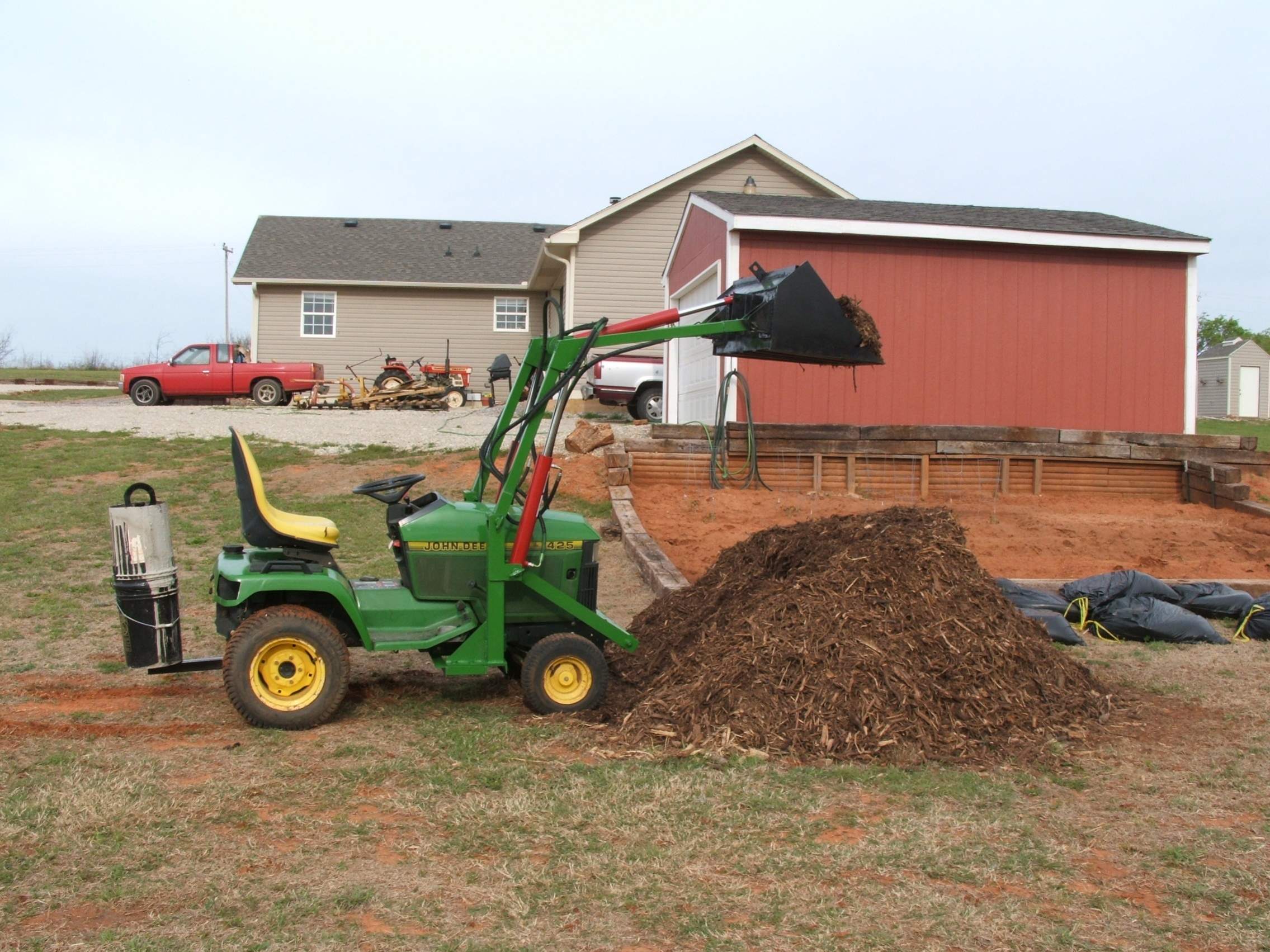

Let me say thank you all, I finished my homemade loader from some srap material and some I bought from the steel yard. I did not have a plan just drew some pics up and figured all the measurements out with a sharp eye. I bought my two boom lift cylinders from Northerntool, I tried to use a cylinder I got out of the trash at work for the dump cylinder but there was just not enough stroke. It was a steering cylinder off a Dynapack compactor. that is the black one in the photos. I ended up ordering another cylinder from Northerntool for the dump. All my cylinders are the same 16" of stroke and are all 2.5" barrels and 1 3/8" rods. Seem to work very well. I put this loader on one of my two John Deere 425 lawn tractors that already had hydraulic system all I did was added the proper hoses and fittings and the loader itself. I lifted a trencher out of the bed of my pickup and have moved several yds of dirt and compost with it since I finished and MAN I will tell you it is the best feeling in the world. I checked out the cad loaders and just seemed I could build one myself for half the money. I built this loader for a little over 600 dollars and it has been money well spent. Hope yall like the pics. Chris:):)

Joes427vette,, the cylinders I used I just picked them out of random looking at the size of rod stroke and diameter, and the length from pin to pin fully extended and fully retracted. I got the measurements out of the Northerntool catalog and then took a piece of pipe and welded basically like pin holes or eyelets to each end. Made two of them, one the full extracted length of what clyinders measurement was and one in the retracted position and those pieces of pipe were what I did my measuring from and it all seemed to work out. As far as performance goes boom raise is about 10 sec. and boom down is a little faster at about 6 sec. I did the single dump cylinder just do to cutting costs. If it did not work I would have gone back and put on a second cylinder but it works just fine. I did have to weld some stops onto the bottom of the bucket were the boom attaches to due to the little to long of travel of the bucket dump cylinder. It would extend all the way out and then go make the bucket roll back under the boom when dumping and was not able to retract the cylinder because it was wanting to go the opposite direction it was really meant to go. The welded bucket stop solved that problem. Thanks to all the nice comments and I look forward to seeing more of yalls inventions and gadgets and whatnots. LOL

Gemini5362, Your correct I did add these braces after I took the first pics. To be honest with you. If you look real close at the unpainted version compared to the painted version they are two different booms. The unpainted version I started with first, made the boom out of 2" X 2" X 16 gauge square tubing. Trying to cut cost U know I figured that would be strong enough for the boom, after I built the bucket I got to thinking it prolly was not stought enough so I wrapped the 16 gauge tubing with 1/4 inch strapping the entire boom. Well then it looked like crap cause I ain't the best welder, Using a lincoln cracker box welder. I have no training in welding, just self taught myself, trile and error. So then decided to buy some 2" X 2" X 3/16" square tubing and build the second boom and it was plenty heavy and works great. I have worked the heck out of this little tractor and have had no welds brake yet. I do need to add some more weight to the rear end, it tends to spin the tires a little when loader is loaded. Fixing to put some tire chains on the rear tires this weekend. Maybe that will help with traction. Well thanks for the looking and noticing the detail.
