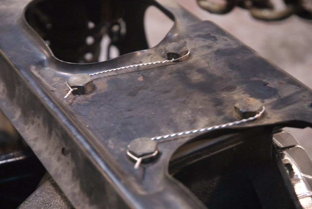

Safety wire?
Did the heads already have drilled safety wire holes?
No, but I drilled them on my drill press, worked out OK and I still had real safety wire from my aviation days.
And have the safety wire pull/twist tool so they also look real pretty, LOL.

As was I baler wire is more like tie wire then safety wire:drink:
I know only a little about safety wire and I've seen it used before, but ... apparently not just any wire can be used as safety wire. I've rarely used it, but if I do I just use what ever is handy including (mostly) copper electrical wire. So, can you enlighten me on safety wire?
   / Front 2nd axle gear=have you seen worse? #40
Peters picture of "safety" wire is a good one, not great but good, the ends should have been doubled back on each other to reduce the danger from the sharp end;
this link has several sizes of safety wire,they also have a brass shear wire.
SAFETY WIRE - STAINLESS STEEL - 1 LB SPOOL | Aircraft Spruce
this was commonly used in canopy and seat ejection systems as a safety to prevent inadvertent use;
SAFETY WIRE - ANNEALED BRASS - 1 LB SPOOL | Aircraft Spruce
Shear wire does as it it named, safety wire would not shear, nothing like shinny safety wire in a seat or canopy instead of the nice yellow shear wire to wake up a pilot or a crew chief in the morning.
And the good safety wire twisting pliers;
MILBAR SAFETY WIRE TWISTERS AUTOMATIC RETURN - REVERSIBLE | Aircraft Spruce
