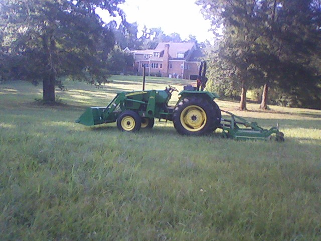

I use a FEL on a JD 5103 with PS 2wd in Ga.with no Problems at all. On a small compact you will need ballast if it doesn't have PS or 4wd. you won't be able to hardly turn the wheel without moveing and the weight in the bucket you will loose your Drive Traction without any counter weight. If you are on alot of a Grade or Hills 4wd is almost a must. IMO.

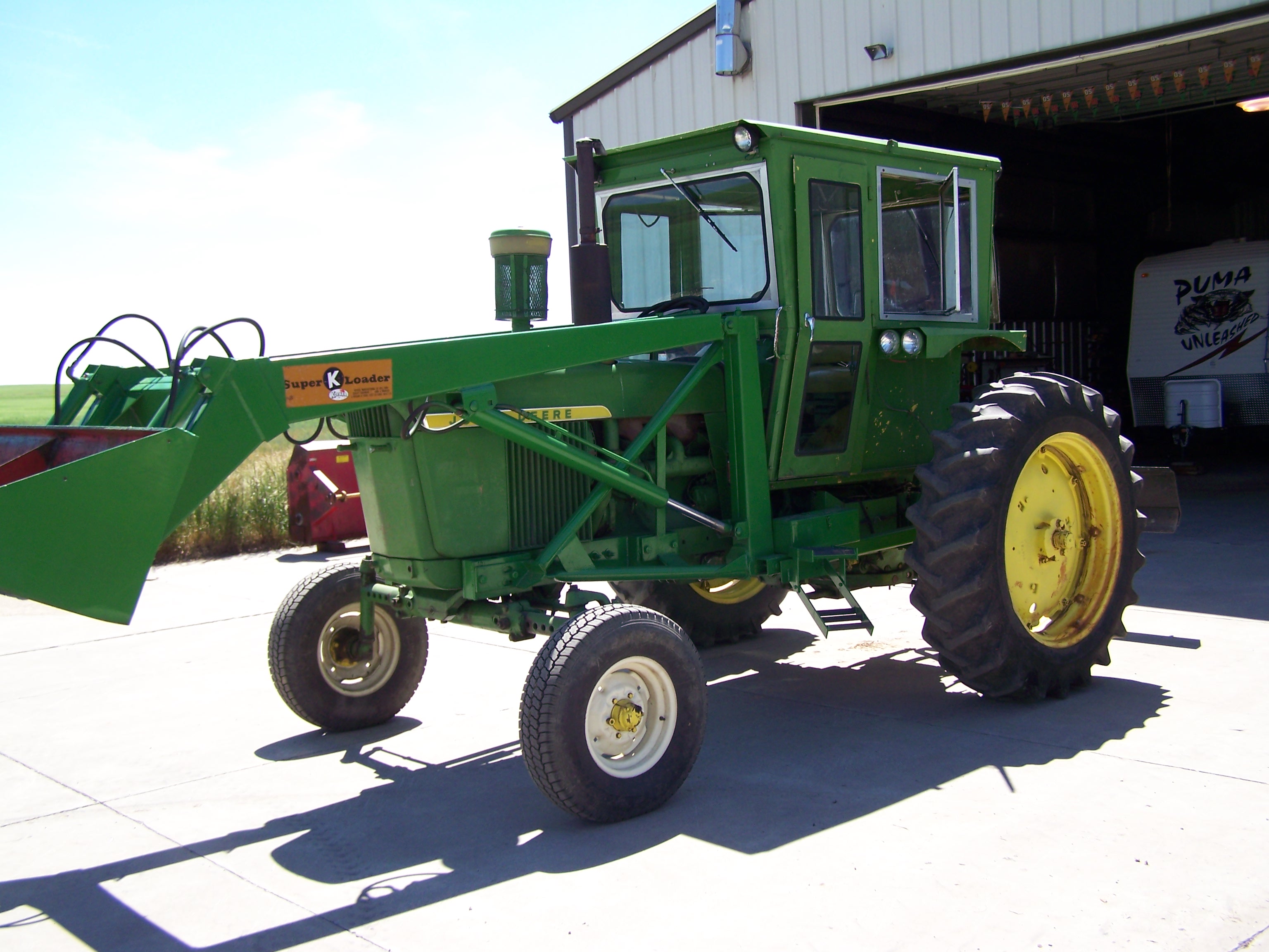

My old 4010 2wd
