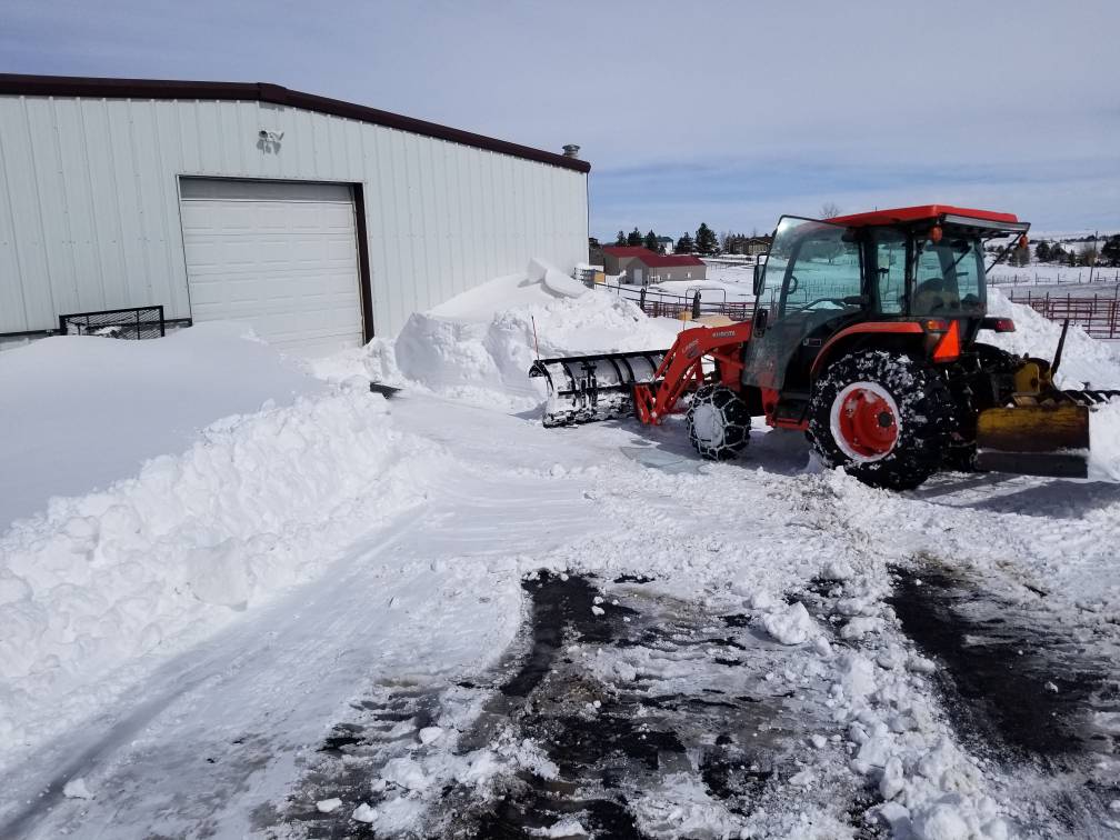

/ Front Hydraulic Blade #10

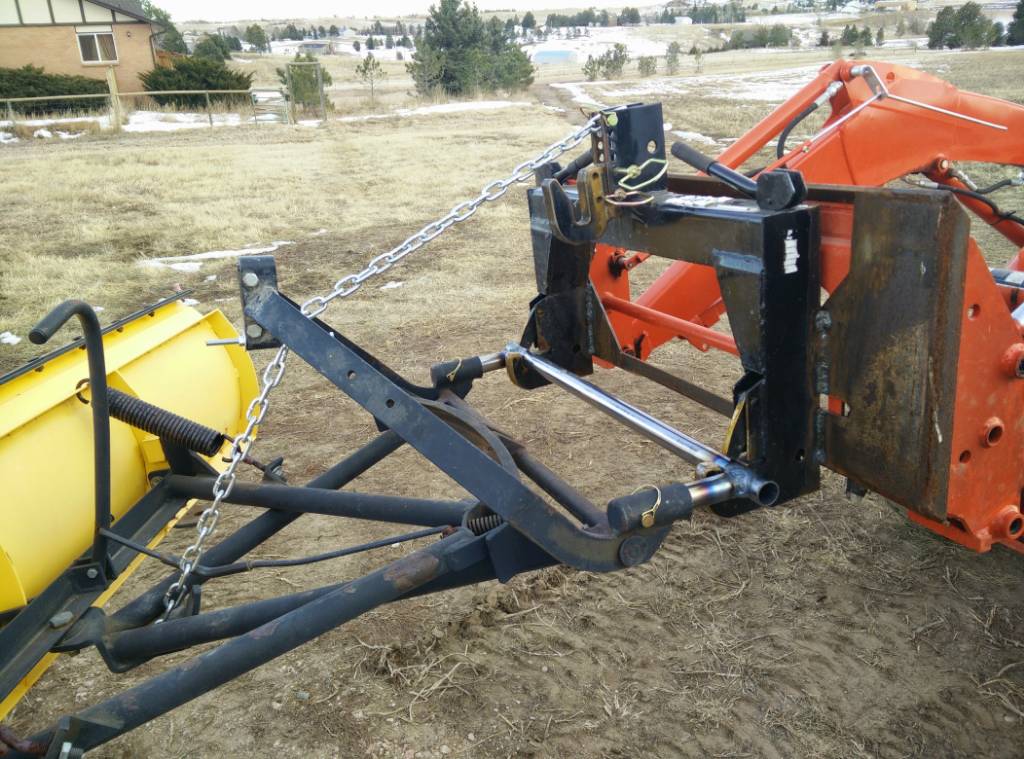

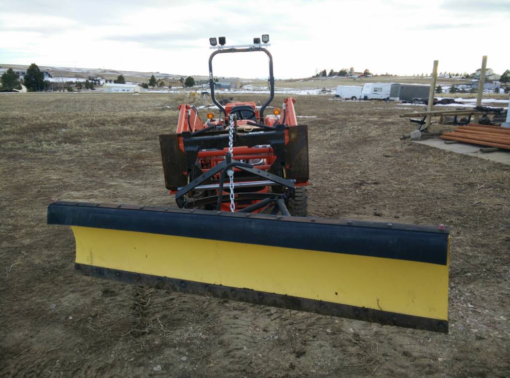

If I float the loader on my L4060 my machine tries to run over the blade & the front is a foot in the air. I really need to reengineer the blade with float between the frame & mount.
My old manual home built blade for my L3200 had float & generally worked good. With plow float I really never tried floating the loader, I expect it wouldnt have worked well either.
Generally plows & loaders are to heavy. Leaving the loader in float puts to much weight on the plow & not enough on the front tires. IMG_20150117_153836-1.jpgIMG_20150117_153817.jpgIMG_20150117_153824-1.jpg20190314_123839.jpg
