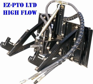

Here is a skidsteer to 3pt adapter, but you could make a frame for the motor to fit on the front of your tractor.
I tried to post a picture , but it will not let me go advanced. It says error on page. A pop up blocker was blocking me from going advance, first time it has done that.

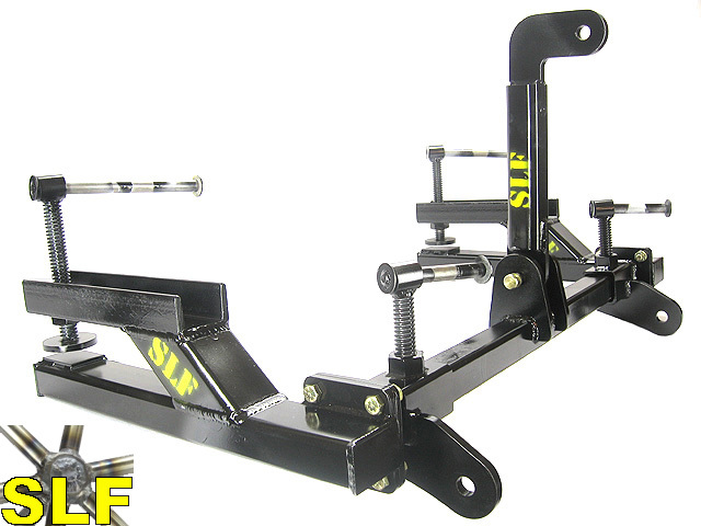

Here is another one that will clamp on your bucket.

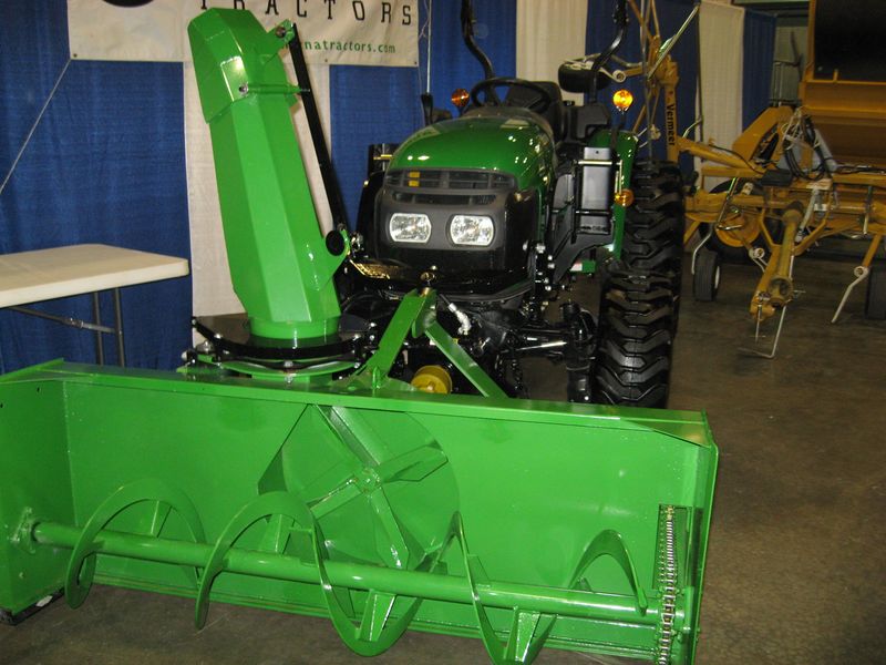

/ Front Mount Hitch #10
Here are a couple pics another member here sent me........ maybe a year or two ago. I believe this was made by Wallenstein. Not sure if it was just a test market, or if it ever went into production. It had a gearbox that ran off of the mid PTO, reducing PTO speed to the standard 540. The display tractor had a rear mount snowblower on it........ which is just one of a bunch of great possibilities. Dunno how much the kit was, nor if it is still available. I thought it was a great idea, but it didn't seem to get much interest here. The pics are of a BX, but my understanding was that they made, or were intending to make these for other popular tractors.

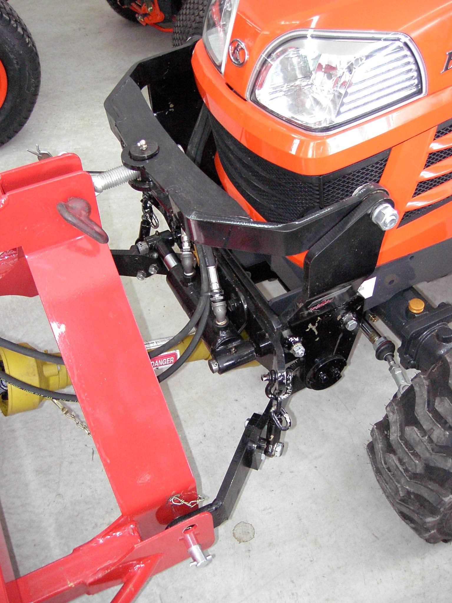

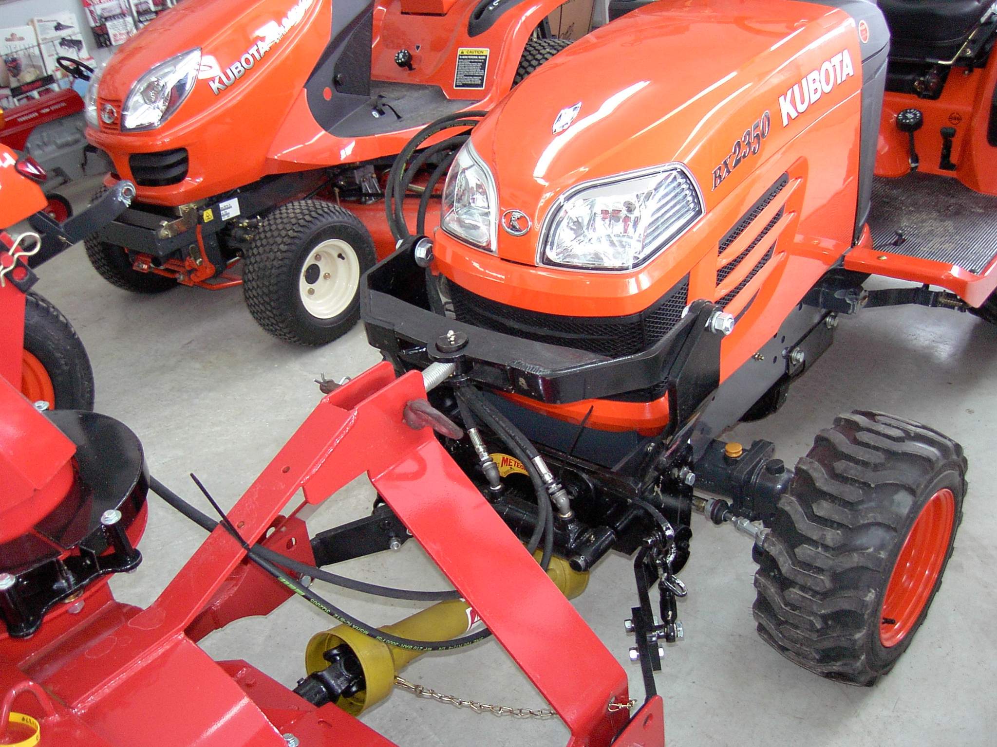

Actually that front mount was made by meteor or MKMartin. My Montana dealer has a front 3pt kit setup on a Montana with a snowblower attached. Here is the link and a couple pictures of the Montana.The Front Mount Kit Expands Compact Tractor Uses

/ Front Mount Hitch #11
My apologies on naming the wrong manufacturer. I was going by memory,and................ well lets just say mine isn't what it used to be!;)
Do you happen to know what that kit costs ?
/ Front Mount Hitch #12
I never did ask what the kit costs but I can see what I can find.
/ Front Mount Hitch #13
Thats a pretty slick set up, other than a snow blower, not too sure what else you would run out front with only 8 inches of lift
