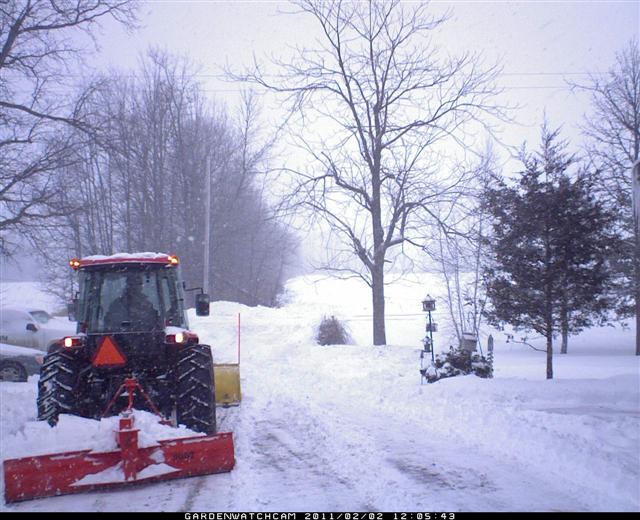

I think the weight of the blade/FEL will give all the down pressure that you will need;changing to a chain lift is a good idea,lets the plow float on uneven surfaces.If you are trying to scape;a rear blade(in tandem with front) works really well;I can scrape down to asphalt with the rear blade.

After switching to the chain the blade floats along the paved parking lots I plow with no problem. Reduced the amount of time it takes to plow my largest lot by half compared to the FEL/backblade combination. I am still able to stack snow fairly high also.
By adjusting the tilt of the blade it seems you can increase the cutting efficiency in the hard and packed snow. By being able to angle the blade from the seat it is much easier to roll the snow the same direction without having to do alot of backing up.
I did not feel the front of the tractor being pushed sideways while plowing so I am not sure how much sideways stress is being placed on the FEL framework.
