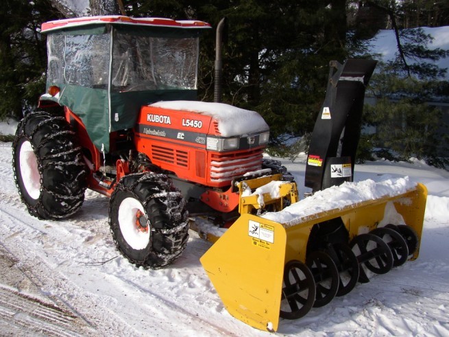

I went with a weather break with my tractor as I already had a
sunshade and thought it would work okay for me.
Once installed I went out and purchased some Plexiglas from a local junk store
and added pieces of glass to the back side with a slot so
I could reach through and change the direction of the chute.
Took about two snowstorms to know that was not going to work
so I added an electric motor to rotate the chute.
I have not added a heater as there is a good amount of heat that is directed into the area from inside the weather break and if the temperature is above zero I am just fine inside. Not as nice as a commercial cab with heat and music, but it works for me LOL
