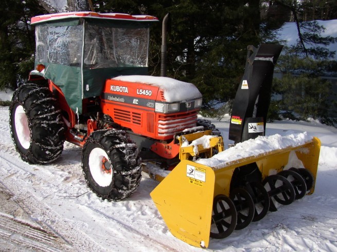

Figured I'd chime in on this thread - I have both a front-mount Erskine and for several years a seven-foot New Idea rear-mounted snowblower. Like YankeesFan I did the golf cart cab thing too. This year there's even a big comfy Laurin cab (I'll report on that after the snow comes).
From using both types I can say that front mount and rear mount each have their pros and cons. The rear mount shines on shorter curved driveways - its easier to feed into tight spots - but there is the side-saddle looking back thing. The front mount has the advantage on long straight runs - the front facing driving position is an obvious plus. But for curved paths the front mount should be a foot or more wider than the tractor - where a rear mount can be just a few inches wider and avoid packing snow down with the tires. The other issue with front mounts is whether they can float to follow twisty sloped surfaces. Some are rigid side-to-side and are best on flat surfaces.

This isn't as nifty-looking as the cab they make for your M59, but here's a stock picture of the Laurin cab model for my tractor. I really like that it is so roomy, about 54" wide inside. It has tinted glass and the Laurin attention to detail is everywhere. Mine doesn't have air - but western Mass summers are reasonable and it has a huge fresh air blower. This older design has flat glass and heavy steel corner posts - For mowing this season I lifted off the doors and back windows. Laurin did a very nice job of fitting to the open-station L5450. This winter it will be quite a step up from my golf cart cover.:cool:

This rig is actually quite decent inside - it's open at the bottom but it gets enough heat from the tractor to take the chill off. I usually don't get to the snow until a few hours after it stops. By that time there's often a clearing NW wind that whips the snow around, especially what's coming out of the blower. That's when the golf cart comes in handy. The only drawback of a plastic tent is visibility through the wrinkles. This winter we'll see if the Laurin cab's windows work better. They should be good unless they fog up.
