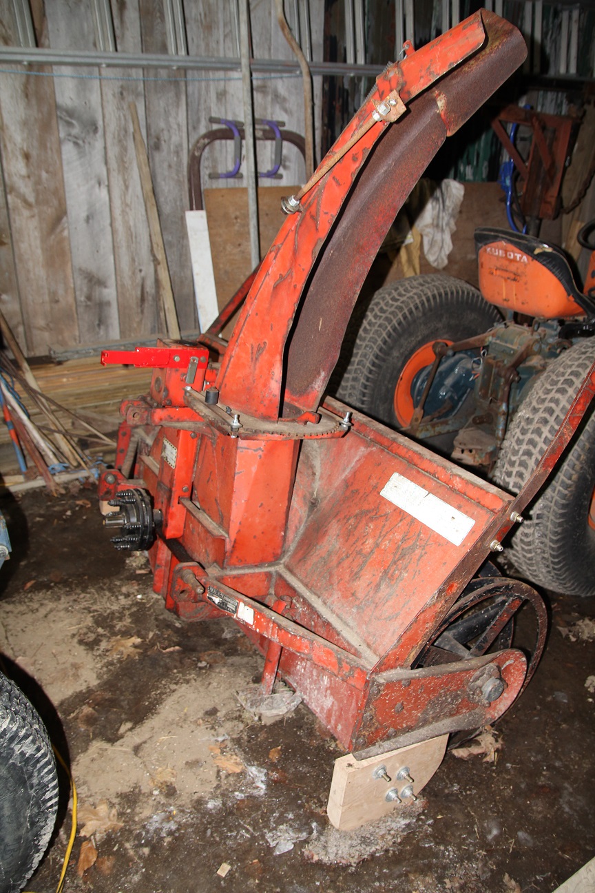

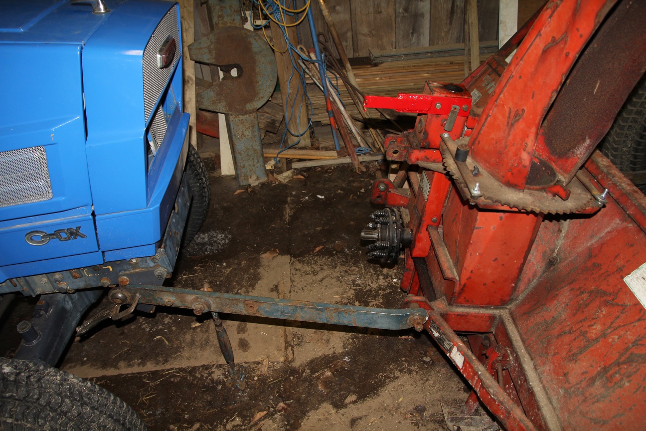

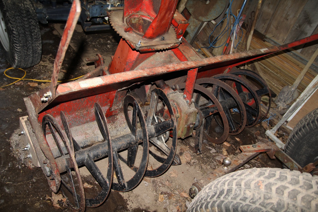

I'm including a few pics of my blower and a "mockup" of how it might look attached to a 3pt on the front of my tractor. Please don't laugh too hard when you see the wooden skid shoes I added :)....they are temporary until I get around to buying or making permanent ones. I had 3 loads of stone put on my driveway last year and the small shoes on the back of it just weren't doing the job of keeping the blower high enough to avoid throwing/pushing stones no matter how I adjusted it.
Anyway, it is an older unit from Japan, not as robustly made as a lot of the N/A models but it is a good little machine. That fact that it is lighter and not as deep as most blowers it's size- it's just under 6ft wide- I think makes it a good candidate for a front mount. I have a pair of 3pt arms like the one in the picture that I plan to use, they are a bit long though so likely I will shorten them.
After digesting the latest info you guys have posted I believe I will be going with a gearbox on my rear pto and driveshaft to the front. It was my least favorite option as I didn't want to give up clearance under the tractor. I like to take logs from the woods and drag them to the yard so a drive shaft could be a problem there. Some kind of an undercarriage that could be removed quickly could be a way to go but would complicate the build...or I may have to switch back to Ag tires!

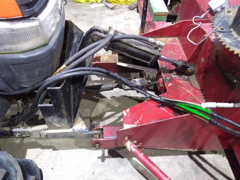

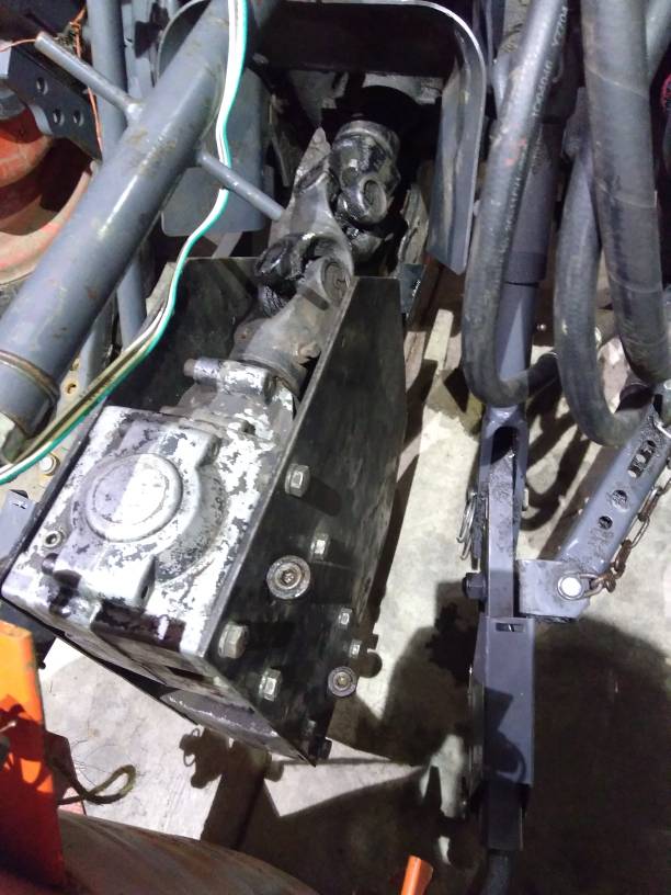

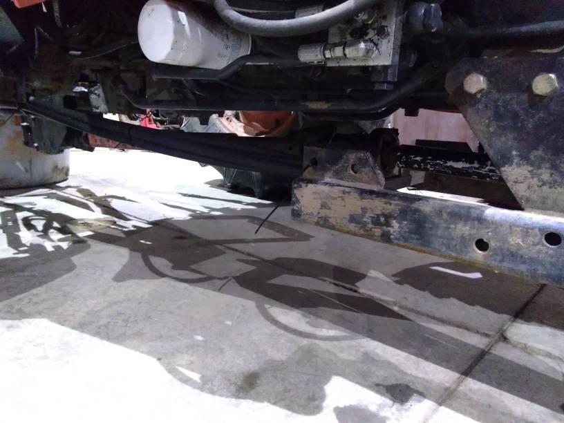

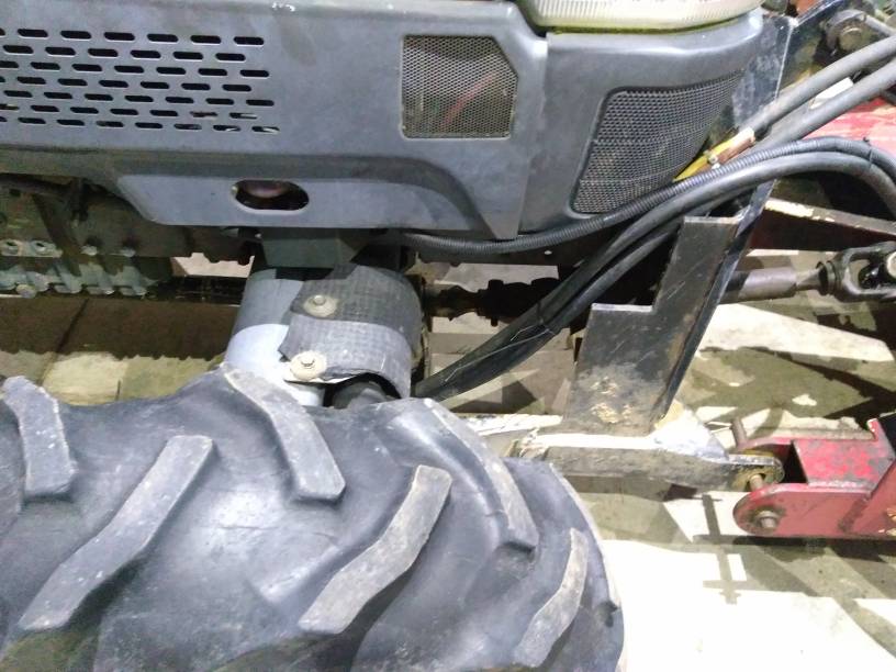

Here are a couple of pictures of how Loftness set up their system (which I modified to work on our L3830:
Front, blower hitch:
Middle under tractor:
Rear gearboxes:
I can take other pictures or explain if you have any questions.
Aaron Z
Rear gearboxes:
Aaron Z
Aaron
How much was the Loftness rear pto gear box?
From your last photo I cannot tell if it is the same as the two gearbox arrangement in my post 5.
Dave M7040

I suspect it is similar to yours, there are a pair of U-joints welded together, then a pair of right angle gear boxes which share the output shaft of one gearbox with input shaft of the other gearbox.
It sandwiches the drawbar to attach it, unlike yours (which as I recall) connects to the top link holes. That leaves the 3 point hitch free for my weight barrel.
We bought the whole setup from someone who had purchased a large New Holland tractor at an auction from a municipality. He wanted to use it to pull a Batwing bush hog, and had no real interest in the snow blower. The catch was that we had to remove it from the tractor and unbolt the frame in his garage with hand tools.
We were the first ones who were still interested after finding that it still had to be removed from the tractor.
A good friend of mine and I got it done in an afternoon and dragged it onto a trailer.
I just used the snow blower on the back for the first winter and adapted the frame for the next winter.
Aaron Z
