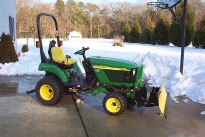

Quick pic: JD2210 with 54" hydraulic front blade. Total cost including hydraulics was under $1,000.

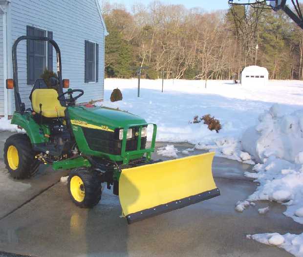

Another of the 54" blade. This is the same setup as for a 4100. The quick hitch is a specific for each model

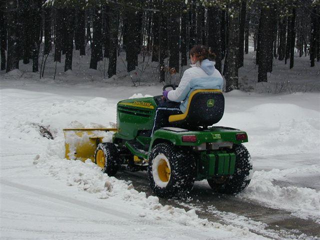

Well, they sell a LOT of snow plows for pickup trucks and most of those are plowing driveways, so I guess if you know how to use one it will work fine. My blade is spring loaded, so I can't do much damage with it. You can control the height of the blade, so that you don't go smacking into things. If you usually get more than 10 or 12 inches at a time, then a blower is probably the better way to go. I can easily push 8 to 10 inches of snow off my driveway with a two wheel drive garden tractor. I imagine a 4wd compact would do as well or better. Notice how clean the area is after it is plowed..
