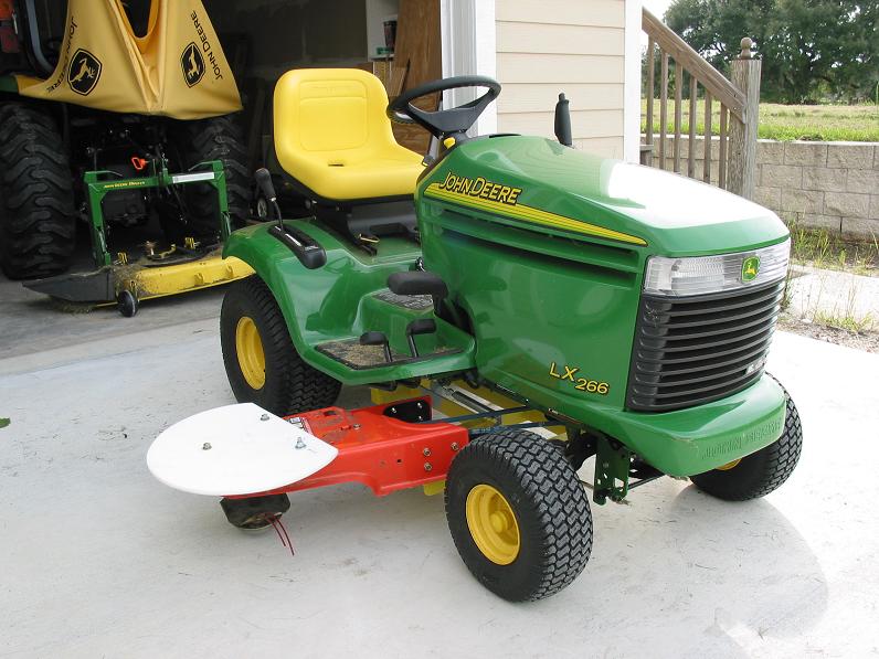

When I first saw your pictures I thought you had mounted the string trimmer head in place of the deflector chute on your mower deck - now I'm thinking, why not? Mow and trim at the same time.
/ Front Weed Wacker #22
Re: My 16HP riding weed wacker
I thought about that, but there were two problems: you'd probably want to use something smaller than this 22" trimmer; and this little tractor doesn't have enough power (on my lawn) for its 42" deck alone, but its got plenty for the trimmer. It's really quick to switch between the deck and trimmer.
I mow with a 72" RFM without trying to get too close to anything, then make a quick pass with the 42" deck to clean up the spots I missed, then pop the trimmer on and attack my fence and ditches. After that, it's Miller time!

Depending on what model tractors you guys have, I would be glad to look at wipping up a batch for you. If we could do enough, we should be able to hold the price down. Besides the JD LX series that I have, I would think the JD L120 they sell at Home Depot would be a natural (like the LX, they have an electric PTO clutch that simplifies the belt arrangement)

Great idea, clean and beautiful fabrication.
Instead of posting pictures, you need to be on the way to the patent office and lock down a patent fast. Then start talking to a manufacturer quickly.
What you have here has the potential to but some people out of business.

Thanks. The neat thing is, unlike some of my ideas, it works as well as I had hoped it would. It cuts foot tall weeds and grass like butter.
