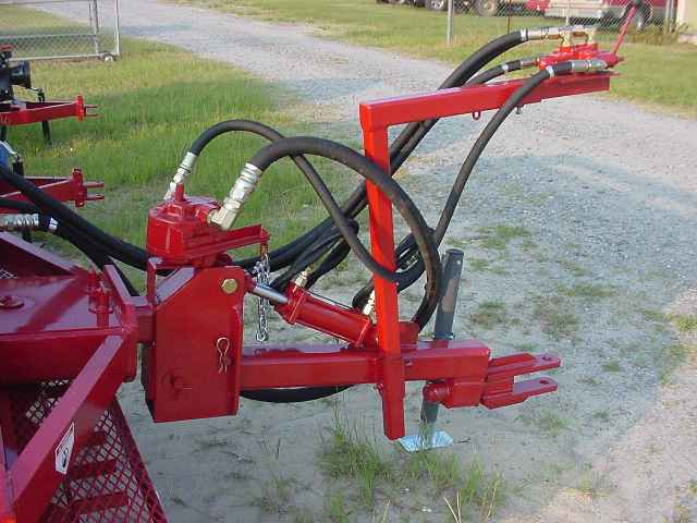

The reason that I asked if it was hooked to the tractor in the picture was because I was thinking the same thing as Egon. If the tongue was as long as it appeared in the picture, then you could possible put caster wheels on the front of the machine. You would need a fair size wheel for flotation in the litter.
   / Front weights
#12
The tongue was built in haste. I plan on making mine more like the one in the attachment. The hydraulic tongue will give me more control. I also want it to be as short as possible to allow for more maneuverability.
By the way Jerry do you use a housekeeper to clean your barns?
Eric

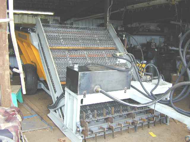

This is the current temporary setup. Let me tell you sitting in front of that tiller with no guard when I tested it out gave me the chilly willys. I ordered the mesh for the guard last week.
Eric
