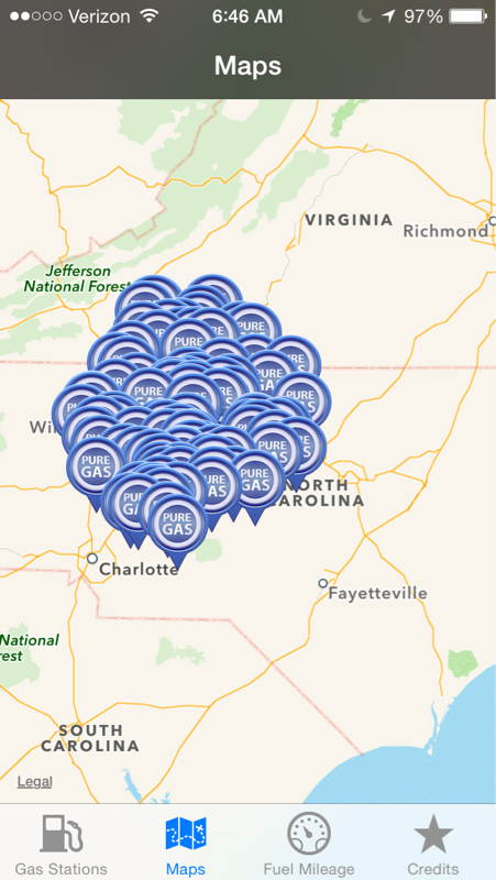

I'm staying in Greensboro NC for work this weekend and just did a search on pure gas. Just look at all the stations carrying 100% gas. This is a wave picking up steam fast as people are just tired of dealing with Ethanol problems. Maybe it's related to how it's produced but some of it is definitely an issue. Now our greedy gov wants us to goto 20% but all the automotive and small engine makers are saying no and they will not back their warranty when 20% is used.
