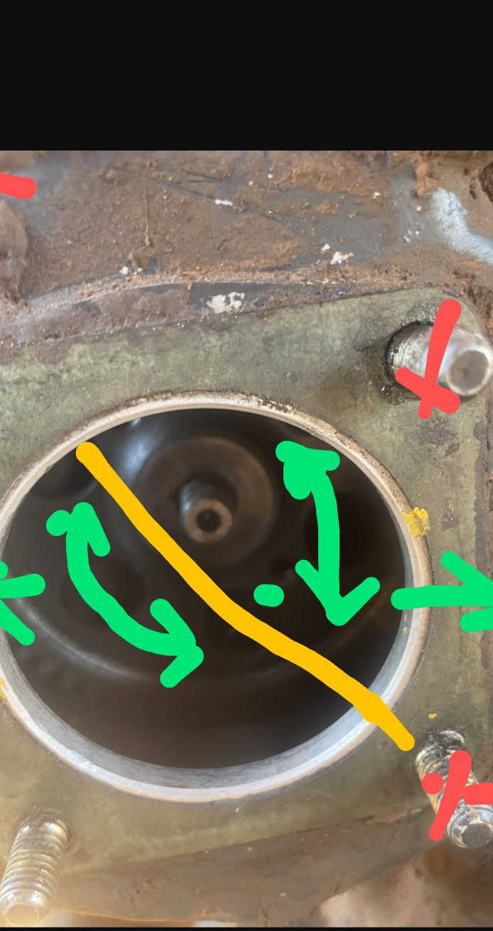

Yes the puller needed is a challenge to find , my brother has several sizes but none would work, he ordered a mini puller we try again Saturday, I am attaching pictures of the round hole puller needs to fit. If anyone knows where to purchase one please share Thank you.

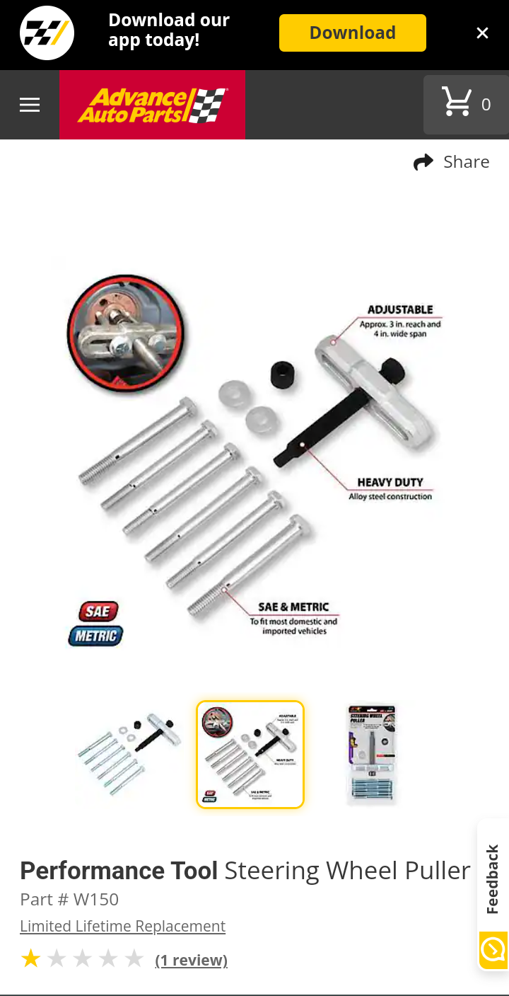

/ Fuel Pump Replacement #27
This should work. You can get it at Harbor freight or like mentioned maybe rent one from auto parts store.

Brother has one and another set, but they are to big and bolts hit sides so they are in a bind. Puller needs to be round. Thanks
/ Fuel Pump Replacement #30
Notice in picture 1219 in attachment? Puller needs to fit in this hole and the 2 holes in the pump. The bolts when using this puller set, won’t go straight and angle in so to put puller in a bind. I went and bought 2 each 8mm-1.25 2-3" and 2-3-1/2 they weren't long enough. will keep you upated, again very thankful for all the help and suggestions.

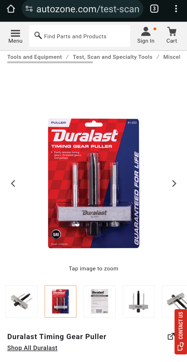

Do the bolts from your puller fit into the gear correctly and out of the 2.5" hole? If they do, this is the time many mechanics and technicals sacrifice the tool and modify it for the specific job-it pretty much becomes a "specialty" tool. My advice is wait for a smaller tool or modify one to fit. My advice would be to NOT cut the engine plates/access hole- at the very least your slag may get into the gear surfaces and may damage everything. These pullers are straight and smaller and should be able to get in that circle and around the external bolts. Will this type work? Otherwise you may have to get a Branson/Kukje specific tool.

/ Fuel Pump Replacement #32
Also, it appears those threaded studs that secure the cover plate are in the way. I think- if you push your IP back into the engine you can rotate the engine enough to bring those hole to a horizontal position and use those smaller/linear pullers.
/ Fuel Pump Replacement #33
*** I also would suggest investigating that white gear timing mark that appears to be factory and use it. If you do turn the engine and not use the factory timing mark or your yellow mark, you will need to make a new painted mark to ensure timing. Good luck, we're all hoping the best. Please keep us posted.
