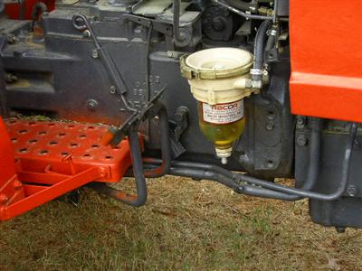

I'd ditch whatever container the fuel was in and use 5 gallon jugs. Also ditch any additives. I'm always careful with fuel too. Stock filters are ok...but you have to service them twice a year or as needed. Sounds like yours were lacking some service. I do have a racor on mine and it's nice to see the fuel with the clear bowl....or the water. In my avatar you can see my racor at mid tractor, it's below the fuel pump so it will catch water easy.
