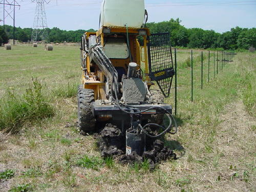

They punched in about two thousand feet of t posts in the bottoms. The clay down there is a bugger bear. Just imagine a clingy personality that's stubborn and generally uncooperative. /forums/images/graemlins/confused.gif
I've found out that a gallon of water properly placed works wonders. That's why you see the hundred gallon propylene tank full of water cinched down on top. When that clay gets all icky poo sticky doo I shoot in about a gallon of water and it's like a divorce decree. We go our separate ways. /forums/images/graemlins/grin.gif

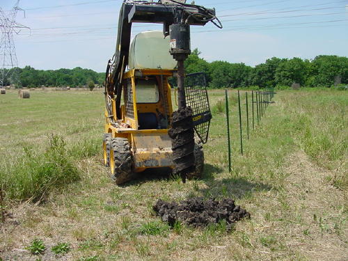

A six foot hole is three times better than a four foot one, you have my personal guarantee.
Fella asked the other day why we were digging the holes so deep down there in the bottoms. I pointed out that the four foot ones someone had set some years back hadn't done so well. Besides that, we could, republican side of me, darn.

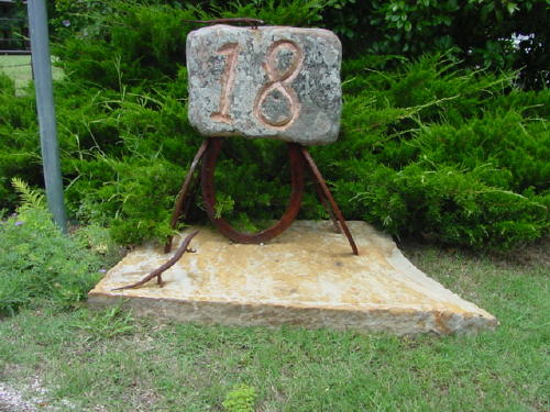

One of the really fun things to do in life is going back to see how things worked out over time.
This morning I got to do just that.
This was a project covered in pages nine or so of this thread.

It's funny how time can be so generous with somethings and really mean with others. It does seem to enjoy aged iron and stone especially.
