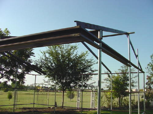

This is a shot of the truss system. It's up but not in place and the cross supports haven't been installed yet.
I wanted to get them up and the pipe welded into place. Locating them after that is easy. It's just a bugger bear getting them up and onto the pipe.

This gives you an idea of what I had to do to pick up the weight of the roof. The cantilever framing was six inch purlins made into I beams with four inch purlins. And from post to post I used an eight inch purlin to carry the bulk of the load.
Right now there's four hundred feet of four inch purlin in the structure. By the time I'm done there will be an additional two hundred feet.
I know that's a lot of metal just for framing. But for the price they're paying they deserve something designed and built to last for a long time.

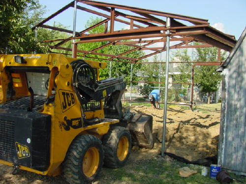

Part of the project was to lay down a geotextile cloth that would keep the gumbo clay and the new select fill separate from now on. We were also to raise the grade so that even in the wetest of seasons the stall area would be dry.
Here's the first batch of select fill over the cloth barrier.
