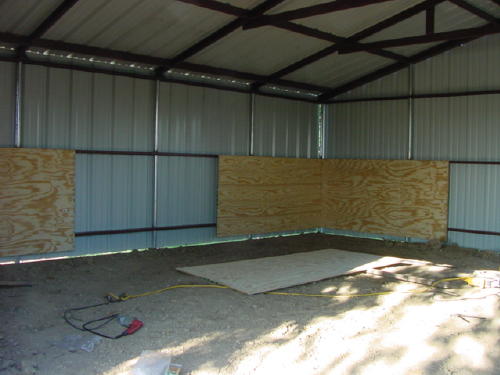

Here's why I like my way to build a metal building. Attaching wood to the inside is a snap. These are 4 by 8 sheets of three quarter inch plywood. I was able to install them by myself using self tapping screws.

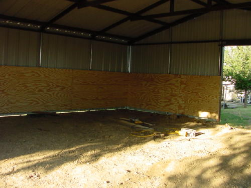

If a window needed to be cut in or vertical framing for whatever was called for it's still a snap. Two by threes like they use for cheap wood fence rails fit between the flanges inside the purlin. This allows toe nailing if required.
This is for horses so a wood barrier is all that's required.
In about a week the trim will be in and I'll post the last of the pictures.

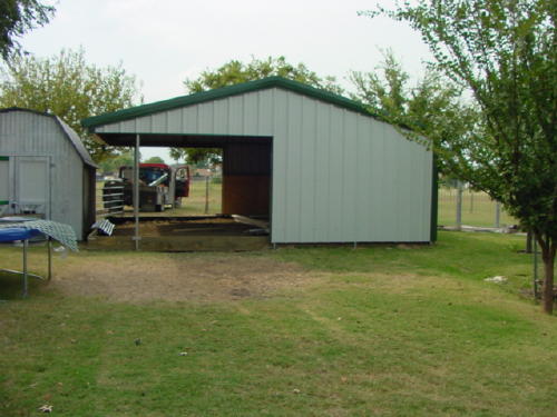

Here's some pictures of the finished project. I took them awhile back but haven't had the time nor inclination to update the thread.

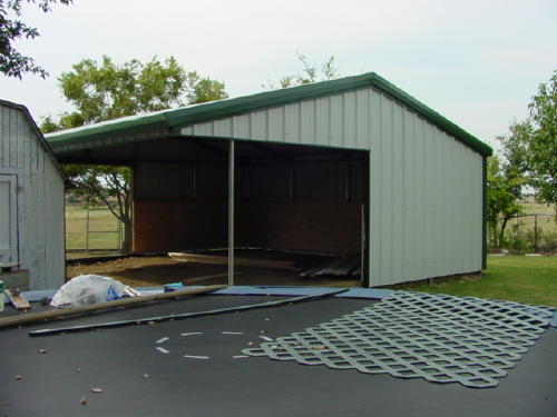

Another view.

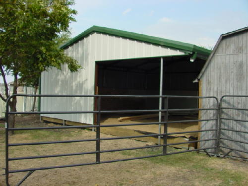

And another.
