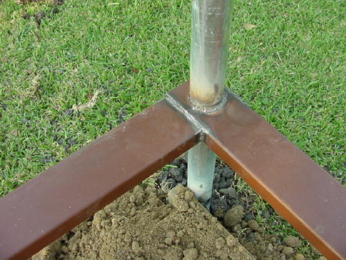

We used twenty yards of select fill. It runs from six inches deep to about a foot on the low corner.
Normally they use what looks like big big staples to locate the cloth barrier. But that wouldn't be worth a flip around a horse. So we dug a six inch deep trench around the perimeter. We also nailed the cloth to the treated lumber to help hold it in place in case the horse decides to be a paw'r.
There's a difference between a paw'n horse and a pa one.

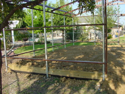

#22
Here's what the roofing framing ended up looking like.

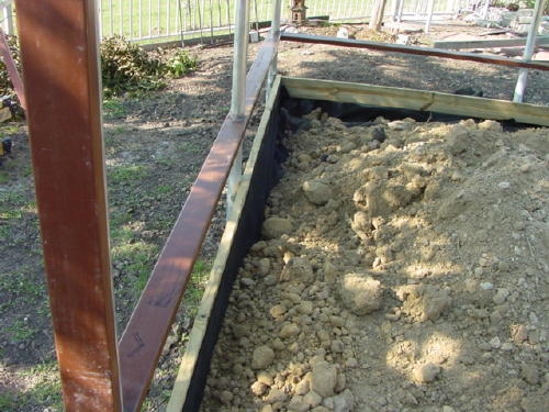

#23
This was after the fill was leveled and compacted for what we wanted now.

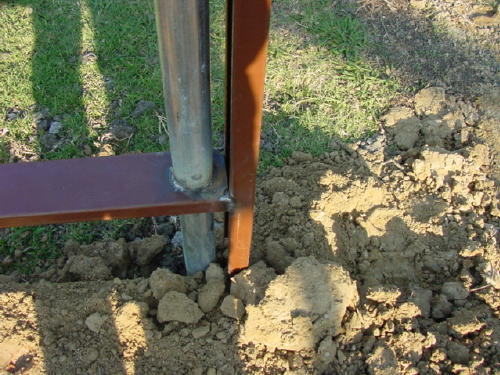

#24
Corner detail.

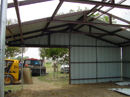

#25
Opening detail.

/forums/images/graemlins/confused.gifHarv,
What are your up right pipes? They appear to be SS from here, or are my glasses in need of cleaning?
And your useing a hole saw may be overkill, but it sure makes a very good looking connection

#28
The posts are regular old galvanized schedule forty two inch (2 3/8") pipe. They're still shiney because they just got off the boat. /forums/images/graemlins/grin.gif /forums/images/graemlins/grin.gif
Overkill is my middle name.
Today we had a good day going until the heat took me out. I used to be able to take the heat and ask for more. But I was on top of the building and my son in law was handing up the twelve foot sheets. I'd get them in place and we'd both screw them down.
It was like being in a solar rotissery. The bright white reflection made me put on sun glasses which I never wear. But I couldn't see without them.
So at one thirty I called it a day. Tucked my tail firmly between my legs and headed home to cool off. Tomorrow's another day. /forums/images/graemlins/blush.gif

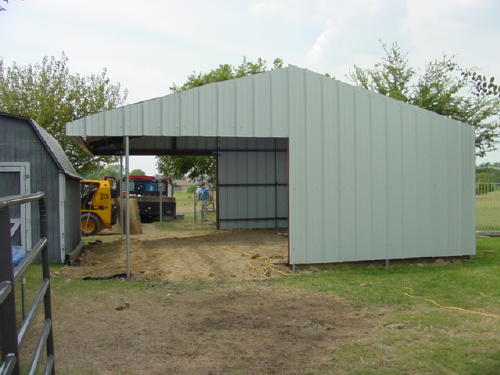

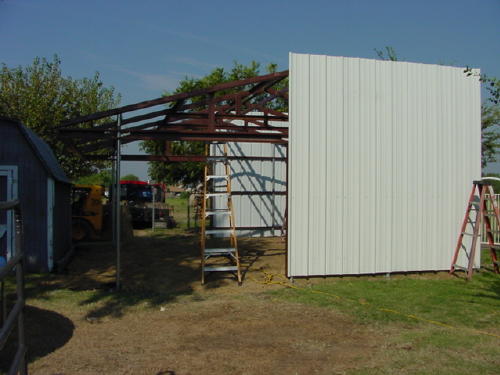

Here's a shot of the twelve feet sheets before cutting on the ends.
   / Garage--barn--shelter--building built my way
#29
We got really lucky with the sheets. It seems the cutoffs worked on the opposite corner side without additional trimming. /forums/images/graemlins/grin.gif /forums/images/graemlins/grin.gif

#30
I've been sun sick so many times in my life. In my youth I'd reach down and grab a lower gear and keep on moving. But in the last couple of years the lower gears haven't been there.
Here's where we stopped.
