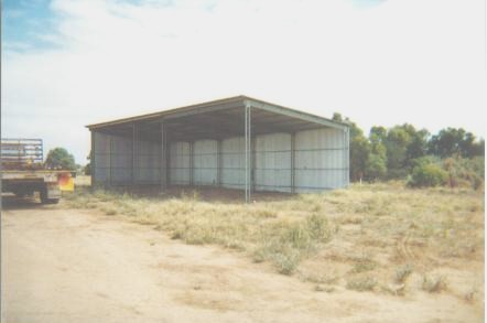

Are the purlins and the roof frame some sort of c section ?
Some years ago i built a skillion roofed farm shelter using exhaust pipe laminated together
For memory there was 5 pipes together and they span about 24ft as roof beams
The reason i used them was because i got 1/2 a ton of it real cheap,
Laminated together like this make unbeleivably stong beams
