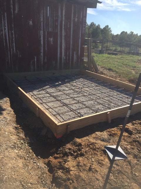

Just install the rebar yourself and use as much as you want. Then let them pour it. ImageUploadedByTractorByNet1475150103.865183.jpg
9.25" pad with fiber, rebar is on a rough 12x12. I didn't fuss with exact measurements just got close. Besides I ended up short 10' so I just devided the remaining section into what I had left. ~15x12 grid. Just poured yesterday so will have to wait to see if it cracks.

What made you go the 12x12 route? Is that #4 or #3 rebar?

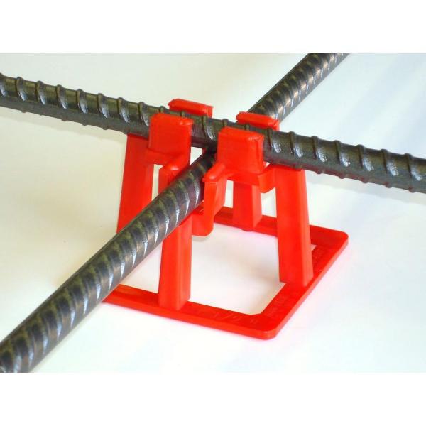

I am going to try this rebar chair instead of using blocks and wire to tie the rebar.

Number 4.
That pad will be home to a feed bin. 7 tons sitting on 4 or 6 legs. I wanted strength. Also added fiber into the 4,000psi mix.
Couldn't find chairs locally to get me close to center of a 9" pour. So drove 24" rebar to 4 1/2-5" then tied to it. Didn't take long at all. Couple hours by myself and that included cutting the rebar.

For strength the rebar should be near the bottom of the slab. This is the tensile stress region of the slab
For crack control the closer the rebar spacing the better, concrete will continue to crack until the crack hits the rebar

The Hercules rebar chair keeps the rebar exactly 1.5" inches from the ground. They are made for 4" slabs. This keeps the rebar down low in the slab, where it needs to be.
