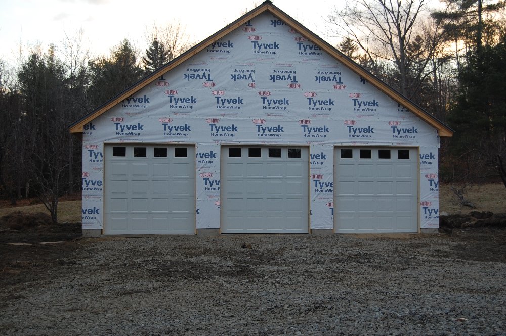

We built ours 3 years ago. It's 30' deep with 2 10'X8' doors and 1 8'X8' 16' deep for the future UTV. We both drive GMC 2500HD crew cab 4X4 with towing mirrors. There is 2' between the doors. If I had to do it again I would go with 12' doors. There is enough space that I don't hit doors but it is a little tight with the wide mirrors. The 8' height is fine.

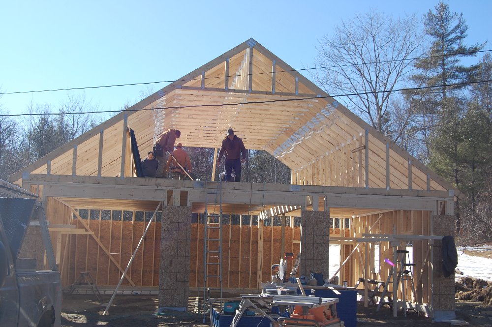

We are in the process of building our house/garage The garage is 36w 30d 10h We did 3 9x9 doors.
I would suggest attic trusses. We have a 2nd floor room 20w X 30d for storage. The extra cost for the attic trusses was very little.
