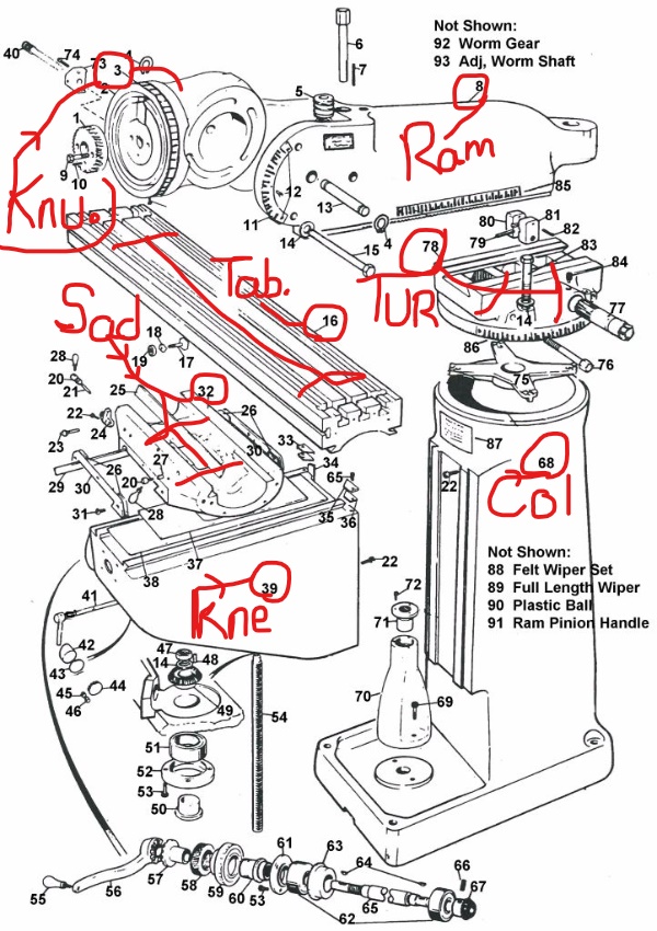

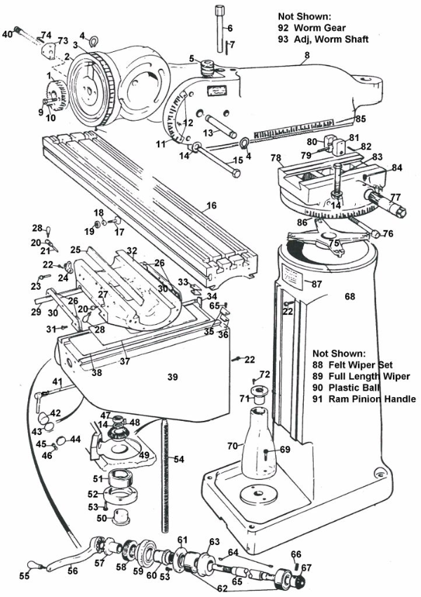

Here are some exploded views of a Bridgeport Knee Mill.
BP Base Exploded View.png#3 is the knuckle, #8 Ram, #78 Turret, #68 Column, #39 Knee, #32 Saddle, #16 Table.

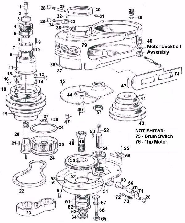

BP 1HP Drive Exploded View.pngThis is the step pulley drive system my mill has.

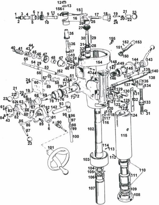

BP Quill Housing Exploded View.pngThis is the lower part of the head which contains the quill and feed mechanism.
The knee is the only other part to get painted. The table and saddle generally don't get painted but they get enough oil on them so rust isn't a problem. I have to admire what the old timers designed here. They covered a lot of complex operations but kept it simple enough even I could reason it out.

Now I'm getting the idea, I took the test and scored a 100!!!!!!! I never thought I could do that could on a master machinist test.
I hope I wont loose any sleep this fall when I see this is all fixed up, knowing that part 68 didn't get painted underneath......:zzz:
