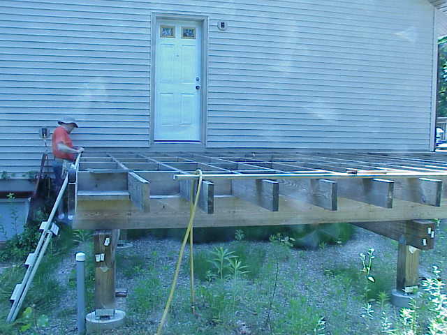

As for the plans, I am serious about wanting a copy of them. I wouldn't ask if I didn't feel that they were worth considering. I am old, but still young enough to learn. Besides I need a lot of outdoor furniture for the new deck. It is in the final phase... this section is 38' X 18'... more wood than I want to handle.. ... .... /forums/images/graemlins/frown.gif I didn't have to have plans to build the deck, just money to pay for the permit. The building inspector called about 6 months after I purchased the permit and asked what stage I was at and if it might be finished. I told him that I had the piers in. A year later he called and I told him that I had the framing done.... well almost... This year I am finally planning on finishing it. I don't believe that a deck should be rushed. I started the main part of the deck 15 years ago. Life is too short to rush... besides, it gives me something to look forward to working on every summer.... Thanks to DYI Guy, I am making major headway towards completion.... sure goes a lot faster when you have a second pair of hands.... especially when the second pair of hands know what they are doing.... /forums/images/graemlins/grin.gif /forums/images/graemlins/wink.gif /forums/images/graemlins/smile.gif I had the wrong settings on the camera, so everything looks blue.... /forums/images/graemlins/frown.gif
