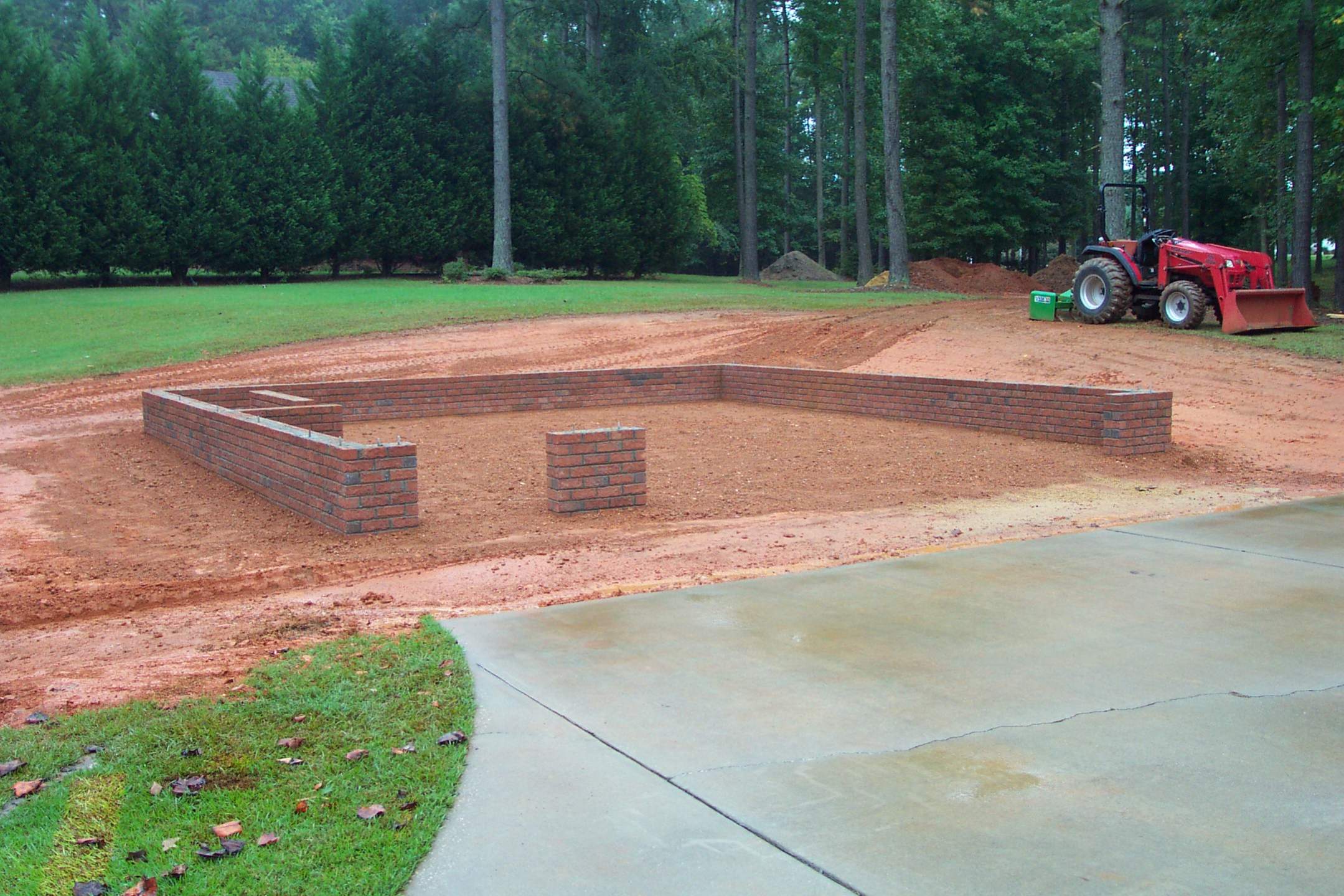

2 hours with a jumping jack this afternoon....holy crap.:eek: 2 more tomorrow morning will have everything that was disturbed banged in good.
(Note to self: wear gloves tomorrow.)
I have a few spots I'm concerned about compaction on the perimeter. In those spots I have stacked brick from the footing up to near slab grade.
/ Garage project #57
In the past, I have also dug a couple trenches from the back to the front of the garage and poured concrete in them, then brought 12" solid block up to the bottom of poured concrete height. Kind of like a supporting wall in the middle of the garage. Then I span rods across the supporting wall all the way over to the perimeter walls and drill them in. I did this for a guy who parked a couple Mack RM series tandem dumps inside and needed a really heavy built floor.
It has never cracked. If it did, I'd never hear the end of it since I borrow a 15 ton backhoe trailer from him all the time. :D
/ Garage project
#58
She's out of the ground and ready for wood. Time for the fun part.
