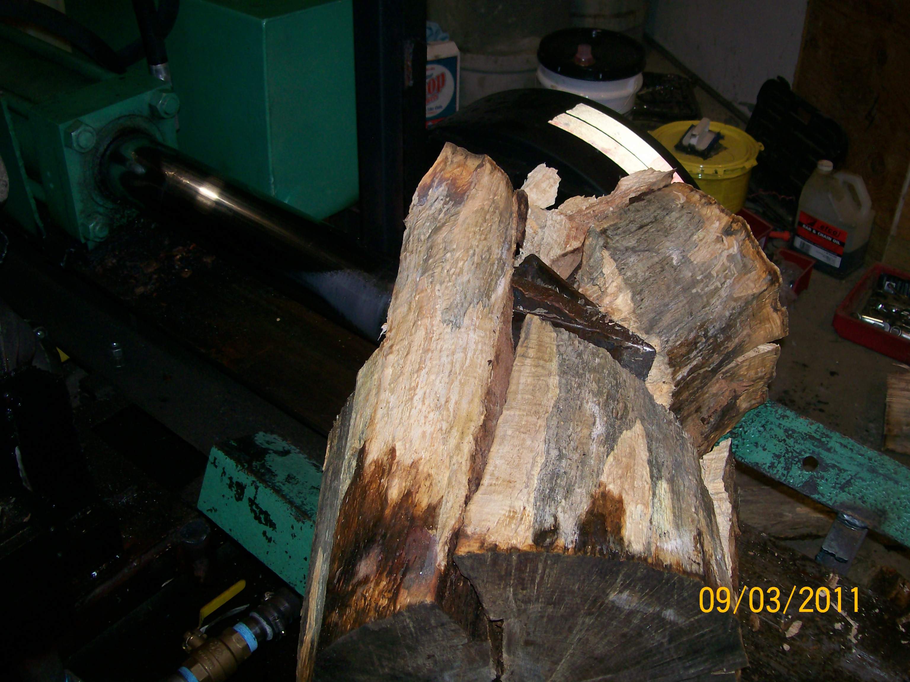

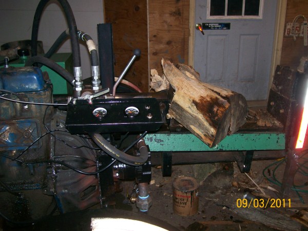

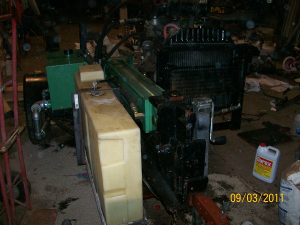

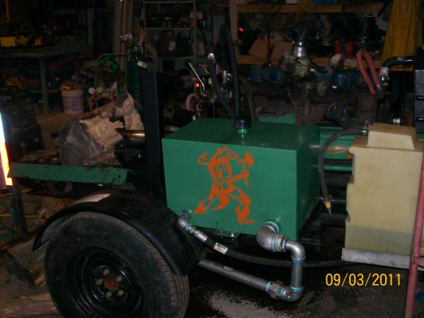

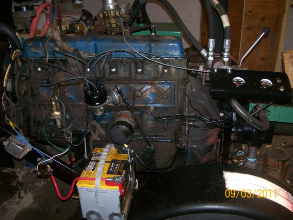

Ok... I finished it for the most part, Still don't have my filter, I called, and they said tuesday. I still had to play with it a little. As you can see from the pictures, I split a 16" sugar maple down the center nicely. The best part, though, is the fact that I sheared one of those halves in half cross grain. 1/2 throttle, and it didn't even grunt. Even better, I haven't turned the releif on the valve up any, it is still set at the factory 2000 psi, I have another 1000 psi to go if I want.
So, it appears that I got everything that I was after in my splitter project, speed-5 seconds to full extension, and 3 seconds return at 3/4 throttle, no load. Makes for 8 second cycle time. And plenty of power to spare. And as for that "knotty crotch" I have been ribbed for saying, I found one in my pile, an apple tree stump that was cut this summer.

Just curious, what size oil reserve do you have?
   / garbage truck pump on logsplitter #36
Using 2000 psi, 2.5 is shaft, and 7 in bore. recomputed the tonnage at 38 tons, still a lot. I am guessing at shaft size.
#37
Crazyal, unfortunately, it is only 21 gallons. That is the reason I installed such a large oil cooler from a concrete truck directly in front of the radiator and engine fan. If that doesn't seem to be enough, I will install another cooler, this one has a port to connect another to it. I don't want to change the resivoir, because a larger one will not fit without totally reworking the frame, and sourcing a wider axle.
JJ, To increase the pressure from the valve, I turn the screw under the cap clockwise, correct?
   / garbage truck pump on logsplitter #38
Yes, but I would tee a hyd gage to the IN port to set it correctly.
What is the shaft size, I was guessing above.
#39
JJ, The shaft size is approximately 3.5".
I weighed it at the truck scale today, It weighs in at 3080 full of gas and hyd fluid. When I am totally done with it, It will therefore weigh something like 3400 lbs.
I am looking for a hood from a 9-2, or 8N ford. It doesn't have to be pretty, but not flattened from being run over by a truck, either. If anyone has something in WI, MN, or ILL, please PM me. Just can't see paying $350 for a new tractor hood for my splitter.
   / garbage truck pump on logsplitter #40
Using 2000 psi as the pressure limit, the splitter could push with a force of 38 tons.
Using 3000 psi as the pressure limit, the splitter could push with a force of 58 tons
What is the GPM's of the pump, and can it pump up to a pressure of 3000 psi.
