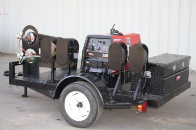

Why do so many welding trailers and welding rigs have the cylinders on an angle? I understand that typically O2 and some of the inert shielding gas can be tipped. But the acetylene is a whole different deal. I just modified a skid that my welder is on and put the oxygen at 45 degrees and I kept the acetylene standing straight up. But it makes me wonder why I see so many trailers/rigs with BOTH cylinders angled.
Look at this photo, they have these cylinders tipped even further than 45 degrees. Has something changed with acetylene cylinders or maybe folks are running propane instead of acetylene?

Looking at the trailer, I’d say it was for tank stability. Loading and holding tank for transport, that’s a great design. Lower overall height for wind resistance while protecting valves.
   / Gas cylinders on an angle? #3
Just a guess but I suspect the main criteria is to prevent liquid from entering the valve and at that angle the valve would be 'high and dry'.
O2 is only a gas under pressure but acetylene is stored in a liquid state , I believe.

Some of the guys like to be able to reach the valves from the ground. Personally I wouldn't risk the acetylene on angle like that. They are short enough to stand up plus they take up less room standing. I'm not sure how far you could tip one before there's a problem.

I realize the trailer isn’t the OP’s. Personally I would have relocated and elevated the welder to be more user friendly. The oxygen bottle could have been laid flat underneath it and the shorter acetylene bottle could have been mounted vertical to save space as yomax said.
Pretty much a very inefficient design IMO. Lots of better (and worse) ones to pick from on Google images.

If that is an acetylene tank, that is a big no-no. Very dangerous. The pic it so small it is hard to tell. It might be a propane bottle, in which case, I think it is not so bad, though propane is partially liquid in the tank. That's a different issue than acetylene.

True, It's probably not propane due to the sizes of the tans it comes in but you have a point that it may an alternate fuel for sure. Propylene or Chemolene. They come in an acetylene sized tank and can be used at that angle. Anything more though and they can flame out like when you turn a 1# propane upside down with a turbo torch or similar attached. The pic is unclear.
