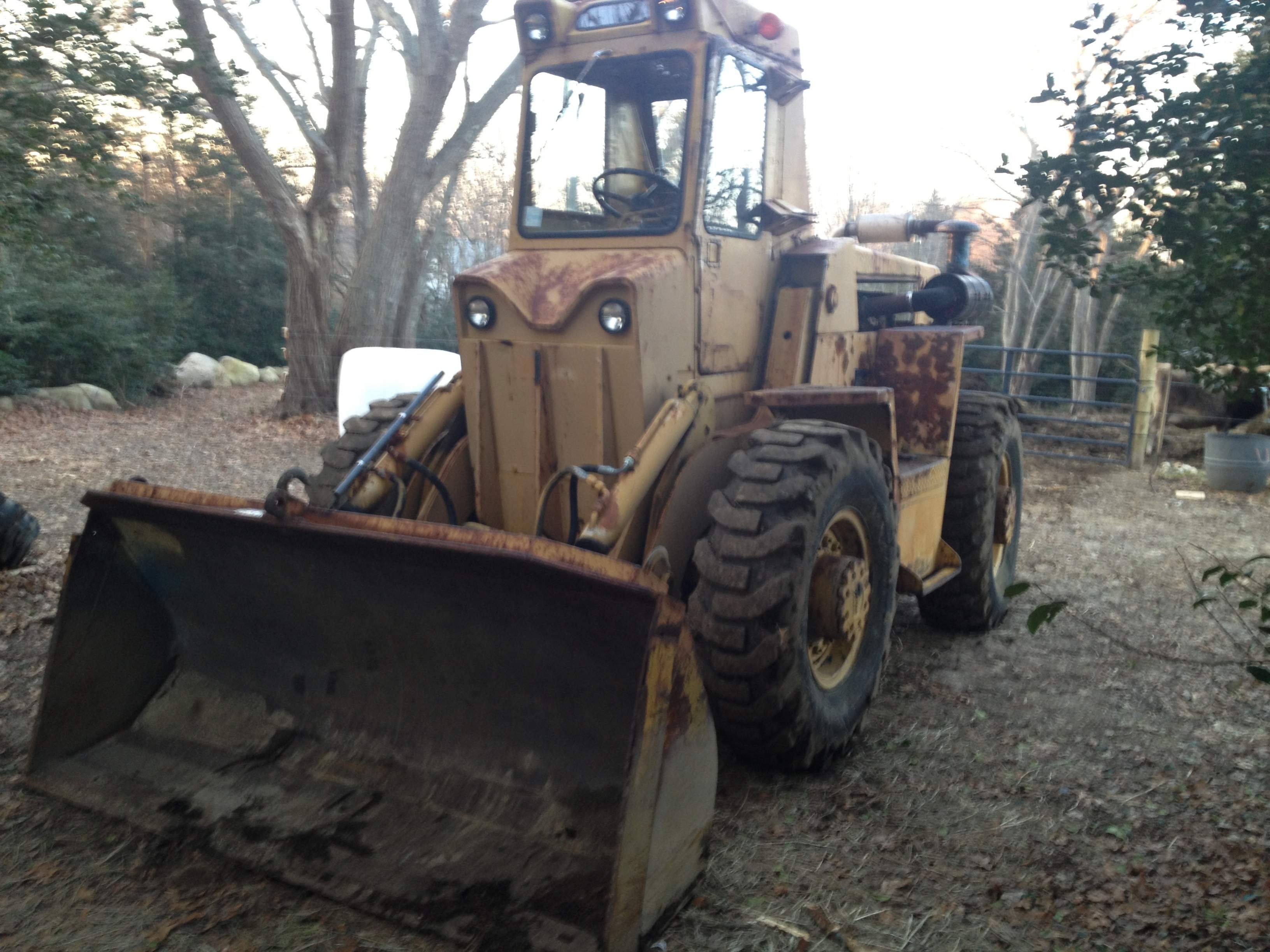

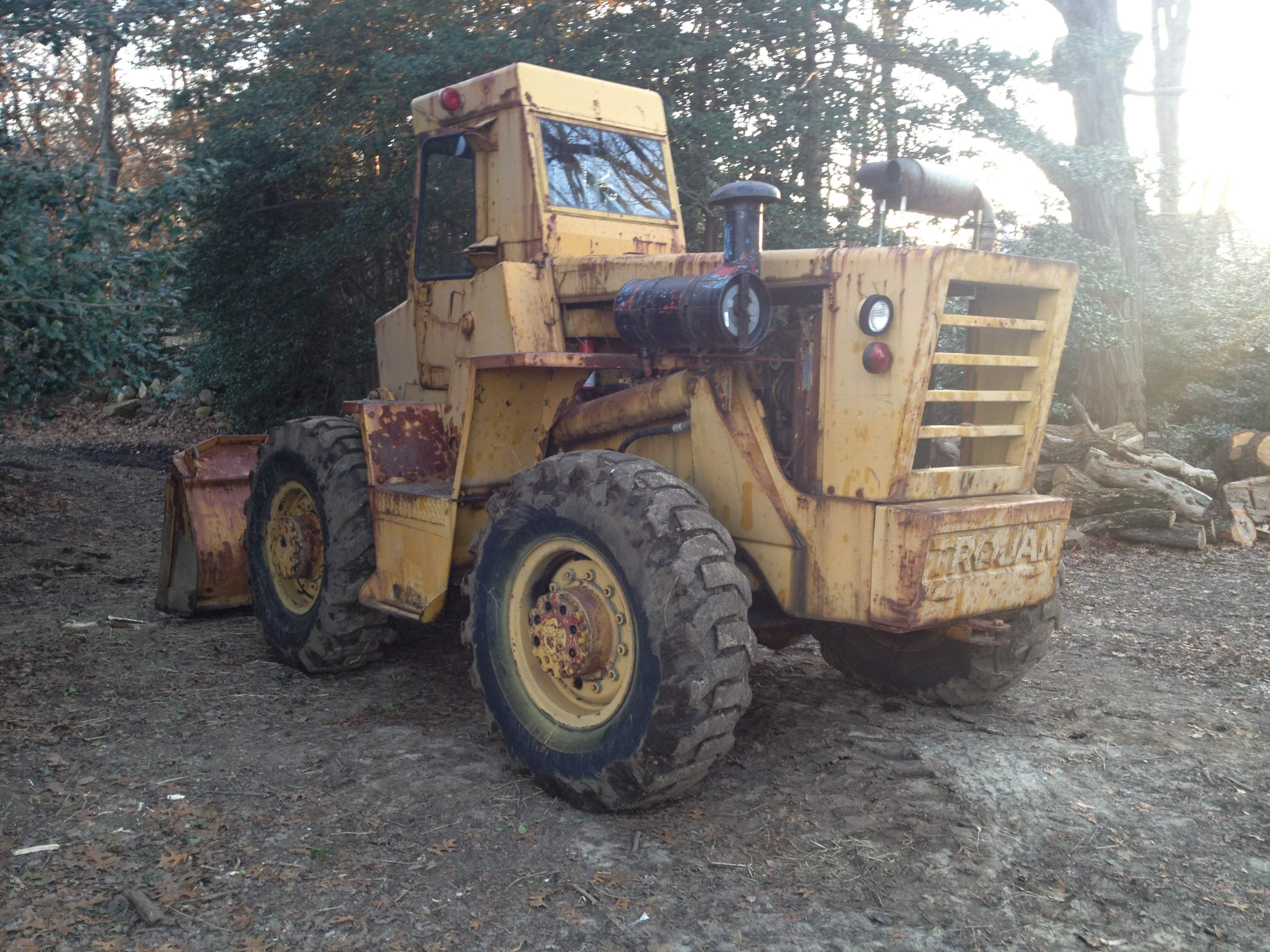

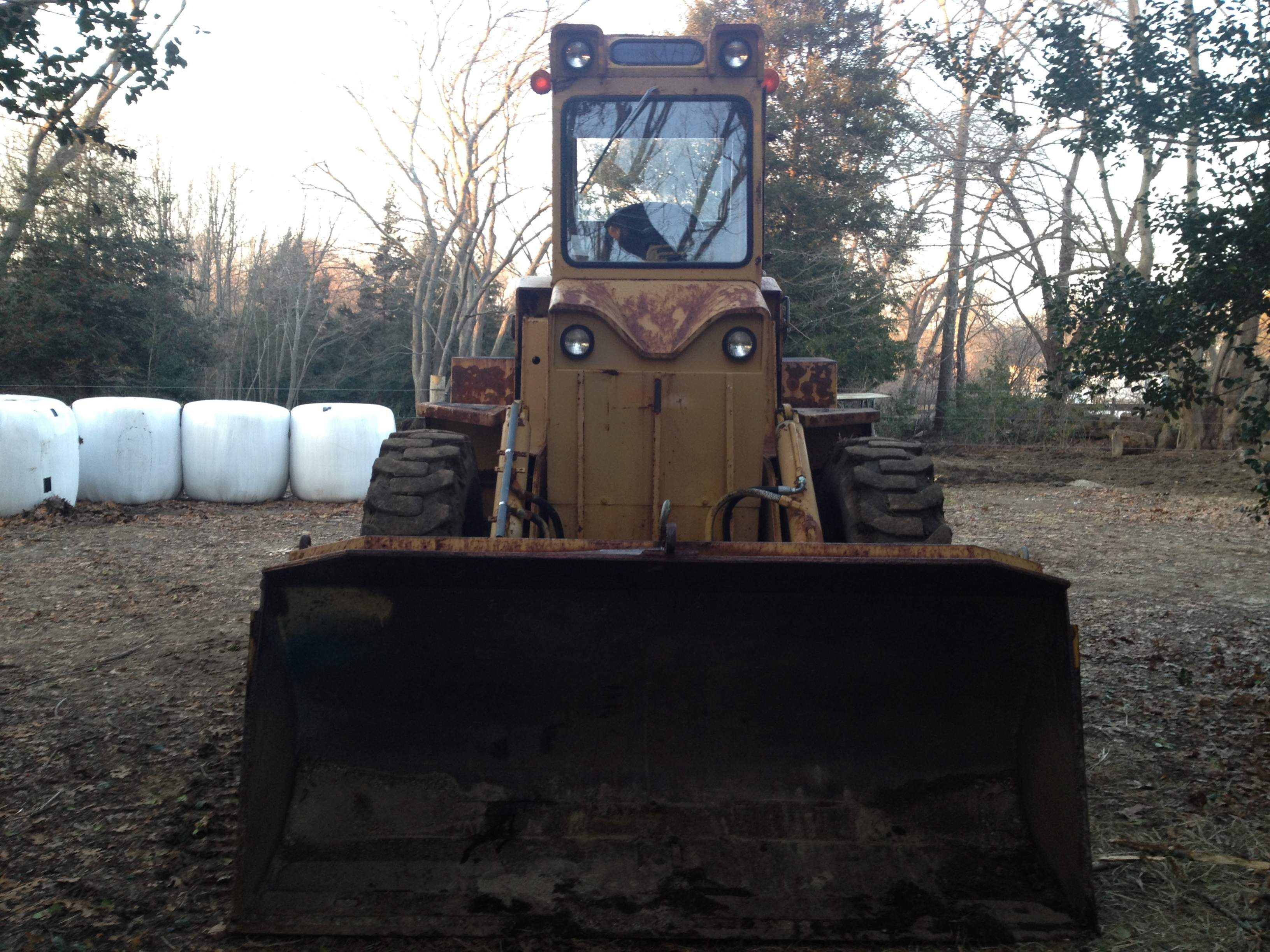

View attachment 355846Thanks for all the input! I ended up draining the fuel tank, I don't think there was too much gas mixed in as it looked like diesel but smelled like gas. I put 15 gals of fresh diesel in with additive and some 2 stroke oil mixed in and it ran fine. I ran it today for about an hour feeding bales and so far I like the old girl, nothing fancy but it gets the job done ive also attached some pics if anyone is interested.View attachment 355844View attachment 355845
Nice! looks like decent rubber too. In my "youth" working my way through school among the machines I ran was a Trojan 102. A bit smaller than yours and a gas job/Allison. Old Straight frame machines were nice and simple but not exactly "nimble". Worst thig about it was moving it from job to job on the road. Hit a certain speed and that rear wheel steer would start to wobble until you brought the speed down.
