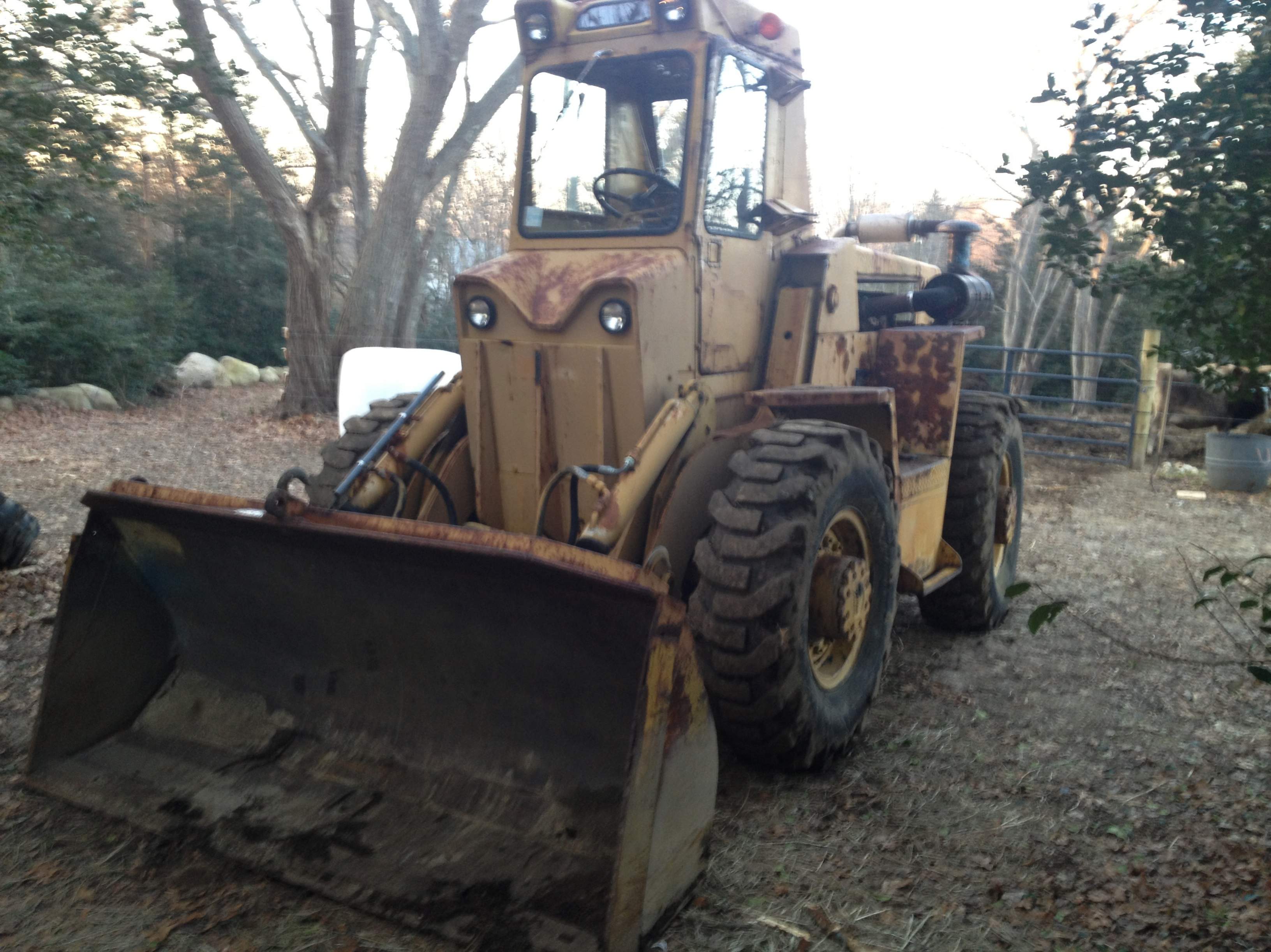

image.jpgThanks for all the input! I ended up draining the fuel tank, I don't think there was too much gas mixed in as it looked like diesel but smelled like gas. I put 15 gals of fresh diesel in with additive and some 2 stroke oil mixed in and it ran fine. I ran it today for about an hour feeding bales and so far I like the old girl, nothing fancy but it gets the job done ive also attached some pics if anyone is interested.image.jpgimage.jpg

Very cool....that should be really handy to have around! My neighbor has a similar wheel loader that he made a set of pallet forks for, and it's amazing what he can lift with it. I've seen him lift a full size 1970s chevy van onto a flatbed with ease. I'd love to know what sort of lift capacity yours has.

GManBart- it's funny that you mentioned forks as that will be my next project for this loader. As far as lift capacity goes I don't know for sure on the 164, I do know that the trojan 114 is around a 5 to 6k lb capacity machine so the 164 is somewhere north of that number. I can tell you that it lifted a 2k lb silage bale like it was nothing though :)
Buickanddeere- this machine has no engine heater whatsoever, but honestly I don't think it would help much this Detroit was rebuilt 50hrs ago and even when I started it today (45 degrees) it still took its fair share of ether.
