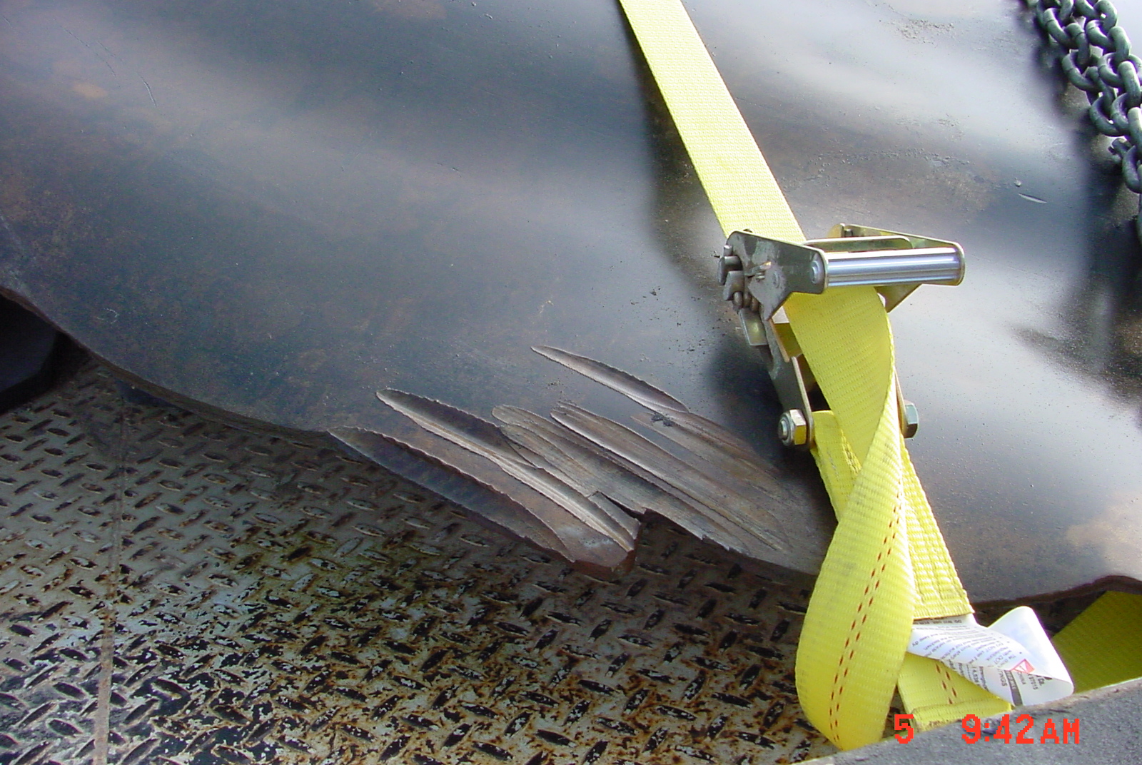

We also have what we call "air patrol". They look for work going on near pipeline, dead spots (when grass is actually green, a leak will show up as a dead spot), encroachments (when someone is building or moving something on top of pipeline), etc.
Here are 3 pics of a section of our pipe (18" steel) that was in the bottom of a creek. A hydra-axe (rubber tired articulated front mounted brush cutter) was clearing ROW (right-of-way) along top of pipeline, dropped off into a dry section of creek bed, rotating blade dug into bottom of creekbed and hit pipe (see marks on pipe), causing it to blow out. It had 600#'s pressure on it at the time. Luckily no fire or explosion.
As a side note, if you are mowing property unfamiliar to you, there are also some pipes sticking out of ground where house meters used to be, but house and slabs are long gone. It can be exciting if you hit one of those with a mower also.
